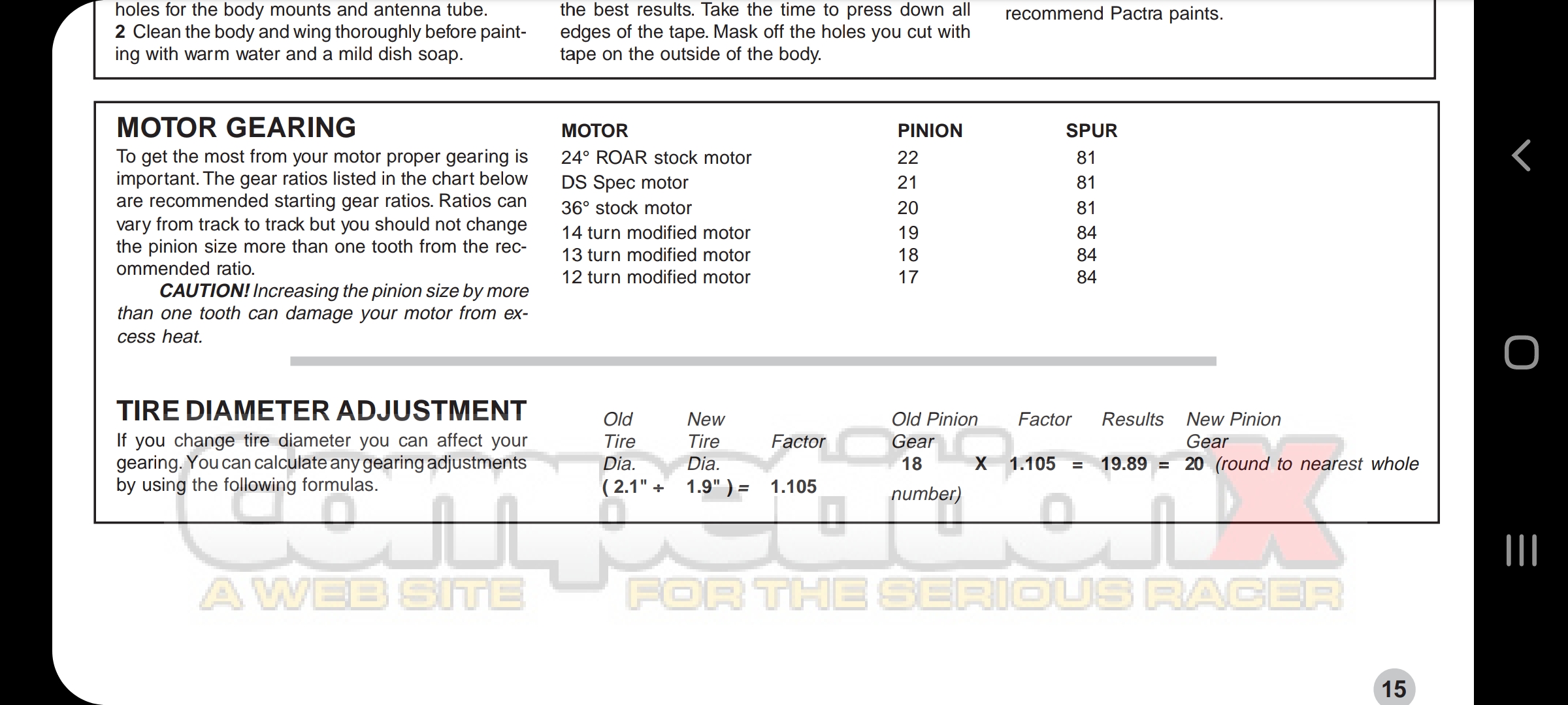

I hope this question doesn't come across as silly, I know all about roll out and tire size to calculate gear ratios, but I'm looking to make a bulk buy on some 64p Spur and Pinions for a 1/10th scale on-road/carpet pan car running OG nicads and nimhs with brushed motors on Oval and Can-am courses. My failing memory seems to recall a range of around 98t thru 112t Spurs and 10t thru 24t Pinions. For a bulk buy do you guys think this range rings a bell from back in the day for these cars....suggestions? Thanks in advance to all for any help.

This is from the RC10L2. It is for 48P but should give you good ballpark ratios for a given motor.
