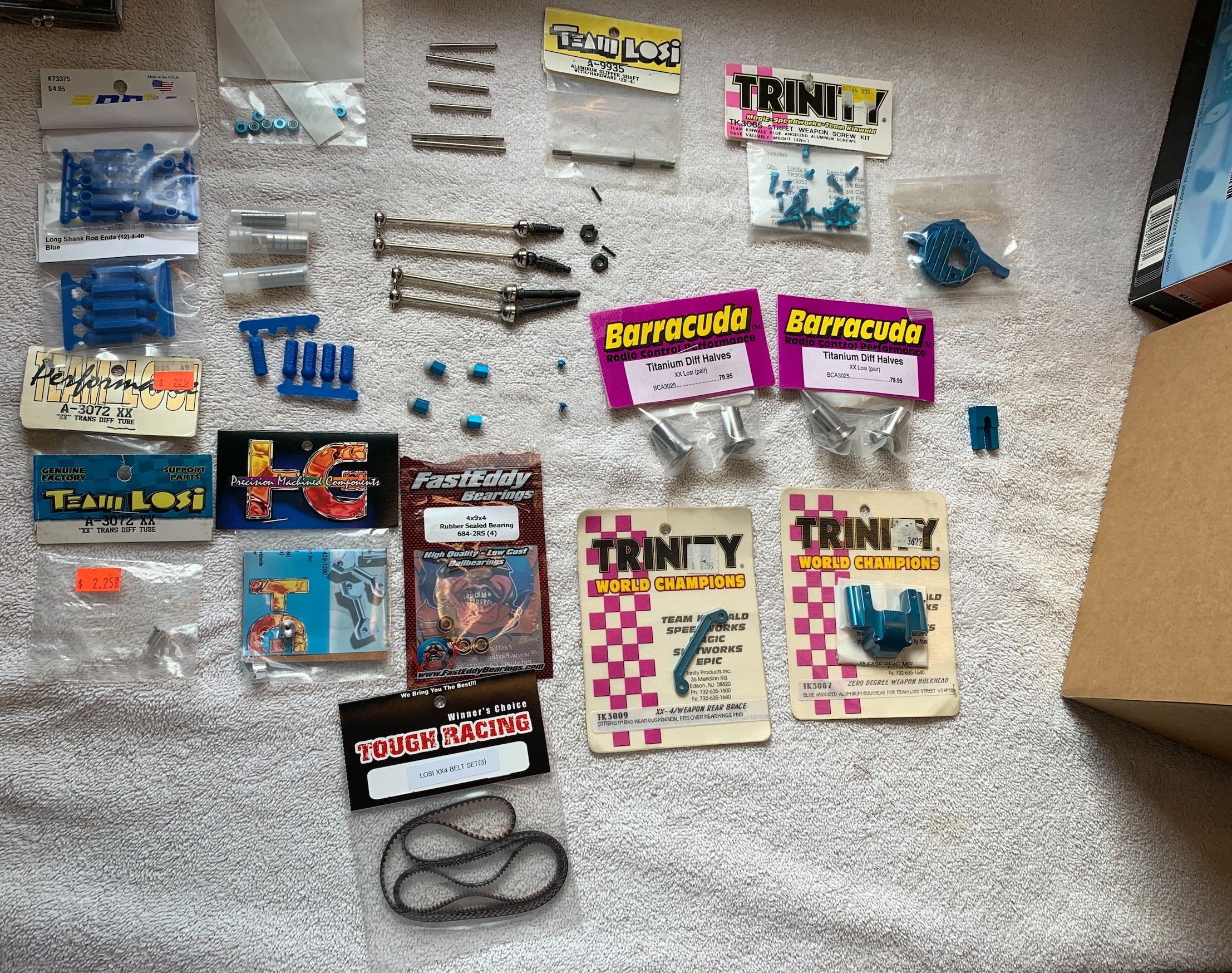

Just started my XX4 build. I acquired this over the summer. I've been collecting XX4 stuff for over a year now. This is one of the Losi cars I never got to see or drive as a kid. Learning lots about the XX4 platform overall.
Parts I've been collecting for this build.

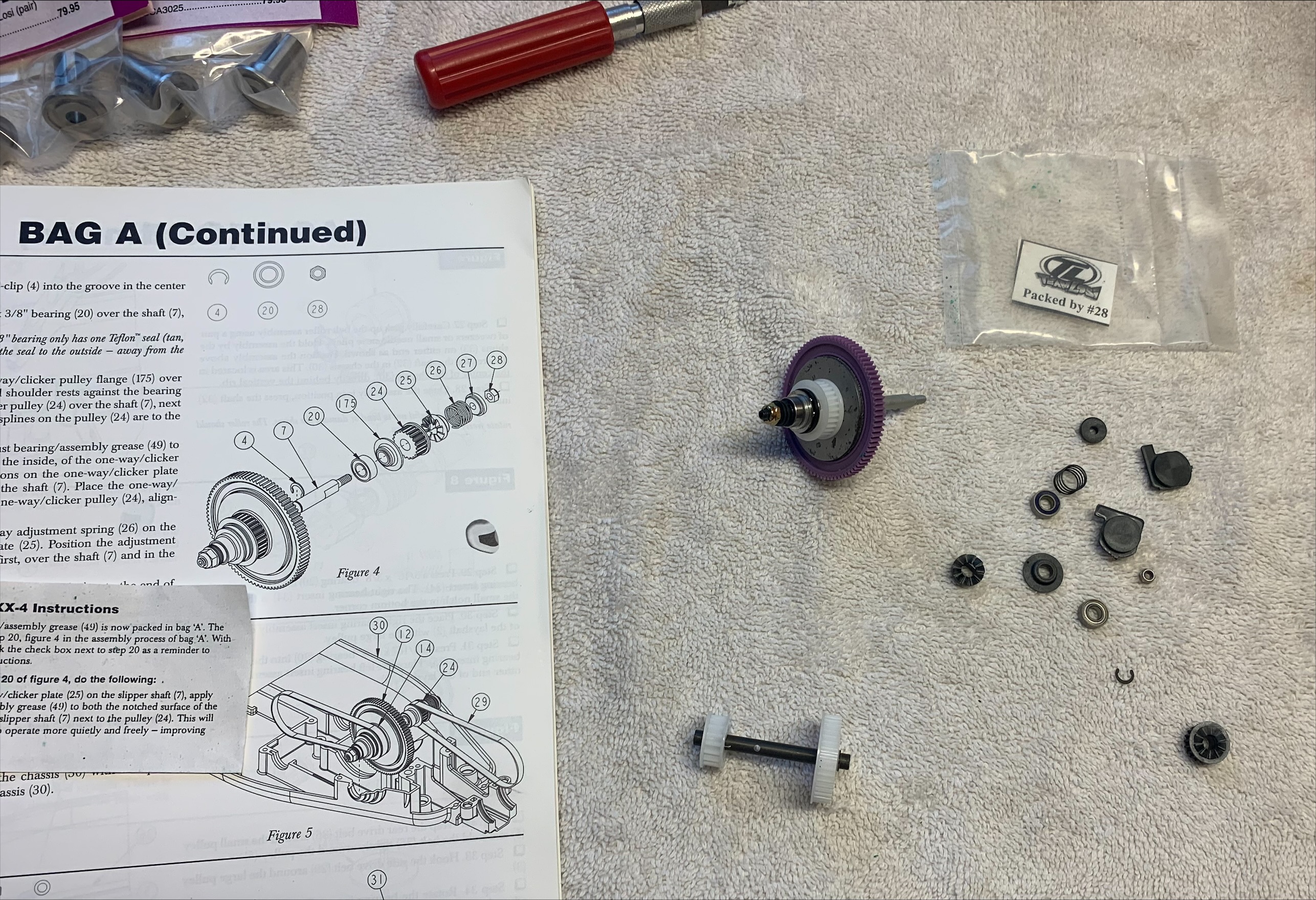

Starting with Bag A, I had to clean the rubber from the belts that melted onto everything else in the bag. Yummy
Aluminum Slipper Shaft and Aluminum Layshaft upgrades.
Assembling the Slipper and Lay shafts.
