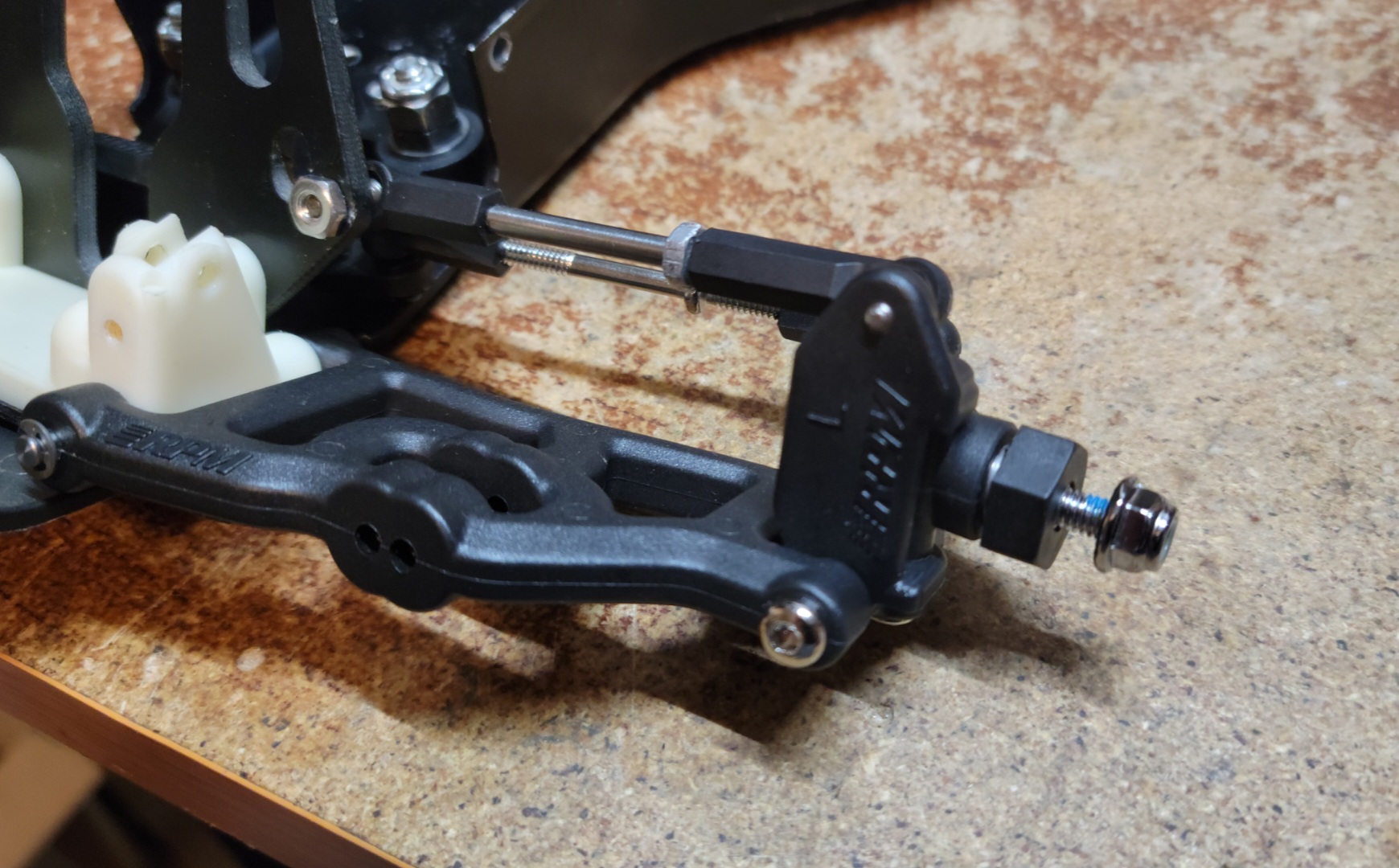

I got the idea of using the RPM Bandit arms from one of Niki's builds but decided to approach the steering differently.

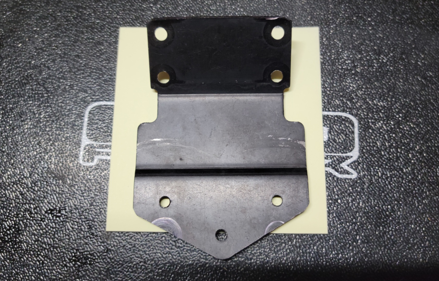

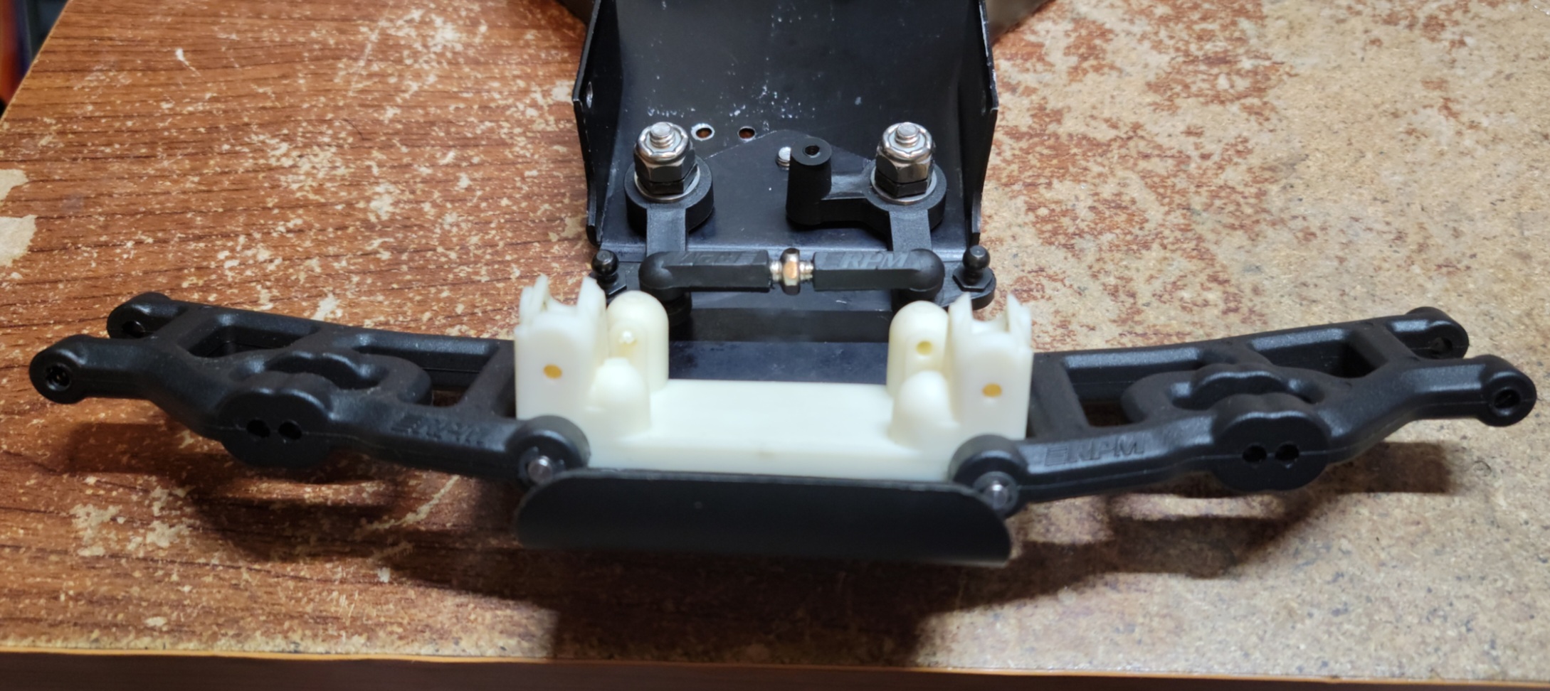

Truck nose plate, cut down and tapped for use on a buggy.

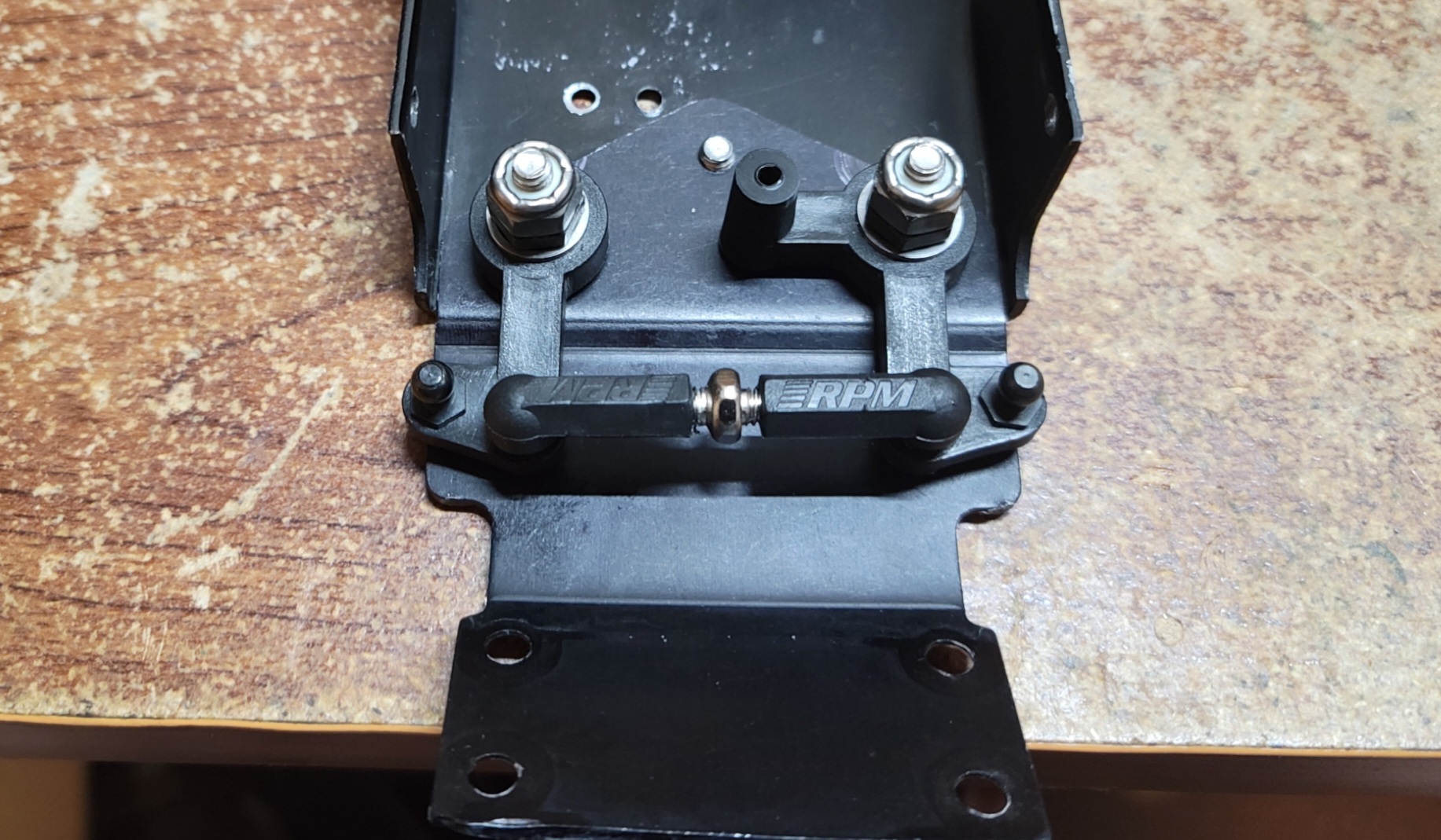

Worlds bellcranks. That little spacer is much easier to align without everything in the way.

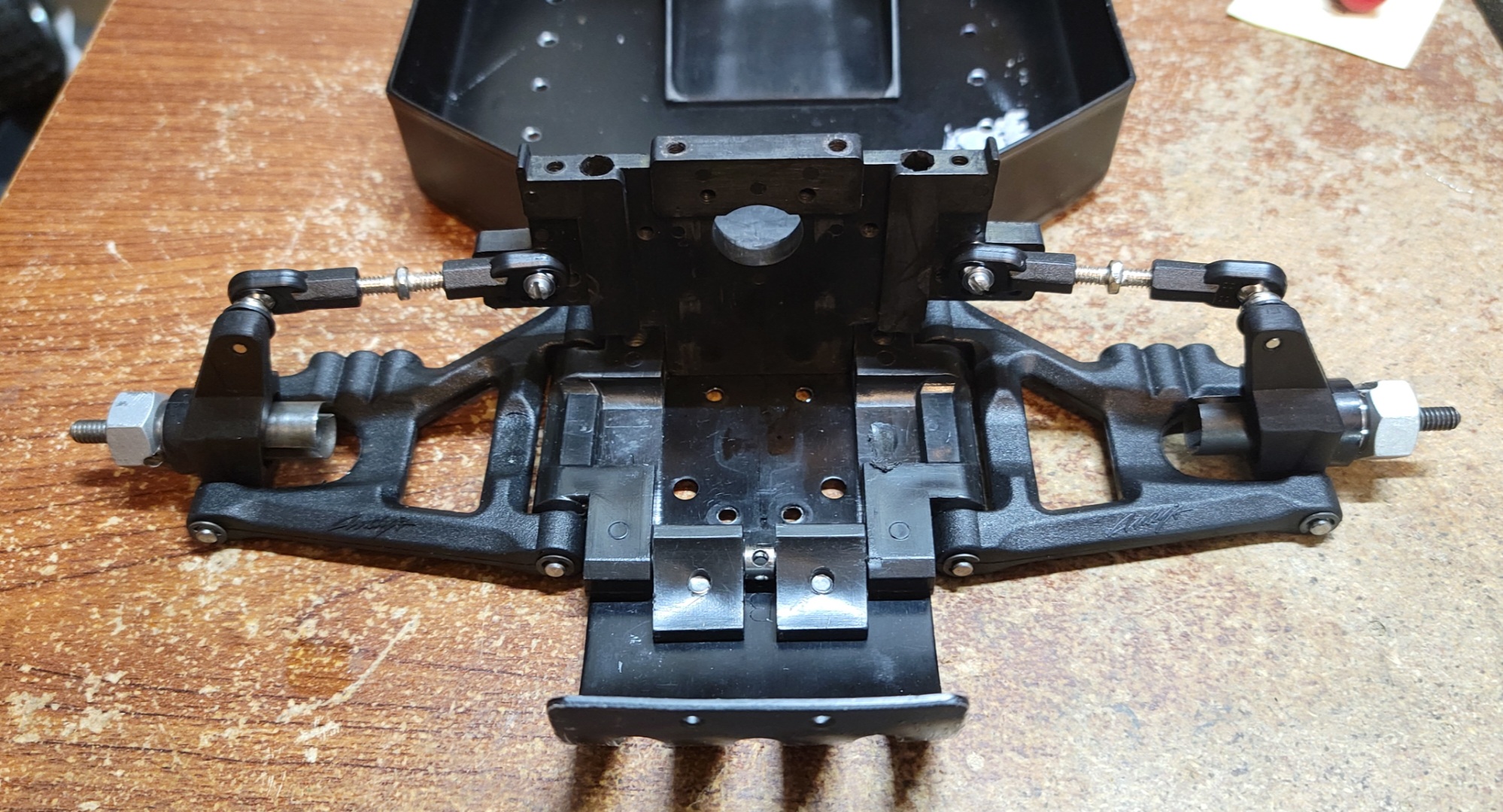

Truck bulkhead and RPM Bandit arms. The Bandit uses 1/8" hinge pins, same as the RC10. I think the inner pins are standard 10T parts, they were in my junk box. I also used a RPM mini bumper.
For the caster and steering blocks, I chose Traxxas parts. I used RPM caster blocks for a Slash and modified them to fit (in hindsight, Bandit parts would drop in). I had the steering blocks and bearings laying around. The hinge pins are Bandit VXL parts, also laying around. The kingpins are from STRC. It uses Bandit axles and 5.5mm hexes.
I chose these parts because they are much narrower than AE parts, keeping the front with within spec (248mm).

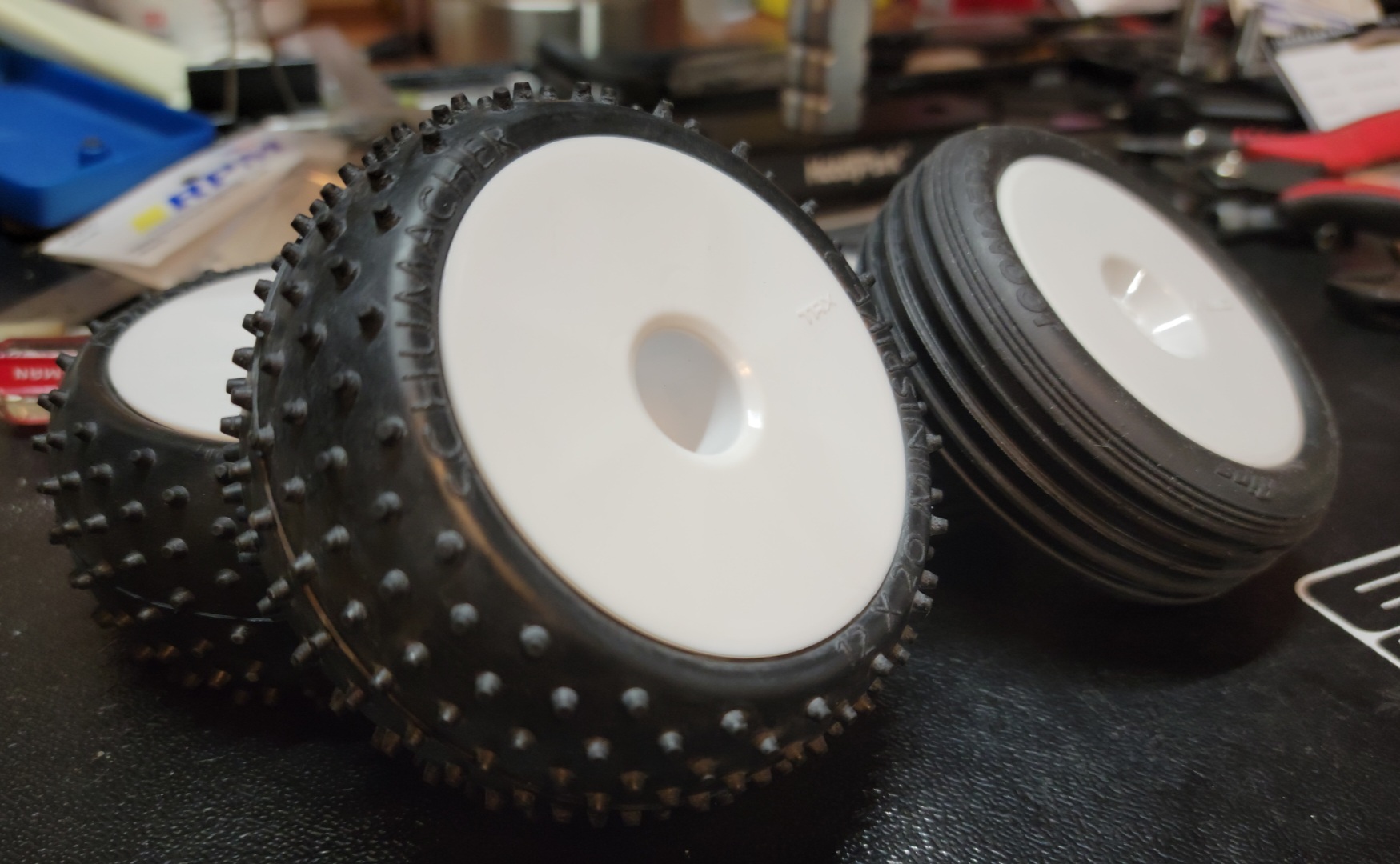

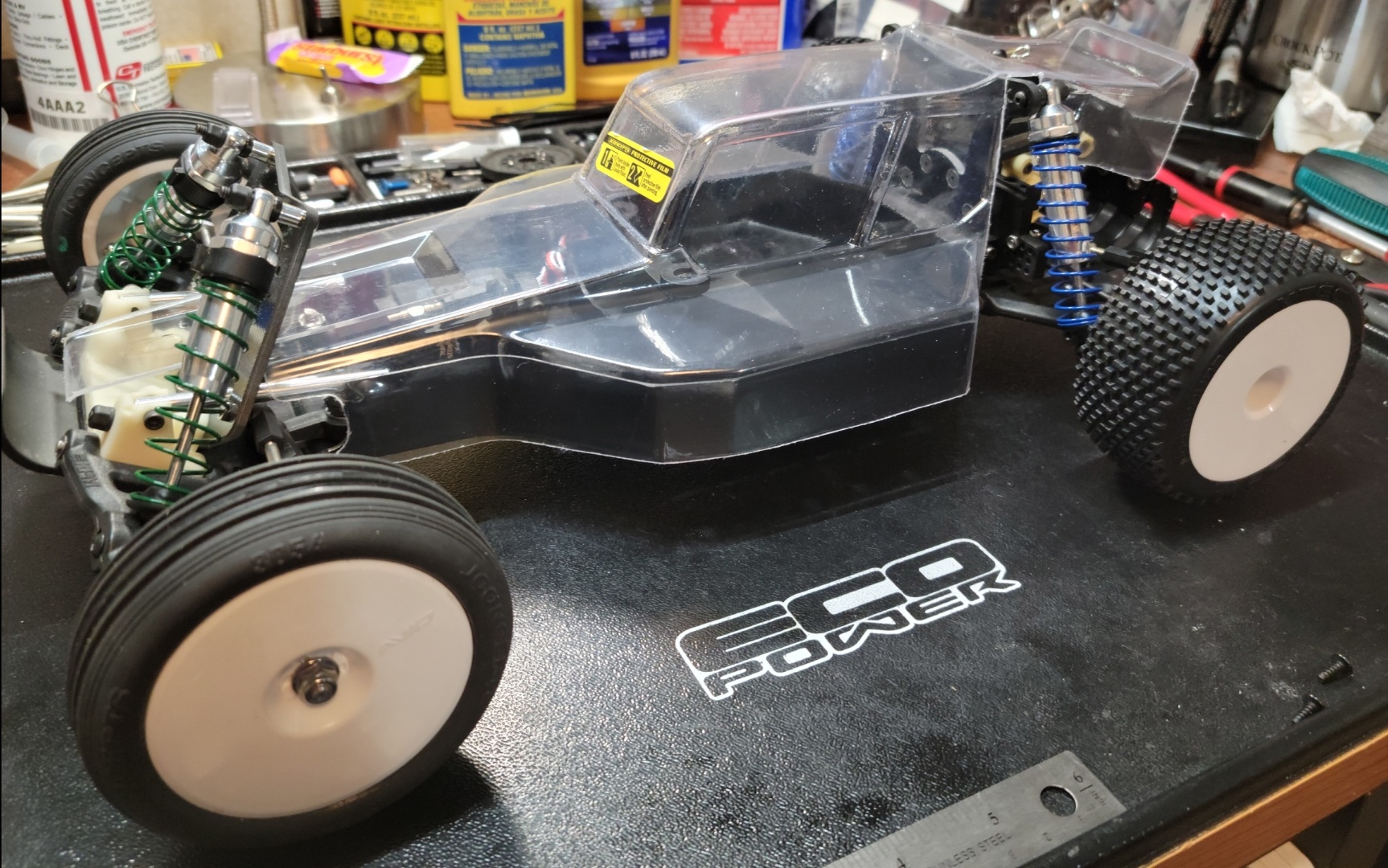

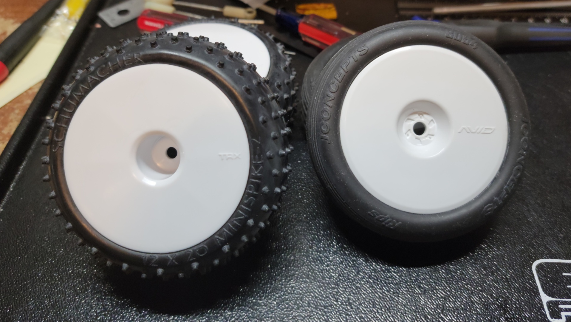

The car uses hex wheels all around. I used Factory Works rear hexes.
The rear wheels are Traxxas 7171's for the 1/16 E-Revo and the Fronts are from Avid (B5 offset). The rear tires are Schumacher Mini Spikes and the fronts are JConcepts Rips.
The wheels clear the arms at full lock, at ride height. Under compression, they do touch at full lock. Narrow wheels would probably cure this.

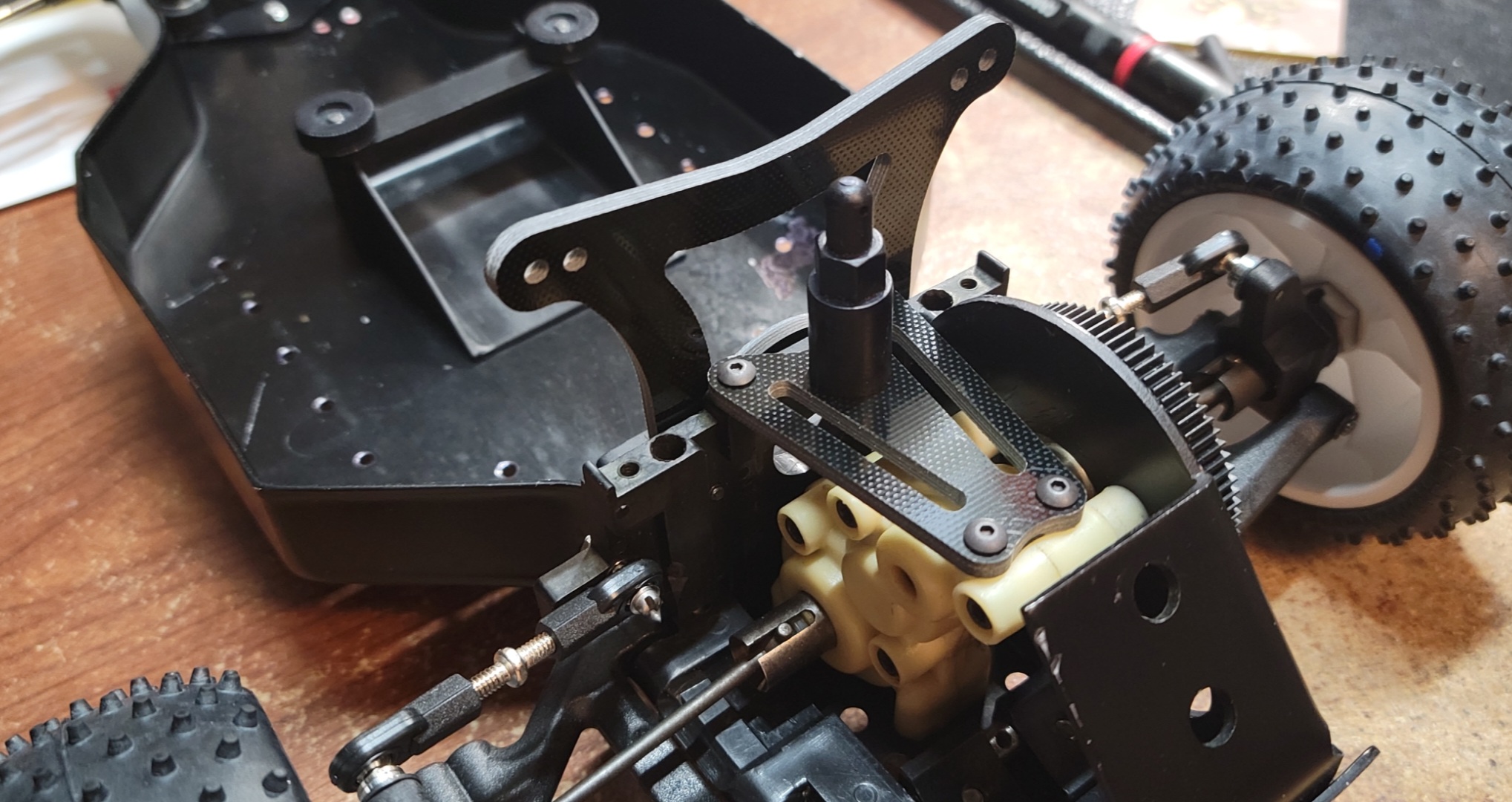

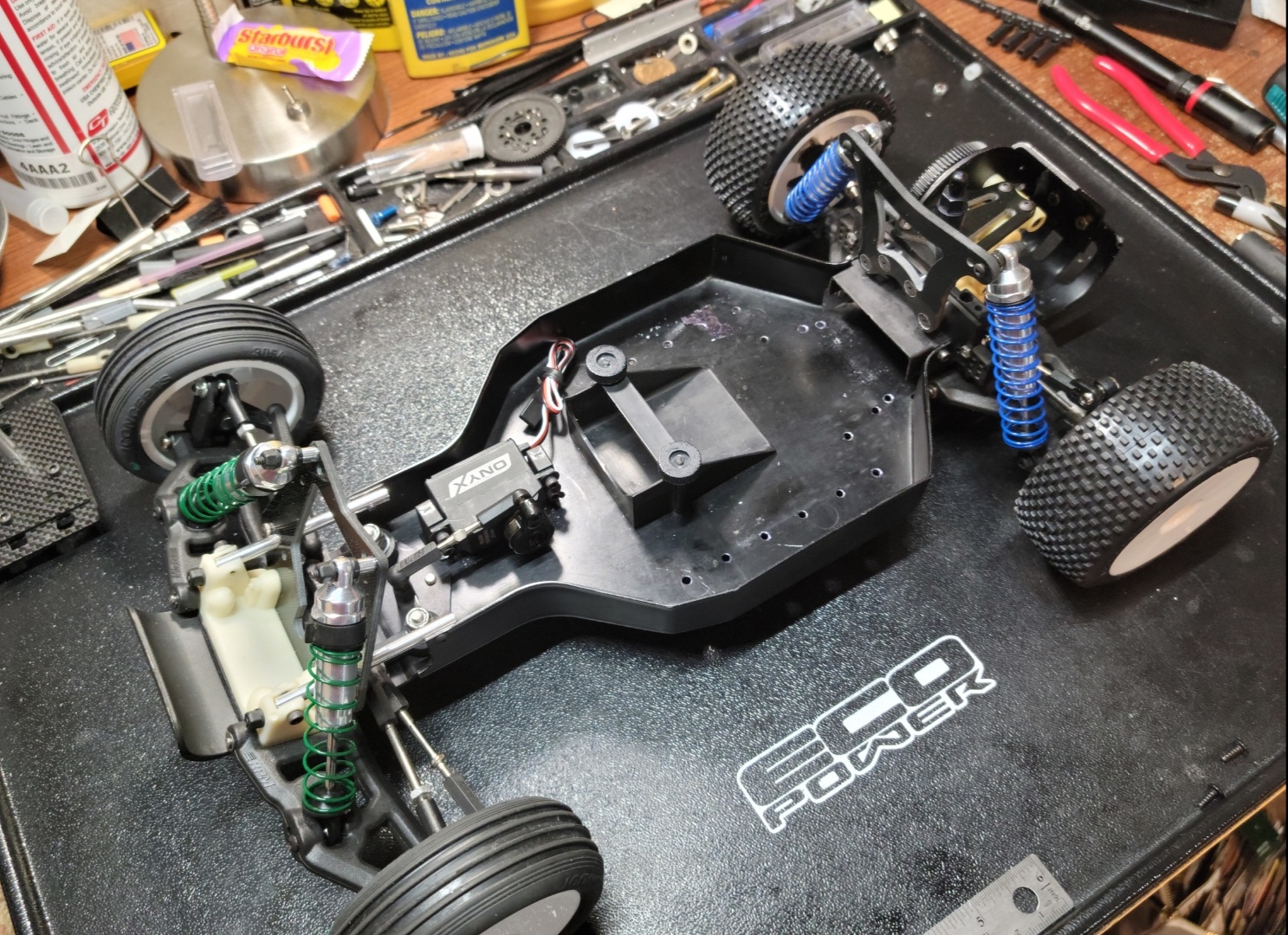

Here it is for now. The transmission is a basic Stealth (no mods). It has a truck shock tower for mock up but I'll get Jeff to make some new ones.

Absolutely. The main parts that I still need are the shock towers and body. I already have most everything else.
I have AE hard anodized shocks for it, 1.32 rear and 1.02 front. They'll have big bore springs are aluminum bleeder caps.
The towers will be from Factory Works. The front will be a RPM Worlds tower and the rear will be the A&L Team tower. I use that rear tower a lot, I like the open design.
Yes, and yes. They are also from Factory Works.

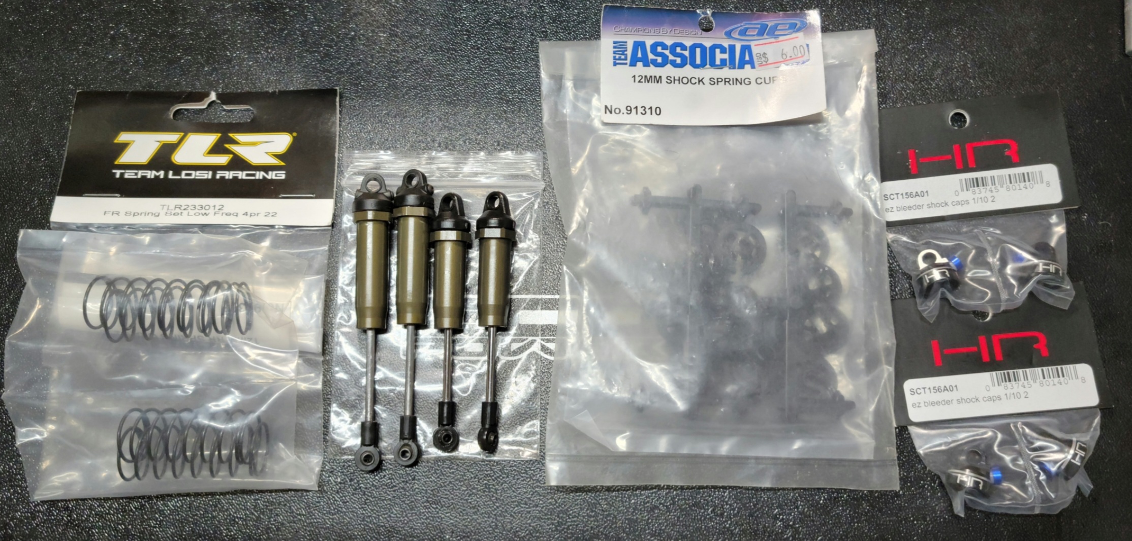

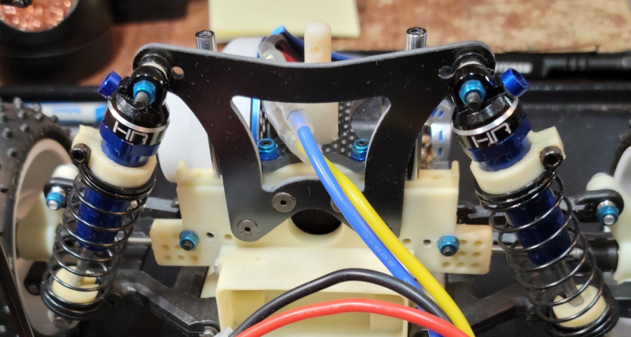

Here are the shocks and most of the parts. I still need rear springs and upper adapters. The blue will also be stripped from the bleeder caps.
These are the same type towers, as seen on other cars of mine.

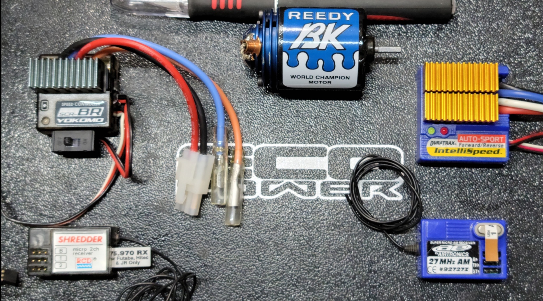

This is the motor that I plan on using. I'm still undecided on which esc and receiver to put in it. The blue matches the motor and adds some color to the car. However, the Yokomo and Hitec Shredder are just plain cool.

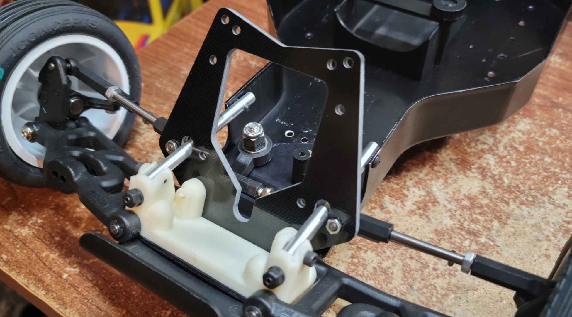

Not too much going on here (working on five different projects, along with misc. stuff). But I did get some new Factory Works towers and transmission brace, as well as making new nose tubes.
I really like the A&L rear tower (I have five!). The open design looks good and makes passing wires through easy.

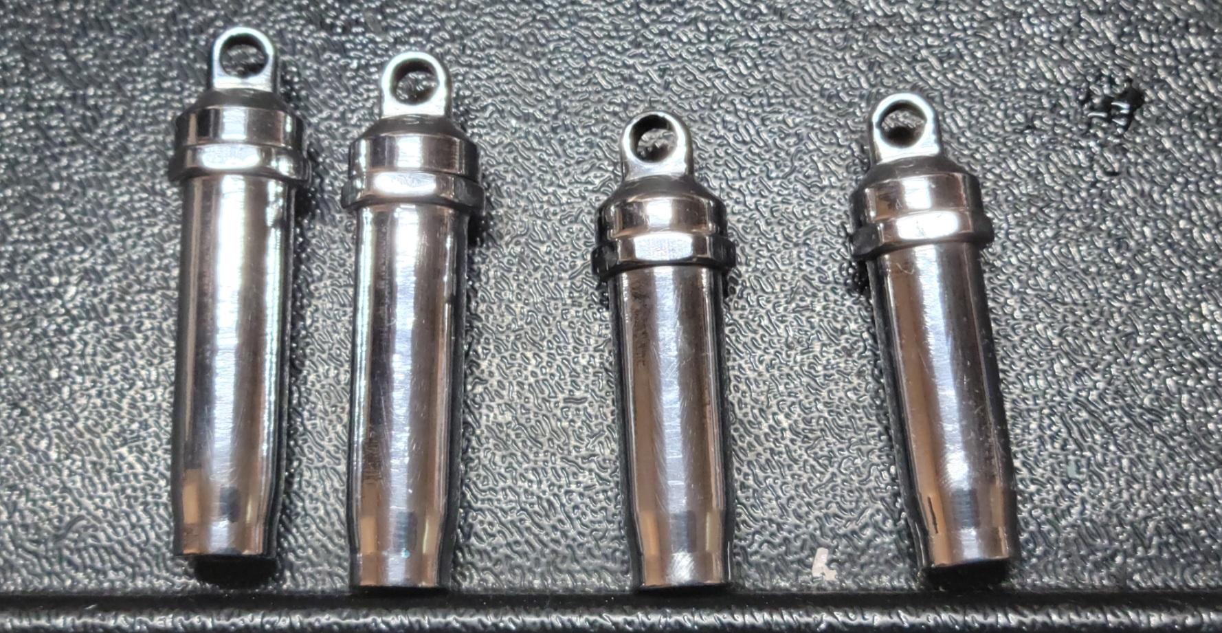

I was looking through my shock parts box and seen some shocks and caps that were in poor looking condition. So I decided to have a try at stripping and polishing them.
They should look good with black plastics and big bore springs.

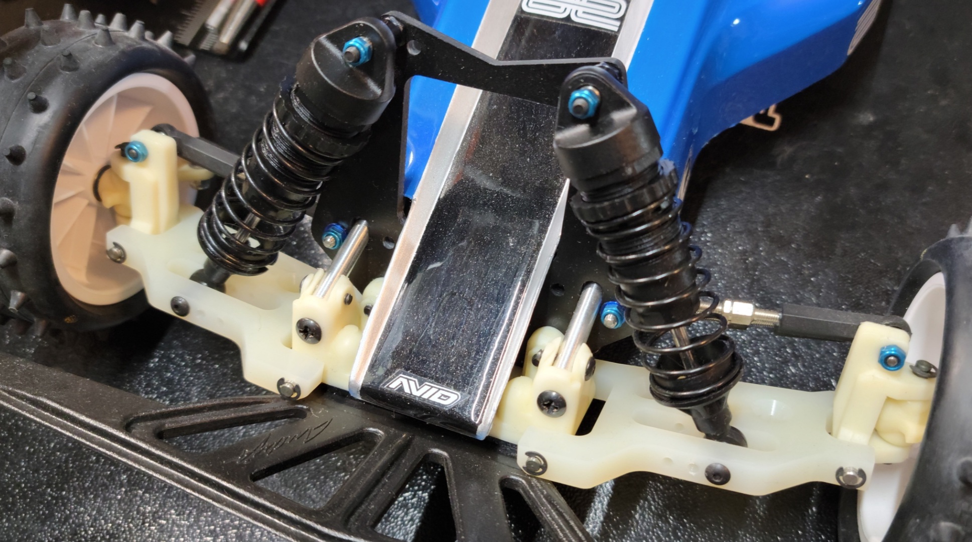

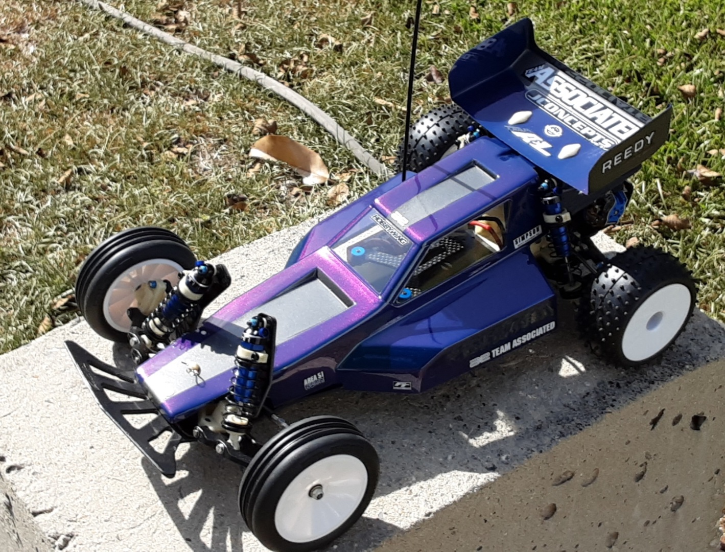

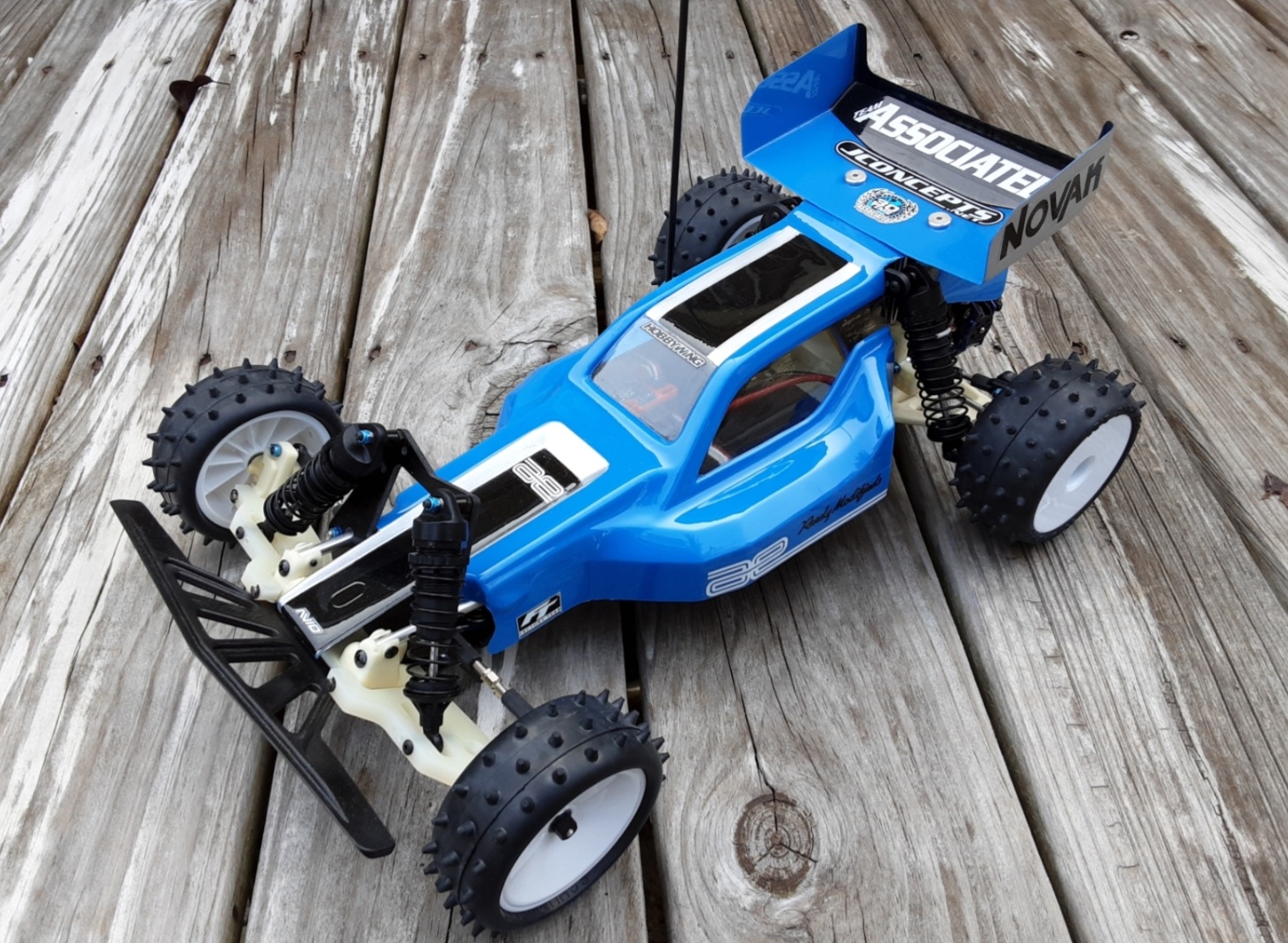

Got a little bit done on this one.
Got the shocks built and mounted. These springs are just placeholders. I have the big bore springs and cups, just need the upper locators.
The Robinson Racing Tracker rear mount uses the long wheelbase holes. Instead of using spacers on the shocks to reduce the angle, I decided to reverse mount them instead.
Also swapped the rear tires for some LRP Kamikaze 10s.
Got the body trimmed as well.
I chose the JConcepts Detonator for a few reasons:
- The lines of the Detonator bodies trims nicely with the RPM Worlds front tower.
- I already have two cars with the Detonator Worlds body, this one would be a little different.
- The mix of vintage and current styles seems perfect for this car.
