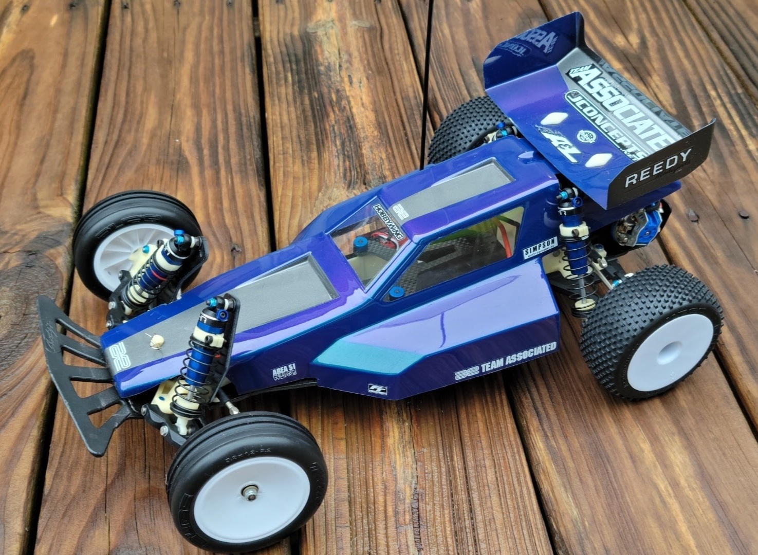

I have a vintage rc10 gold pan with the 1/4 rear axles, is there any rims that will fit this? I've bought some from j concepts but they rub on the shock, there to deep.
https://www.towerhobbies.com/product/rear-wheels-and-tires-mounted-rb10-rtr/ASC72019.html?gclid=CjwKCAjww8mWBhABEiwAl6-2Rfhd9tWlo0nGmxlkxay0HhCeriVuLadEgychJXOom2fmGmqvqGZxCxoCGNsQAvD_BwE
I was looking at these not sure if they would fit, or rub on the shock like the other ones.

JC Racing makes some that are direct fit, for 2.2 tires. If you get the narrow version, they will require a slim front tire.
JConcepts makes some 1.7/1.9 wheels and tires that fit well.
A Traxxas 7171 wheel can be used on the rear with Factory Works hexes adapters. You can then use the JConcepts B2 front wheels.
I have some of each. The JC Racing 5 spoke is probably the best looking (to me).

Re: vintage rc10 gold pan
https://www.amainhobbies.com/traxxas-premounted-response-pro-2.2-tires-s1-soft-2-tra7175/p172191
So these would direct mount to the rear?
With 12mm hex adapters. There are some cheap, 3D printed ones on Ebay but Factory Works sells some nice aluminum ones.michiganionia wrote: ↑Sun Jul 17, 2022 3:51 pm https://www.amainhobbies.com/traxxas-premounted-response-pro-2.2-tires-s1-soft-2-tra7175/p172191
These are those wheels, except with LRP tires. JConcepts B2 fronts.
