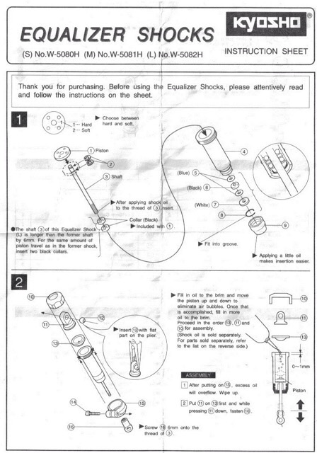

I also added a photo of the instructions and the Option House package with an ”H” at the end of the part number; W5082H and W5081H show non-threaded Equalizer shock bodies. The W5082 and W5081 Option House Equalizer shocks are threaded.
Were these available as both threaded and unthreaded? If so, what kit did they come with?

Those do looks like Kyosho shocks.
Equaliser shocks are a bit of a disaster to identify properly because Kyosho produced variants of these shocks under the same part numbers. So it would completely depend on when they were bought. The "H" denotes hard anodized shock bodies, AFAIK, and they also exist with threaded bodies.
For the shock caps, these might have been replaced by the original owner. Black round caps might have been available from Kyosho separately, as their plastic bodied sports shocks (which also come in multiple variations depending on the period they were released in, with no change in part number) use round caps. I've never tested whether those caps fit on the alloy shock bodies, but wouldn't be surprised if they did, since the sports shocks use the same spring diameter as the equalizers, golds, etc.
