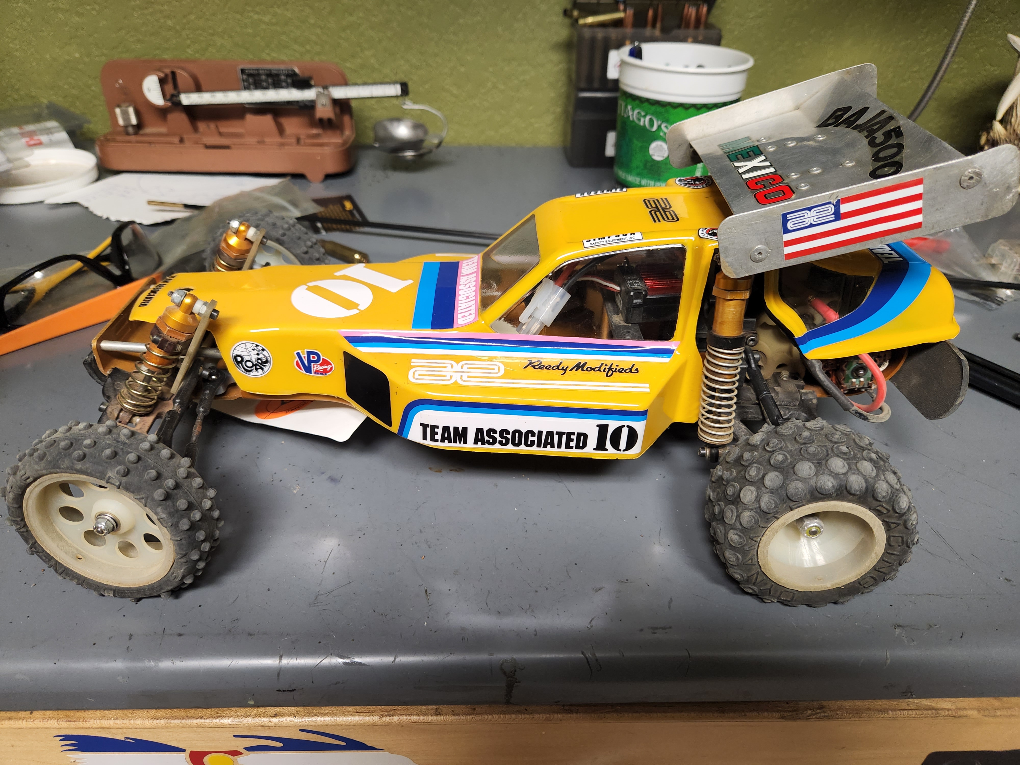

I picked up this gold pan earlier in the year. I got some old school proline wheels with it and the tires are wearing out quickly. I need to find a commonly available tire/wheel combo for dirt. Which wheels/tires do you all run for playing around?

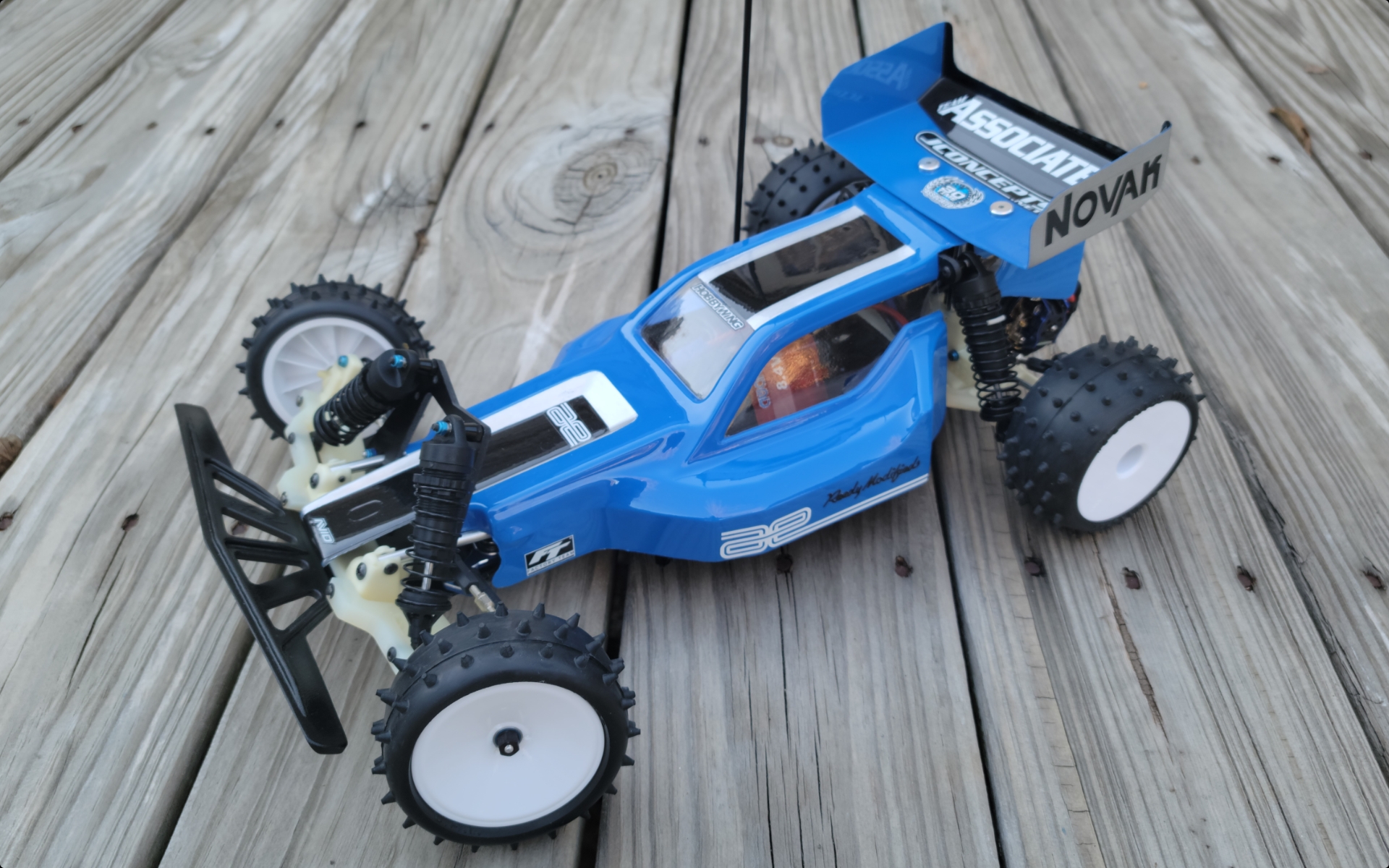

These are JC Racing wheels, with modern 2.2 tires. With a wide arm car, they look correct. Just be careful to note whether the fronts are narrow or wide. The narrow looks right but tire selection is limited.

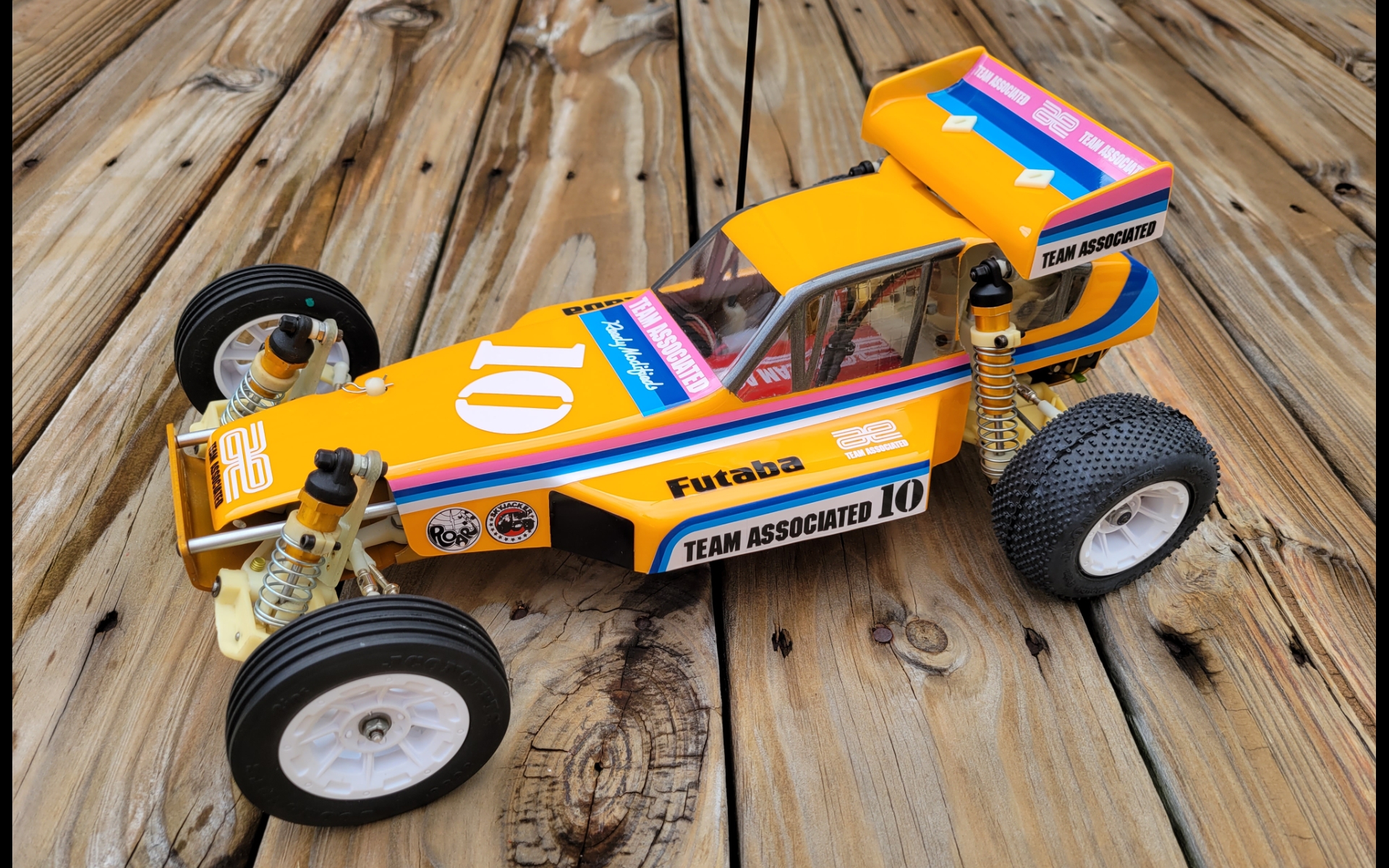

These are JConcepts RC10 wheels and tires. They are 1.7 rear and 1.9 front. IMHO, they look better on a short arm car.

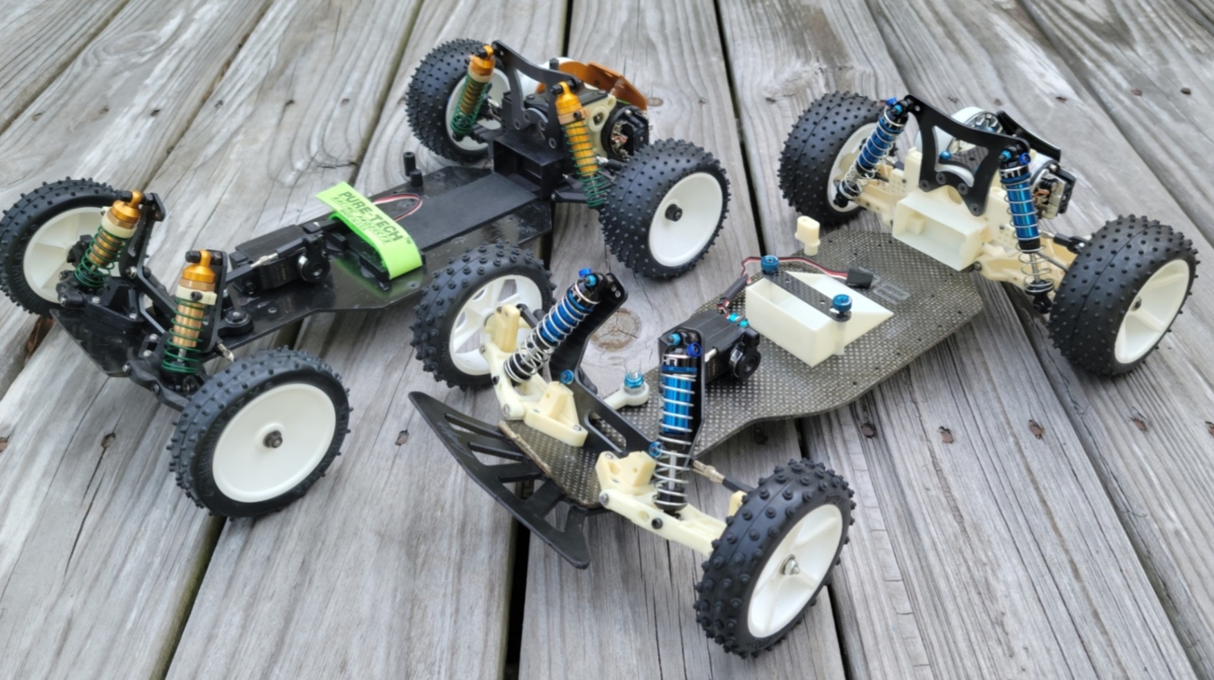

These are JConcepts B2 fronts and Traxxas 1/16 E-Revo rears (with Factory Works hexes) and modern 2.2 tires. Alternatively, you can use the B2 rear wheels if you convert the rear axles to 3/16.
