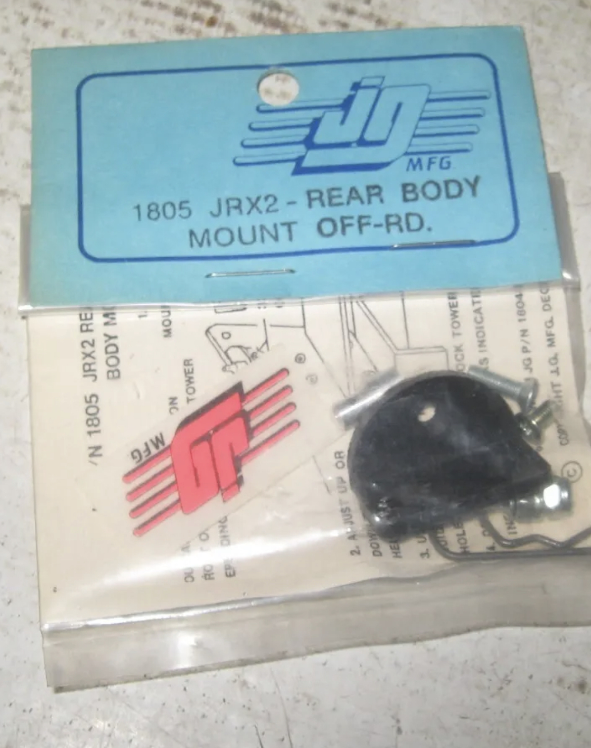

Re: JRXT retrofit trans and rear body mount for truck?
I did find this looking around.. wish that sticker wasn’t in the way of the instructions pic hahaha
probably very easy to make a duplicate via 3d printer… might make something like this..
- Posts: 731
- Location: Ill-Noise, USA
- Has thanked: 1153 times
- Been thanked: 624 times
I have that kit.. It’s just a small piece of bent Kydex and some hardware.
