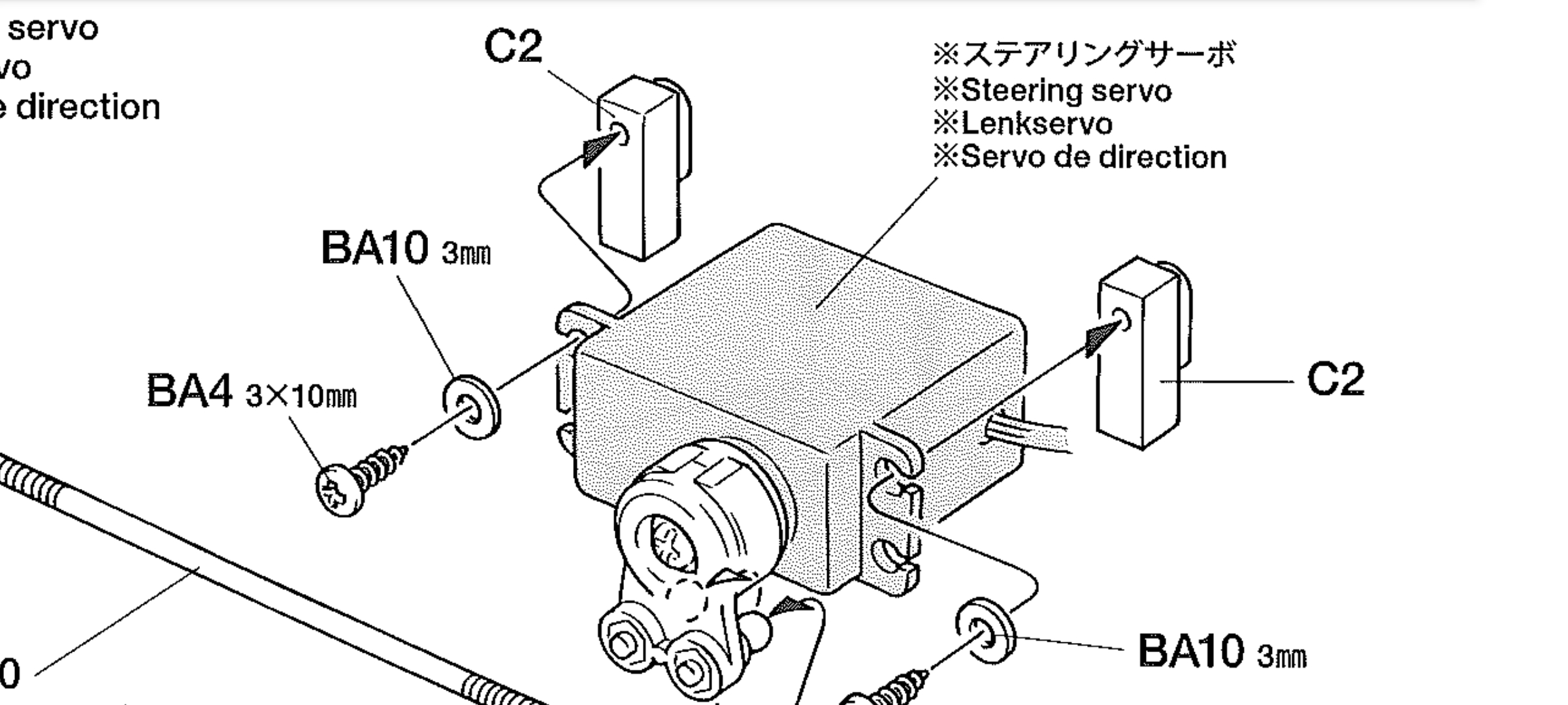

Got the servo and Tamiya HD servo saver in.
The Tamiya HD servo saver sticks out a bit further than the stock servo horn.
Was hitting the front bulkhead with the HD servo saver, on the top left.
Trimmed the support on the top left.
Chassis completed except for shocks, and electronics.

Re: Tamiya Blitzer Beetle - 2011 Reissue
That servo must have a lot of top offset.
I have five Blitzers with that servo saver and all of them cleared.
Posts: 3445
Has thanked: 265 times
Been thanked: 2032 times
I see the problem. Your servo posts are backwards.
Post by GreenBar0n »
I see it now, thanks for that!
Got the servo mounts turned the right direction now, glad it didn't require a lot of disassembly.
