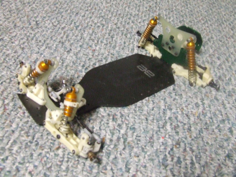

This is My RC10. I am rebuilding it from my dad's one and only rc10 (original 1984 kit) and one of of ebay i got for about $60 (graphite tub-1989 kit). I have been playing around with my dad's since i was 11 and im 17 now. I was a nube back then and thought it would look cool to paint the nylon white parts all black, not knowing the consequences. Luckily, the one off of ebay had a perfect transmission, and all the white parts intact, in perfect condition. I have cleaned everything off, and mounted the basics: (see attachment sta2.jpg)

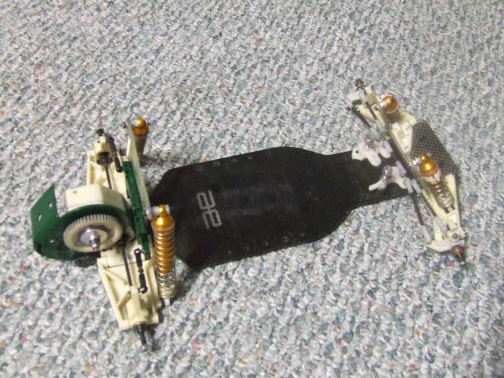

Then from there (4 hours of intense labor later)(see attachment sta4.jpg)
I use an oil pen from radioshack and i highly recommend it for oiling ball and socket joints, and other places where metal comes in contact with anything else, it is silicon oil btw.

Well, im keeping you updated- heres more pics. As you can tell from the second pic, the rear clear shock tower came out great, sanded it down, sprayed it with clear coat, its so shiny, thats the first thing my friend said when he saw it on my desk, without knowing id redone it. The front right bearings seem to be damaged, gonna have to order them off of tower, or get them from my awesome hobbie shop. The rims are soaking in power steering, cause i dont have any break fluid, my dad an mcgyver both said they are the same almost. Well they are not, or i have a tough paint, it isnt working, and when i get some remover fluid, i will soak them in that. I recomend a special paint remover. Go to your at home chemical closet- spray and sniff some spray paint. Go to your local hardware store and sniff the paint remover. If it smells like the paint, buy it. That means the enzymes are the same and it will break down the paint. Should be about $7 for a quart in a tin container. I ordered the messed up tranny gears off of tower for my second car, which i wont start rebuilding for another week, cause i need to get a chunk of aluminum from my gramps to remake the skid plate.
