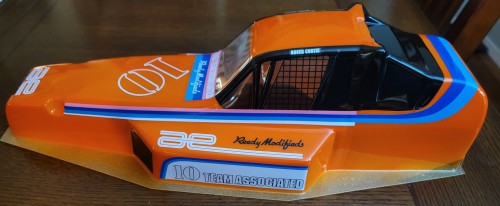

Prep:
Result:
Should've paid more attention to the masking lines. Going to have to spray some PS-5 in a small dish, and use a brush to fix those shabby lines.

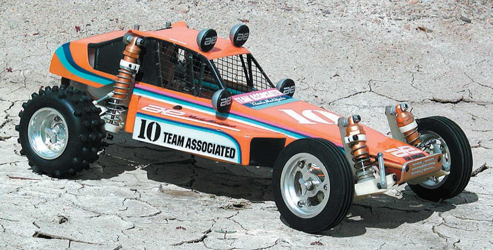

Found out why the RC10 Classic Clear decals are not the same as the 40th decals, or the 1984 boxart.
The large 10 on the hood, and the 10 Team Associated decals on the sides, are hollow, not solid colors.
On the next body, the one with the painted on stripes, PS-62 Pure Orange will be used instead of PS-19 Camel Yellow, along with the solid color 40th decals.
Actual 1984 RC10 boxart body - missing wing, with later issue wheels.
