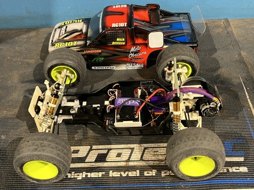

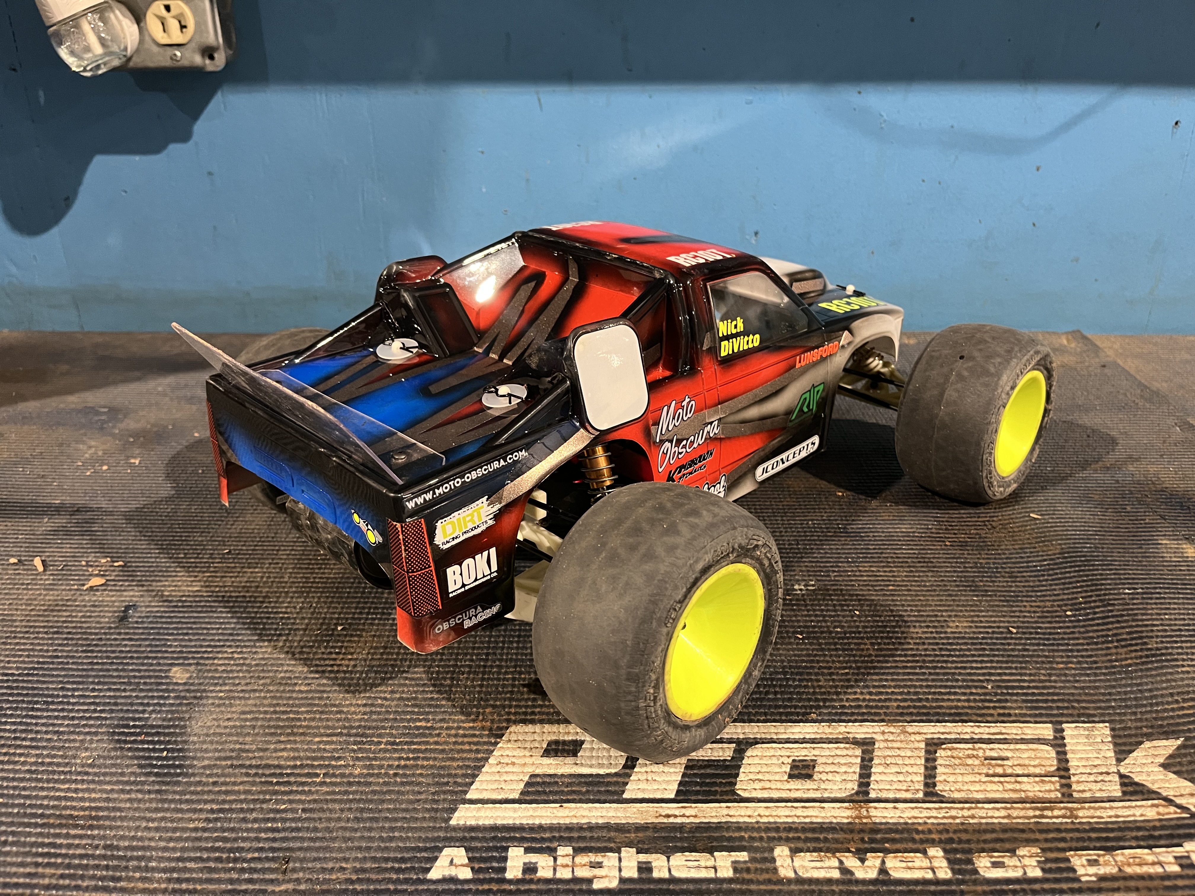

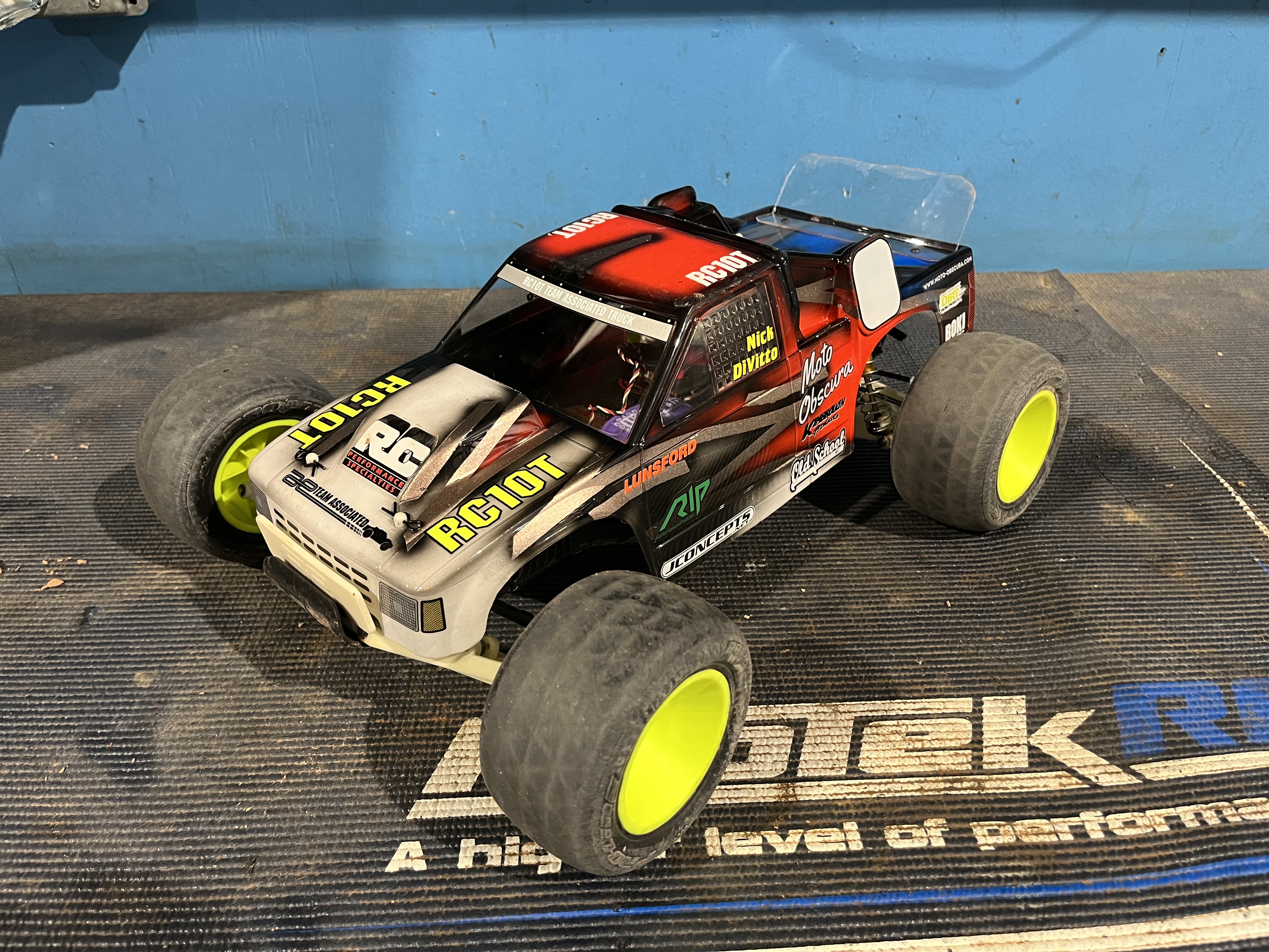

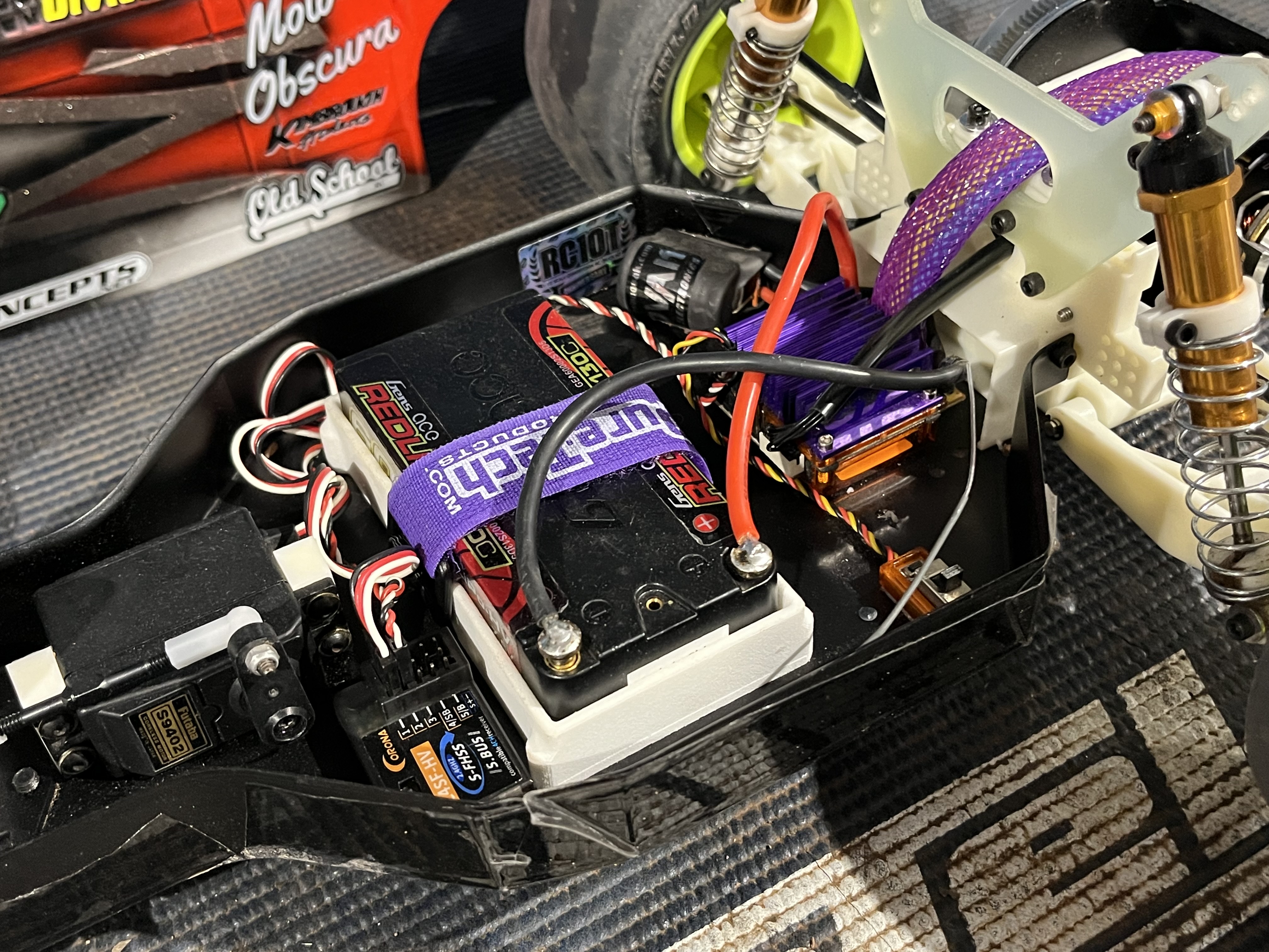

Did some testing and tuning the other day at World of RC with the RC10T Classic. I didn’t break any “real” parts, only two of the stock ballcups. Honestly if you’re going to run this truck it isn’t even worth it to take the stock ball cups out of the bag. They’re brittle, grip the turnbuckle far too tightly, and pop off the ball if you look at them funny. I’ll be throwing a set of RPM ballcups on for next time.

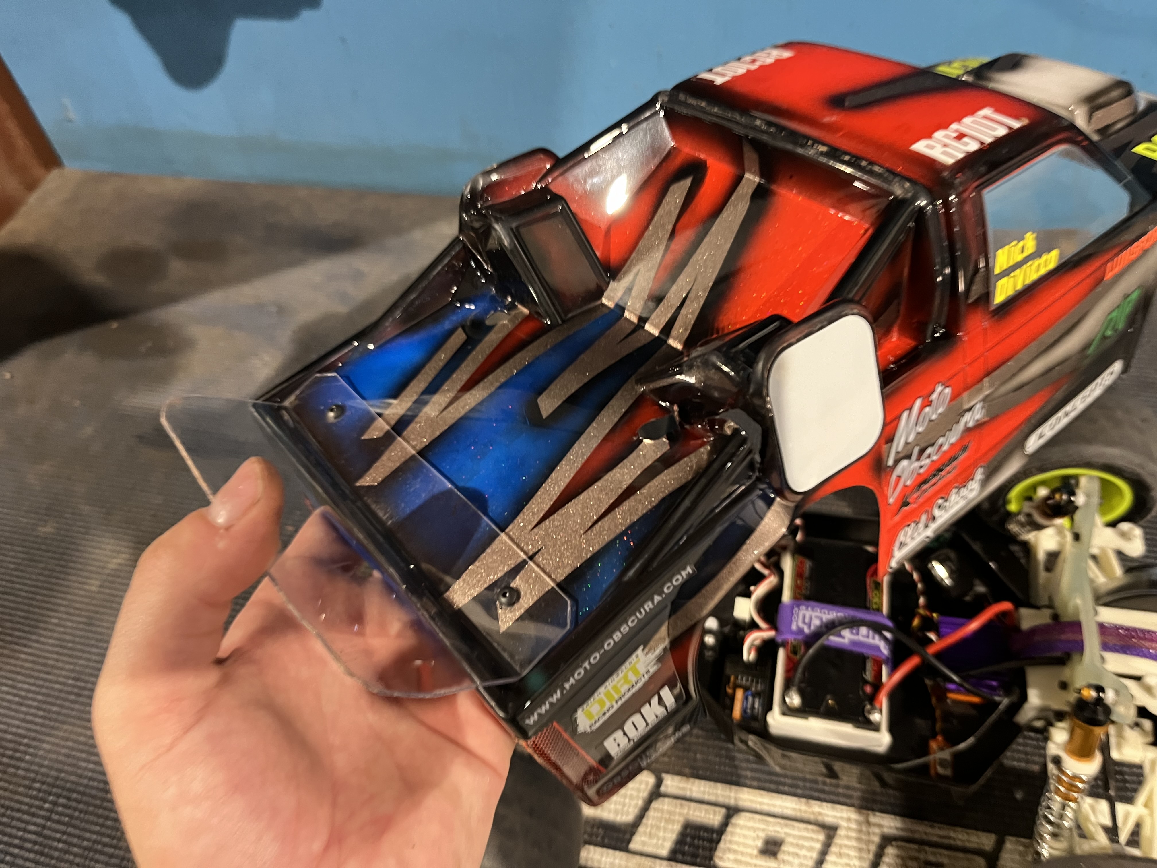

I bent some 1mm lexan into a 1” tall wing, which made a big difference in the way the car drove and jumped. The body started to crack just past the shock tower humps however, probably made worse by the added weight of the wing (the wing definitely didn't need to be that thick). I recommend reinforcing that area.

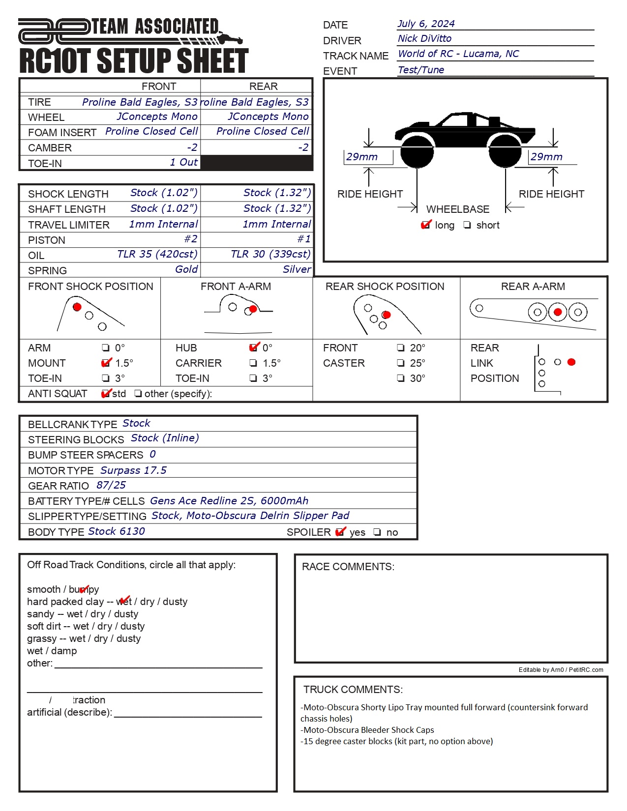

Here is the setup I arrived at. Down here we have very high bite and moist Carolina clay, the grip starts high and comes up even more as the day goes on. For this surface, 1.5 degree toe rear arm pivots provide a very nice amount of early rotation. If the surface tends to get dry or dusty I would use the 3 degree rear arm pivots to make the car more predictable at corner entry.

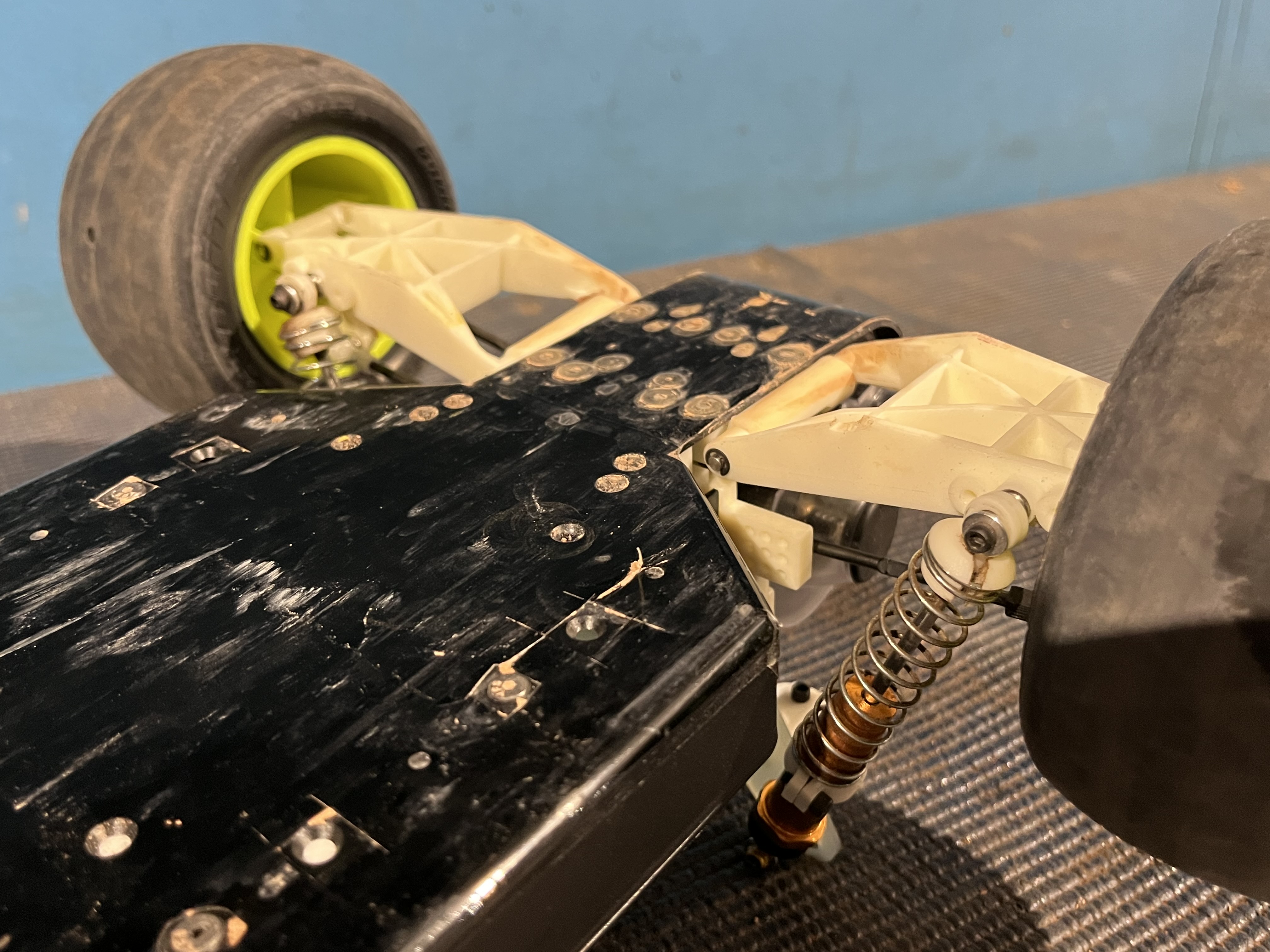

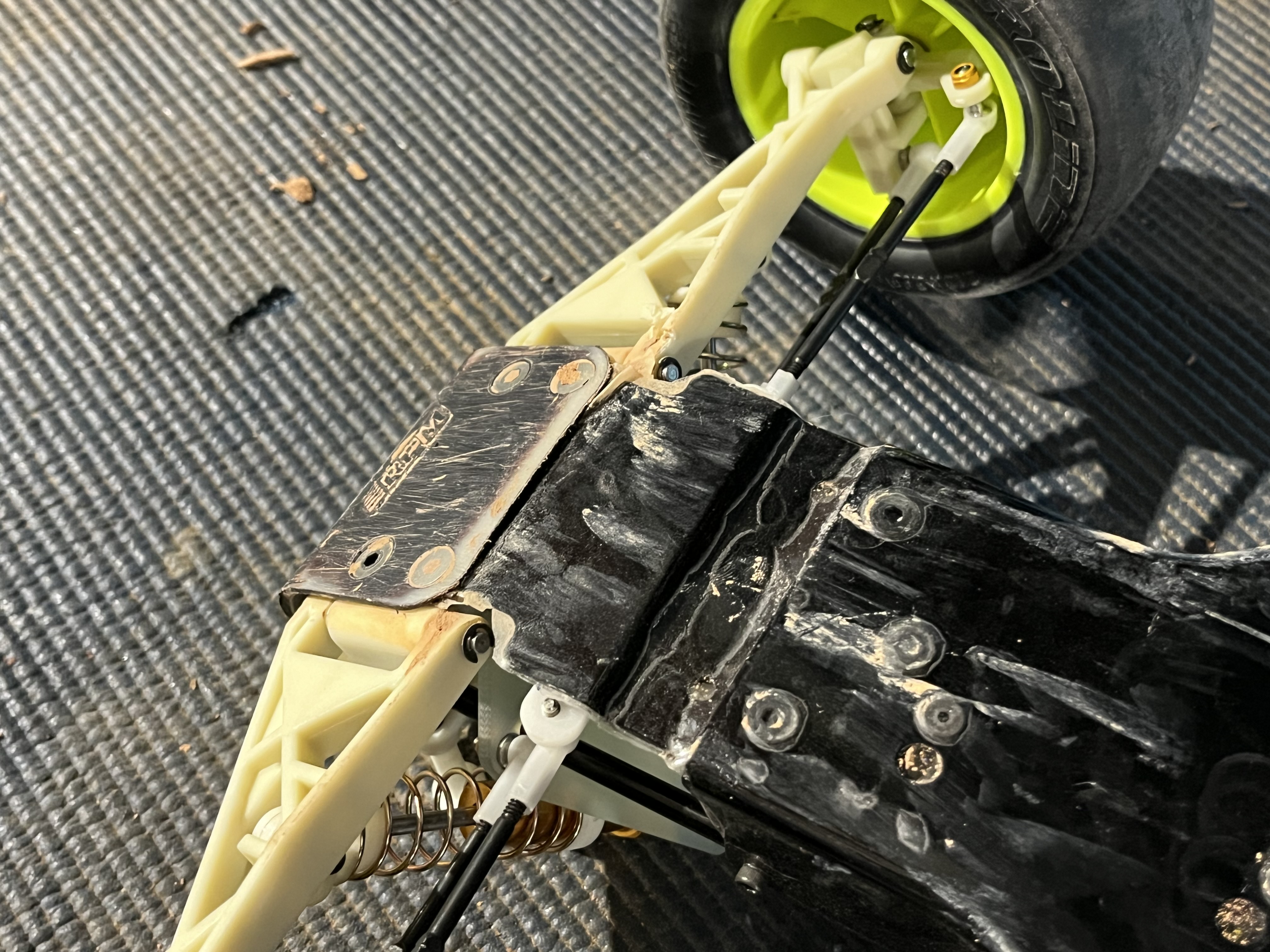

And here are a few photos of how the car fared after a hundred laps or so:

Thank you for sharing the setup sheet and pics. It's very nice to see runners to remind myself these are great race rigs. Time to build!!!
