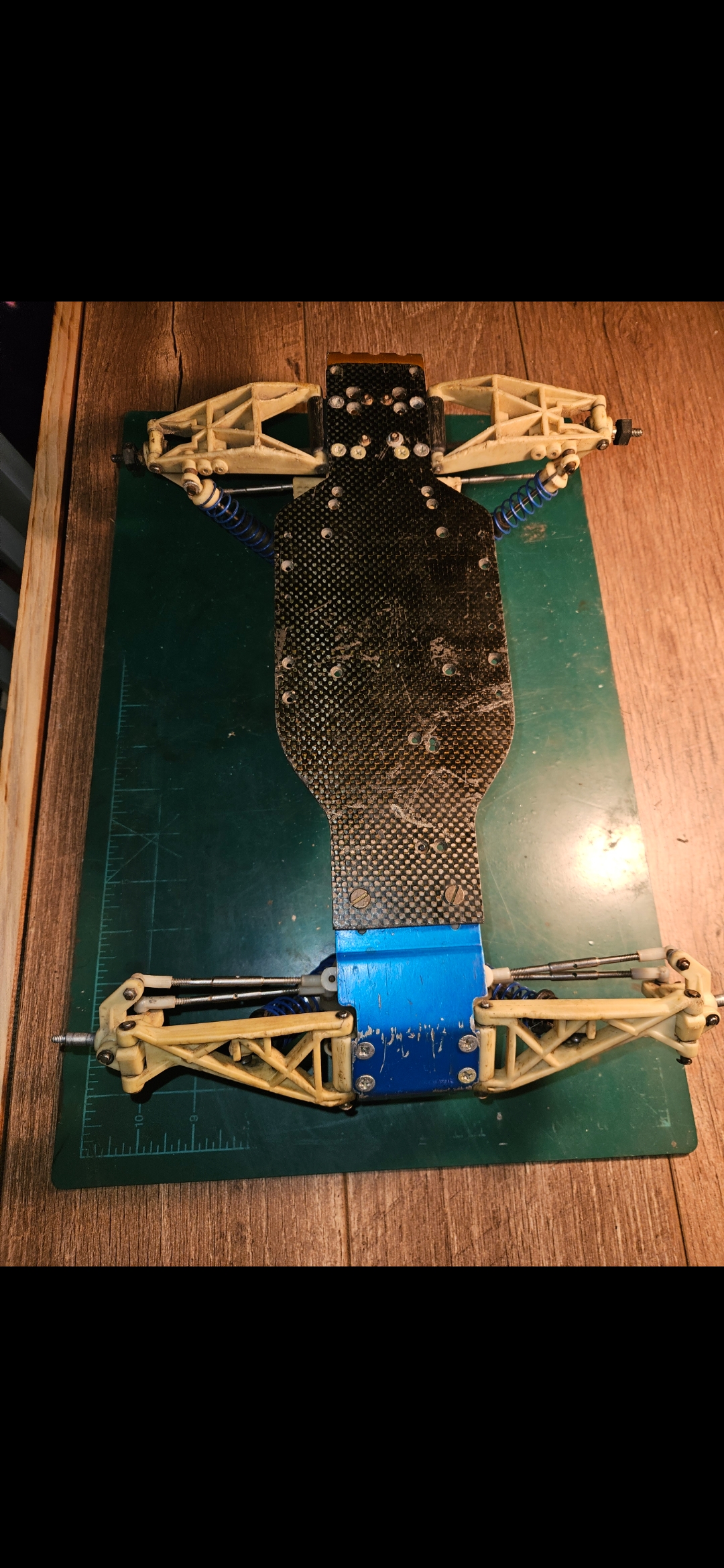

I've had this floating around for 20 years and I've finally decided to try and bring it back to life. The problem is I'm not exactly sure what I'm working with. I think it may be a "Frankenstein", but I'm just not sure. Any help getting it identified so I can start ordering parts would be greatly appreciated.

Definitely a Frankenstein.
Buggy graphite chassis with the nose cut off, with a truck nose (without nose tubes).
The rear has truck arms with a buggy shock tower.

It has a bent dog bone in the rear and a broken axle in the front. I'm assuming those would be standard RC10T parts, then?

Re: RC10T?
Yes.
For the front axle, you want the later aluminum (non hex) type. The buggy ones from that time are the same.

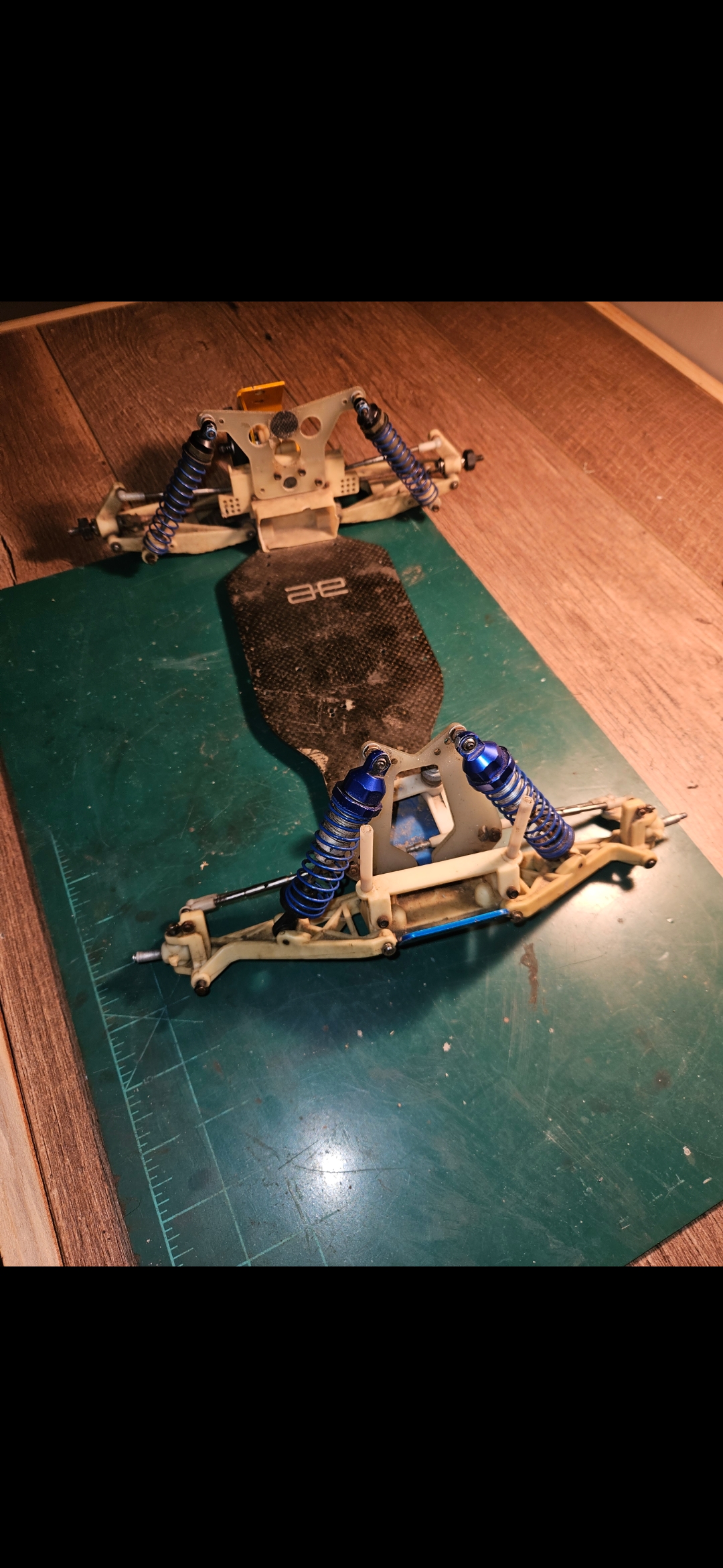

Full set of Technacraft titanium turnbuckles... don't see that very often.
Very cool truck, should clean up nicely. 👍
