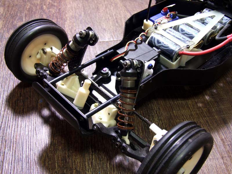

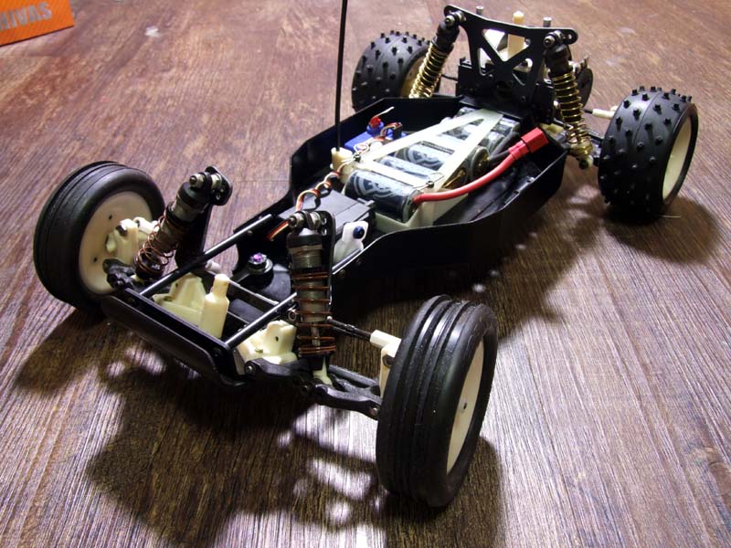

got this team car on ebay just for $51.00
came with Tekin 410 ESC
with some new parts, and with a little help from OxyClean and toothpaste
T2 steering
with CE
got new wrolds nose plate and aeiou's steering idea. Thanks Paul.
and, she got B3/T3 slipper clutch.
didn't get the front shock tower for .89 shocks yet. so, I installed .89 shock bodies & .56 shafts.
Bonus, my gold finally got painted!

Cool build, out of the vintage RC10s I think the worlds and the graphite are my favorite :wink:
I have a couple of questions for ya.
Why did you go with the T2 steering? Is it stronger??
And
I noticed that you mounted your servo on an angle, is that why there's an extra set of holes where the servo mounts?? I have a 10T and mounted the servo straight instead of an angle, what's the benefit of mounting it on an angle?? not questioning your mounting, but questioning my own mounting :oops: :D
Thank you.
59burst
Posts: 1011
Joined: Sat Jul 26, 2008 9:52 am
Location: Bothell, WA
Re: Worlds Project
Post by 59burst »
tecnica2001 wrote:Cool build, out of the vintage RC10s I think the worlds and the graphite are my favorite :wink:
And
Thank you.
the original steering had cracks when I get the car, so I just installed what I have.
also I tried T2 steering on my gold runner. it worked fine, and strong.
I wanted to make the steering turnbuckle as short as possible. I got BLS 6.5T on this project, and ordered GTB. I do believe fast car needs quick steering response. short steering turnbuckle is for that (I hope). :D then I noticed I had to bend the turnbuckle. but, I didn't want to do. so, I just found a way to mount a servo. and, this made the servo being parallel with the turnbuckle. that worked when I was digging Yokomo and AE GT and T2 at 80's and 90's. I hope it works again.

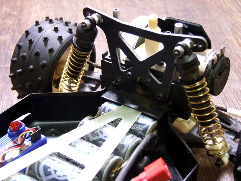

done! now got the right front shock tower for .89 shocks
rear
rear
front
front
