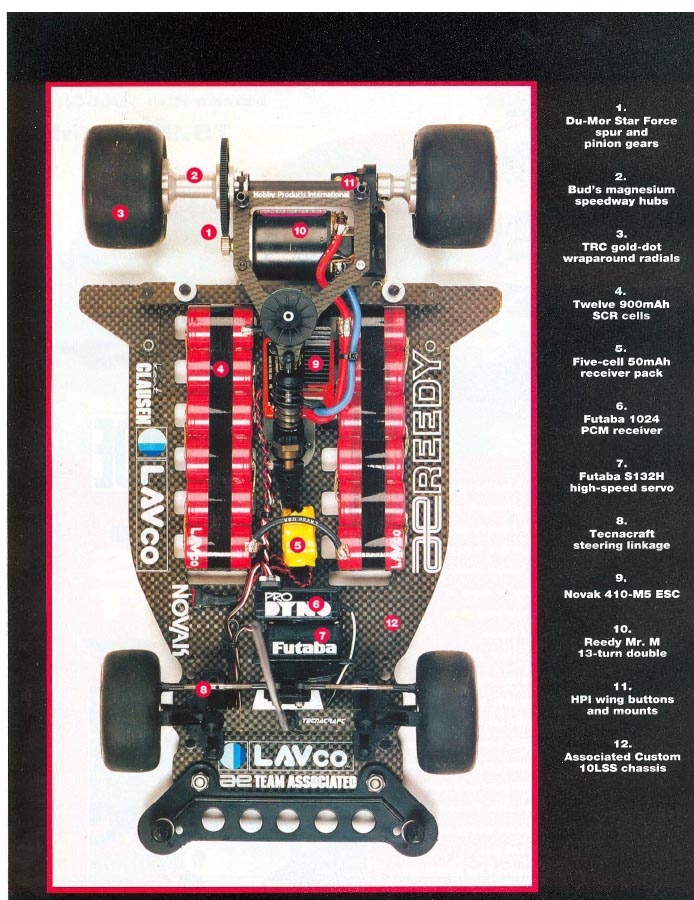

Forgot to ask what picture is this and where is it from?
Ryan

alright...... this isn't gonna be quite as easy as i had originally hoped. who'da thought.
now, looking at the chassis, it's definately not a stock rc10lss chassis. it also says it's not in the right column of the above pic. it says it's custom made. but, it kinda looks like i could modify a standard 10l chassis to make it work. i could narrow up the front of the chassis to lss width, use the lss rear pod, change the front battery hold down slots to the 6th cell slots on either side, then add the 2 new battery hold down slots in front of them. what do you pan car guys' think? i haven't owned a 10th scale associated pan car 1994, so i don't have the parts in front of me to say if it would work or not. so, i'd like to fall back a little bit on you guys' for some confirmation. now remember, i'm not trying to build an exact replica. just one that looks like it.

well, for the batteries, you could cheat with current "mini" batteries. that scan does say 900 maH batteries, those have to be smaller than the 1200/1400 scr batteries of back then. just cover them with red shrink wrap.
just a thought...

JK Racing wrote:well, for the batteries, you could cheat with current "mini" batteries. that scan does say 900 maH batteries, those have to be smaller than the 1200/1400 scr batteries of back then. just cover them with red shrink wrap.
just a thought...
i found these 1000 mah scr's. ready to assemble, and put them right in the car. correct size, too. :wink:
