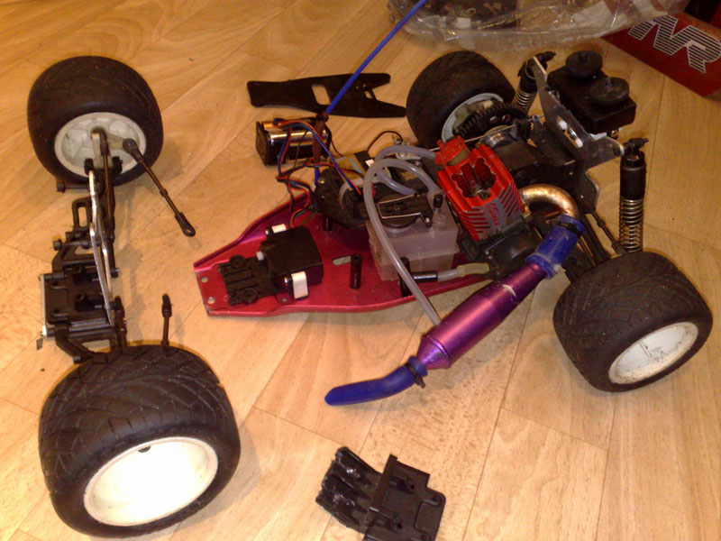

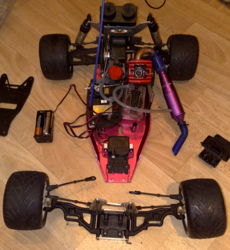

It's current state...

Came with a non standard TVR body, getting an original or similar would be nice. :)
A few spares were there too but not the ones I really need! :cry:
The crash wrecked the front chassis plate, front bulkhead, servo arm and both steering arms.
The first two parts i've sourced, I'm guessing it won't be too hard to find a similar shape current little servo arm, but i'm stumped as to replacing the steering arm set - KYOC5991 XR-16
Any help is much appreciated for the part or alternative that may fit.
Thanks.

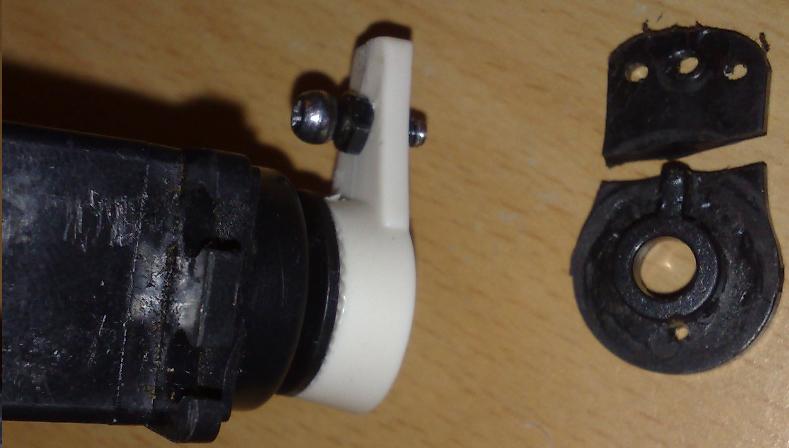

I couldnt make it to my local shop yesterday before closing to try and get a new replacement arm for the servo, then I noticed a plastic picture hook I had in the kitchen that looking shockingly similar to the shape and size of the original arm...
10 mintues of fettling later and I had a replacement part (see below) :) It will do for now, not sure how it would hold up to some rough driving use but the plastic seemed quite tough. So it got me thinking, i'm gonna do the same and mock up the arms I need too, then when my final part arrives (soon hopefully), I can stick it all together and check the geometry, if its good then I will most likely go ahead and use the plastic arms as a template to make some from alloy. Save me continually searching for this part, I'm not bothered about complete originallity restoring, as long as it works and 'looks' are a decent standard I will be happy :)

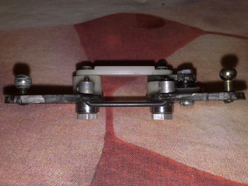

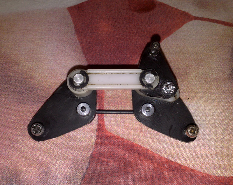

The steering arm mock up is done. It's not pretty by any means, but it serves a purpose for now and every joint is in the right place. I used some bits of what was left of the original broken parts, don't get the full benefit of the ballracers top and bottom of each stalk like before but it's tight enough that it still moves easily. My black plastic arms are not really strong enough material but I believe would stand up to flat tarmac use, any bumps or jumps in the vertical plane and I think they wouldn't last long.

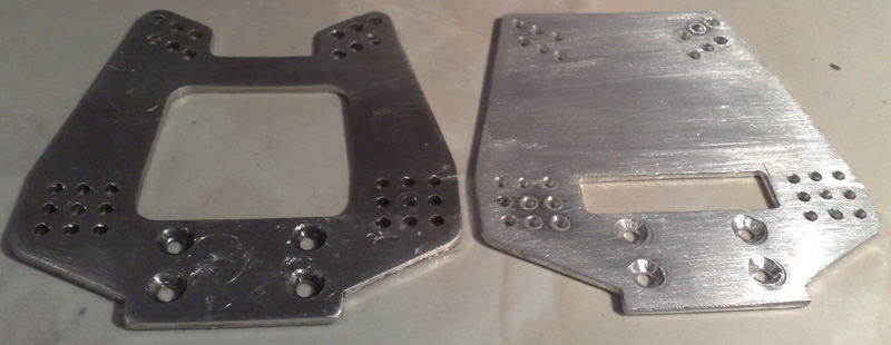

I've now replaced a few more parts, this one below had so many bends I would called it rippled...
