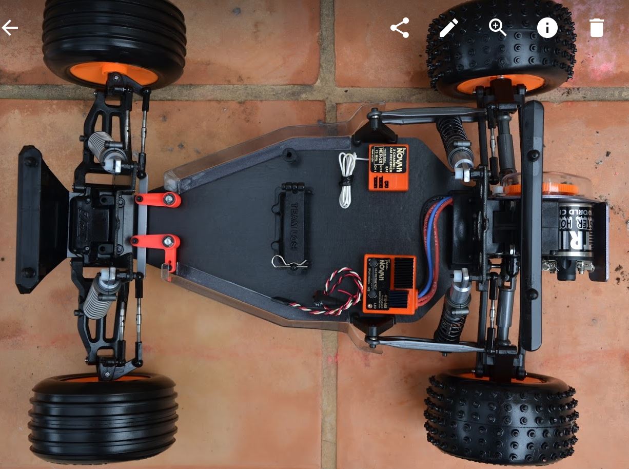

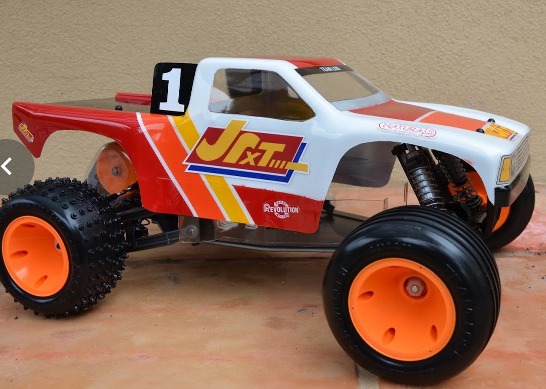

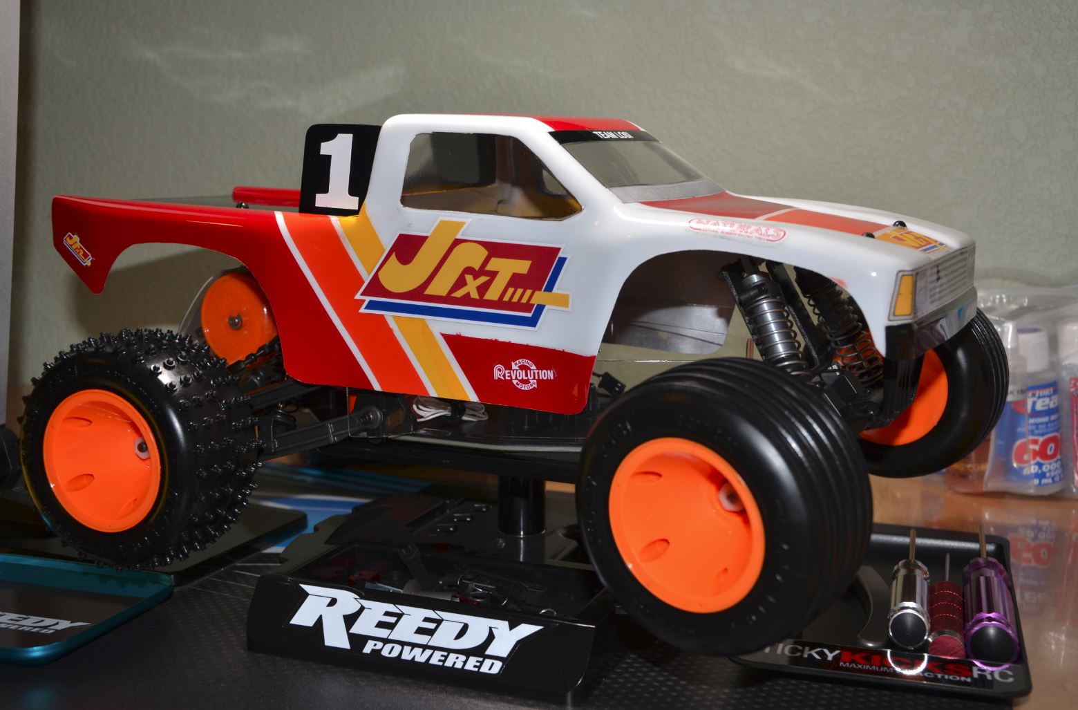

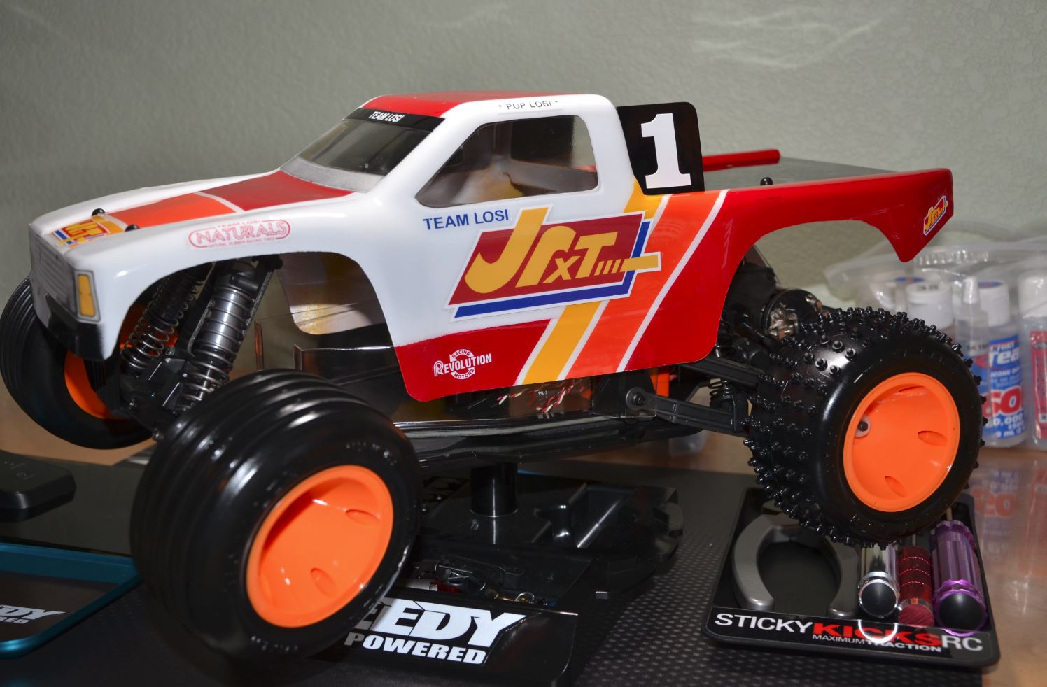

Hi. I have always loved the look of the JRX-T. I had a RC10T as a kid, which I loved, but I also wanted the Losi. Well, I recently rebuilt my original RC10T, and am currently building a NIB RC10T. I know the RC10 platform very well, but the Losi is new to me. I have been trying to learn as much as I can about it's history, etc. I always thought the 5 link suspension of the JRX series looked so cool. I found this JRX-T on eBay about 6-8 months back. I got it for a real decent price. It has likely been used, but it must have just been in the driveway a few times. My plan for the truck is to replace a few items with aftermarket, clean it up as best I can, get it as close to new as I can, and keep it a shelf queen. I am also adding vintage electronics to it as I go.

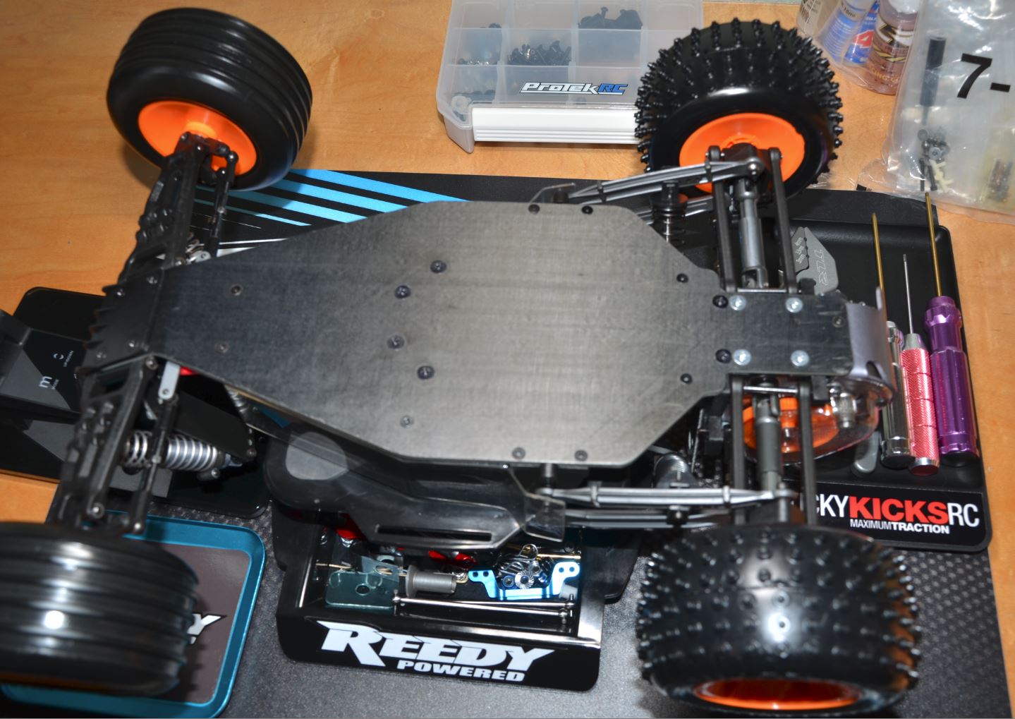

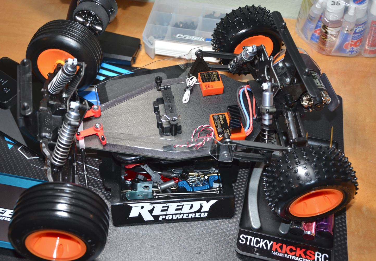

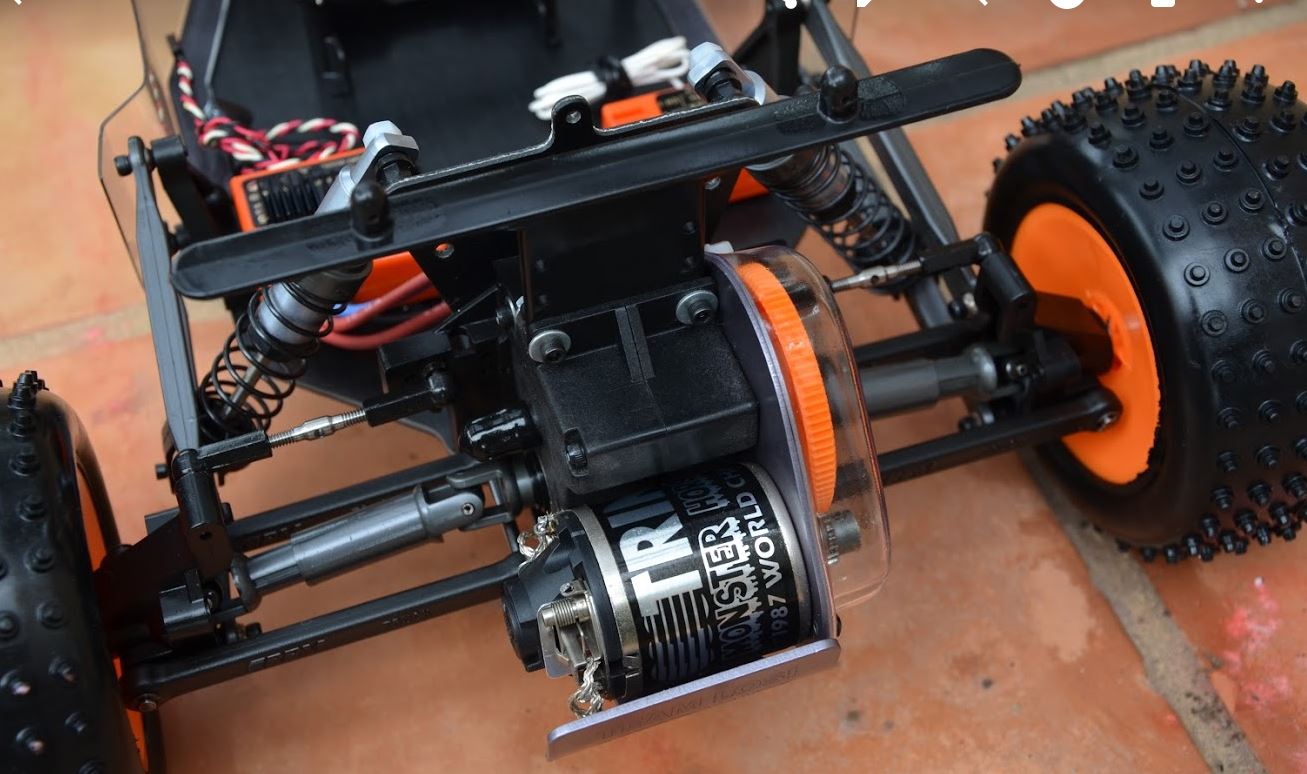

The underside of the chassis is has some very minor scuffs at the very rear. The motor plate is pristine. This truck was likely pieced together from different trucks, but it was done well.

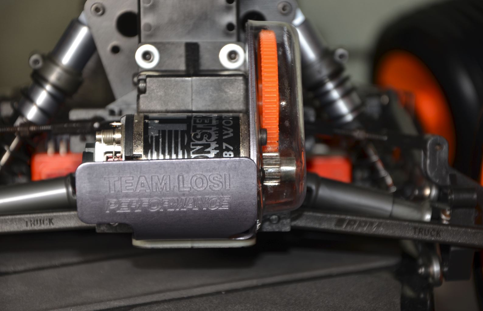

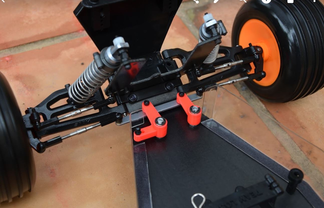

It came with RPM arms front and rear, RPM link carrier, upgraded steering linkage, and a clean Trinity motor.

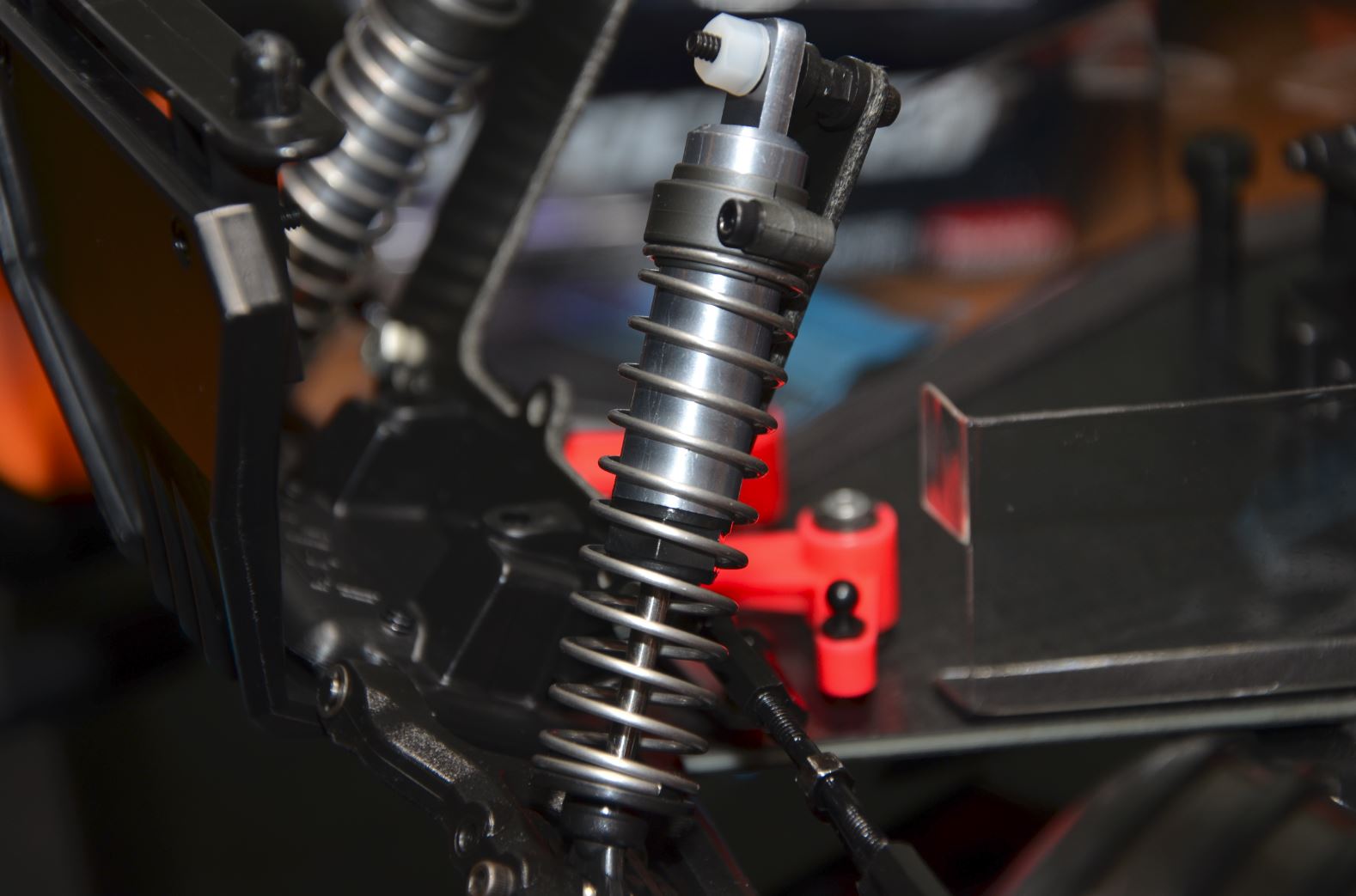

I have added the new dirt shields, and changed out a few pieces of hardware which were a little crusty. I also took apart the shocks. I replaced the pistons, shafts, and rod ends with new vintage Losi parts. The shocks were weeping oil with the original shafts, as they were pitted, but with the new shafts, they hold tight. I didn't replace the shock bodies, as they are very clean, but could be better. I am keeping an eye on eBay and may eventually replace all 4 with new vintage bodies.
The hinge pins were a little crusty, but I was able to polish them all to better than new.
I am looking for vintage Tecnacraft Ti tie rods to replace the stock units. I may also eventually change out the pivot balls with Ti units. The tires are overly glossy in these photos, because I am trying to soak in some SC1 for a few days. I also am undecided on what decals to put on the side of the clear dirt shields. Any suggestions?

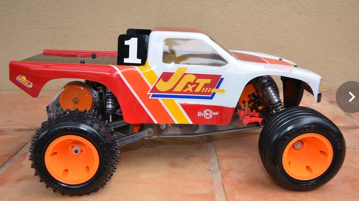

The body that came with the truck is "Good from far, but far from good." I added the black number plates out of scrap lexan, and cutout the number by hand. It is not an exact replica, but is as close as I could manage. There are very few photos for reference. I have noticed that very few of the JRX-T examples actually have the number plates installed. I don't know why this is, because I think it looks so cool with them attached.
I have ordered a new body that I will be setting up for this truck. I think I will make it box art, but am tempted to go early 90's style glam. I still remember the 2 JRX-T's from RCCA back in 1992 from Readers Rides. I thought both of these were such nice trucks. I am tempted to replicate on of them, but still undecided. I attached a scan of those trucks below.

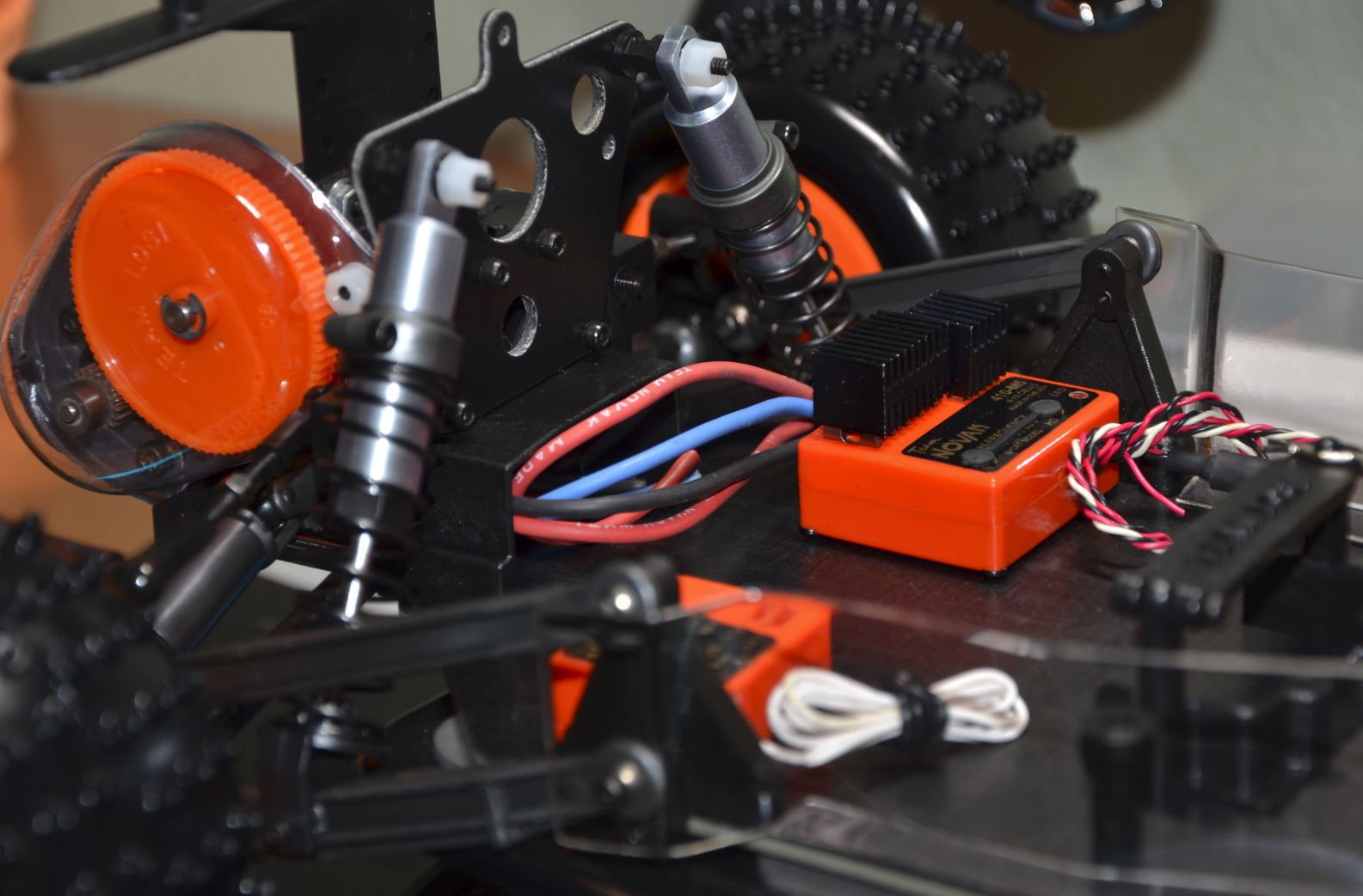

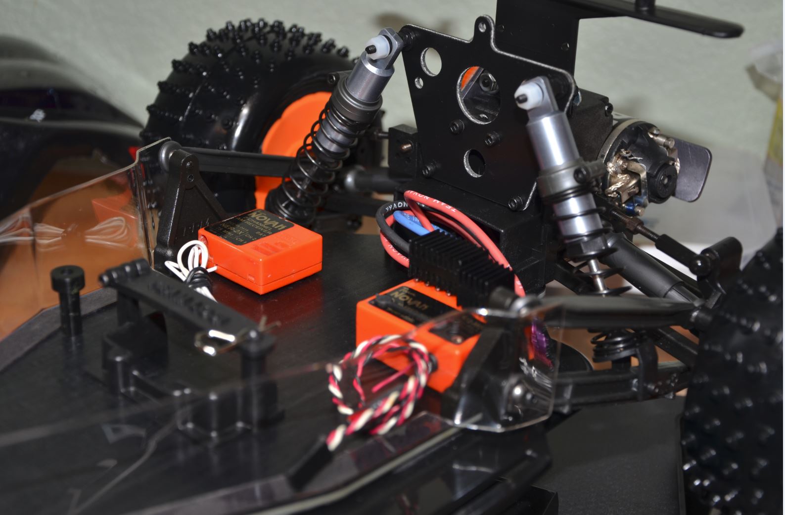

The vintage electronics are just mocked up for now. I still need a vintage servo, battery, etc.
Anyway, I will try to keep this thread updated as the truck evolves. Any input or suggestions are welcome.

I like the "Whole Wheat" Jrx-T. Box art is always nice, but so many people have done it. Plus I like adding personal flair. But I don't really like talking about my flair.
Your truck looks great! I have those same rear tires on my shelf Jrx-T, but I'd really like to get a set of the original tires. You are causing me to consider purchasing a new body for mine now.

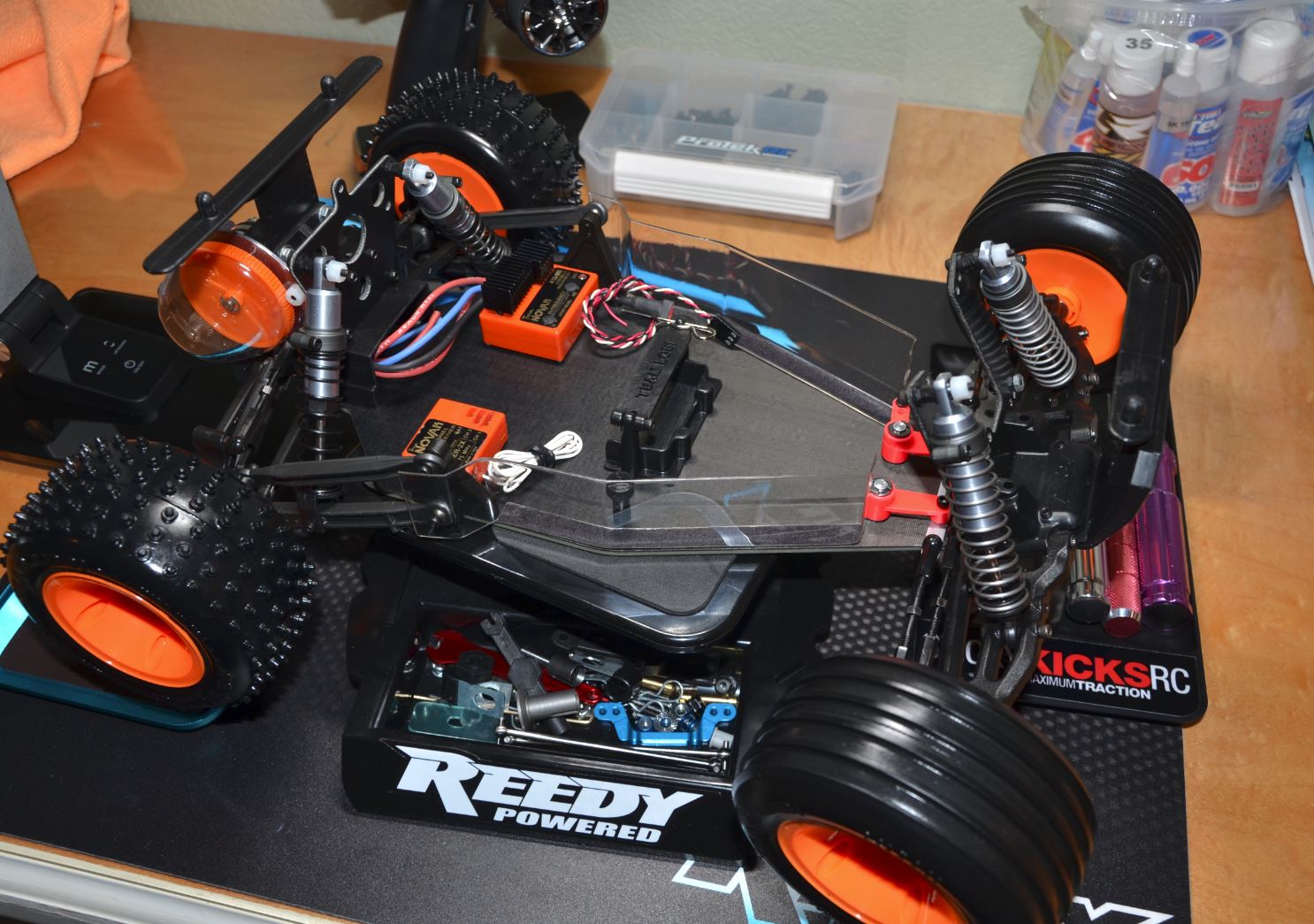

That looks great, I'm in the process of building a XT racer right now that will at least see practice time at track. I won't tell you how many parts cars off the bay I had to buy to get a full set of tecnacraft rods you are looking for, good luck!
Is that an early XT chassis with no servo saver hole, and didn't the XT come with the earlier original style X2 style battery cup. Just curious for reference?

When I first got my Jrx-T in 90/91 ish, it had the no servo saver holed chassis, and the screw hinged battery holder. I always thought the early style battery holder was only on the Jrx-2RCveteran wrote:That looks great, I'm in the process of building a XT racer right now that will at least see practice time at track. I won't tell you how many parts cars off the bay I had to buy to get a full set of tecnacraft rods you are looking for, good luck!

Oh yeah, you're right on the chassis. Not sure on battery box at moment but if you got one new than it must be what you have.

Thanks all for the input on the paint. I think you are right about going away from the box art body. I think I will come up with a period correct, over the top glam paint job that ties into the truck well.
Question: On the "Whole Wheat Losi" picture I posted, art those wheels the Wild Red color, or are they painted something different? I have been looking at finding a set of Wild red wheels. I also like the ones in the photo, but they seem a different color. It could just be the lighting though.

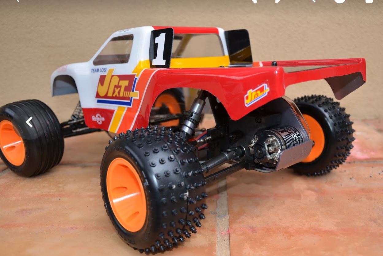

I found some Tecnacraft Ti Rods for my JRXT. It is a small, but very noticeable difference. I love the look of these tie rods.

And I thought I was the only one who installed tie rods in that direction. Glad I'm not 'weird' like that. lollavigna wrote:I found some Tecnacraft Ti Rods for my JRXT. It is a small, but very noticeable difference. I love the look of these tie rods.
Beautiful truck! Brings back memories.
- Lavigna
- Posts: 1462
- Location: Petaluma, CA
- Has thanked: 1099 times
- Been thanked: 1418 times
Re: My JRX-T Build
Thanks so much. What direction do you mean?Bottom Feeder wrote:And I thought I was the only one who installed tie rods in that direction. Glad I'm not 'weird' like that. lollavigna wrote:I found some Tecnacraft Ti Rods for my JRXT. It is a small, but very noticeable difference. I love the look of these tie rods.
- Bottom Feeder
- Posts: 325
- Joined: Wed Nov 06, 2013 11:30 am
- Location: Virginia
- Has thanked: 13 times
- Been thanked: 25 times
Re: My JRX-T Build
From the top, cranking them from back to front makes the links shorter. The reverse threads are on the right side of the car. Seems like any car I've built has it the other way around in the instructions, and many completed cars I've looked at close enough have it that way also. It's obviously functionally the same result but it makes more sense to my brain to have it this way.lavigna wrote:Thanks so much. What direction do you mean?Bottom Feeder wrote:And I thought I was the only one who installed tie rods in that direction. Glad I'm not 'weird' like that. lollavigna wrote:I found some Tecnacraft Ti Rods for my JRXT. It is a small, but very noticeable difference. I love the look of these tie rods.
