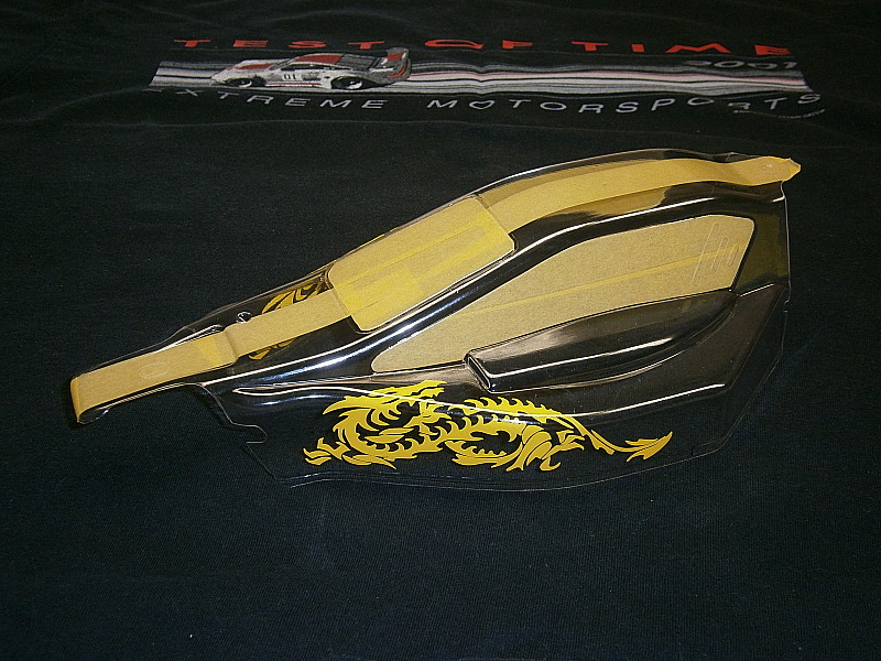

Hey joey, thanks for the encouragement to continue the thread. I love to use Tamiya brand masking tape. It sticks good and is nice and thin.
I was on vacation for a week so will be getting some action going on the body.
After getting all the window masks on I got to looking at the side ones. They are sort of big. To break them up, I removed some to create pillars. I think it looks better that way. The red Sharpie lines are there to help with alignment for the next masking step. I like to use a red pen, easy for my old eyes to follow. The lines wipe off clean using denatured alcohol.
These are some of the colors I'll be using. The rest are on they way.

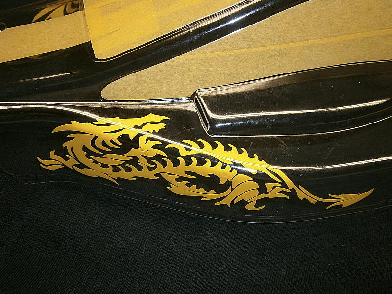

This morning's mail brought the body main color... Tamiya PS-23 Gun Metal. For what I have planned, a "spray bomb" will do nicely. If your more comfortably using an airbrush, you can decant the color into a jar. If you need some guidance on that, let me know, I've done it many times.
This is going to be the graphics I'm going to use. The mask was computer cut to my specs. I had them done as a mirror image so the dragon faces the same on the right and left side.
A little peek, peeled back corner.

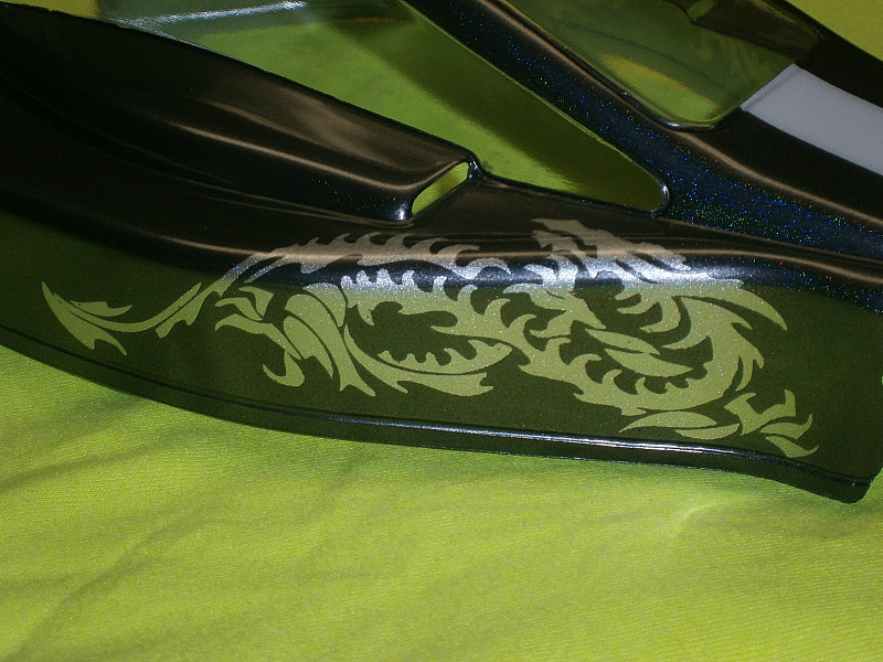

Excuse me for the lack of updates, things got in the way... vacation to the Blue Ridge Mountains of Virginia for a week!
I did a test "squirt" of the holographic and gunmetal paint this afternoon, digging it to say the least. I'll takes some pics tommorow in the daylight.

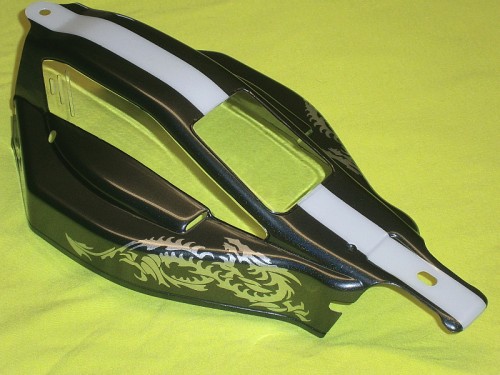

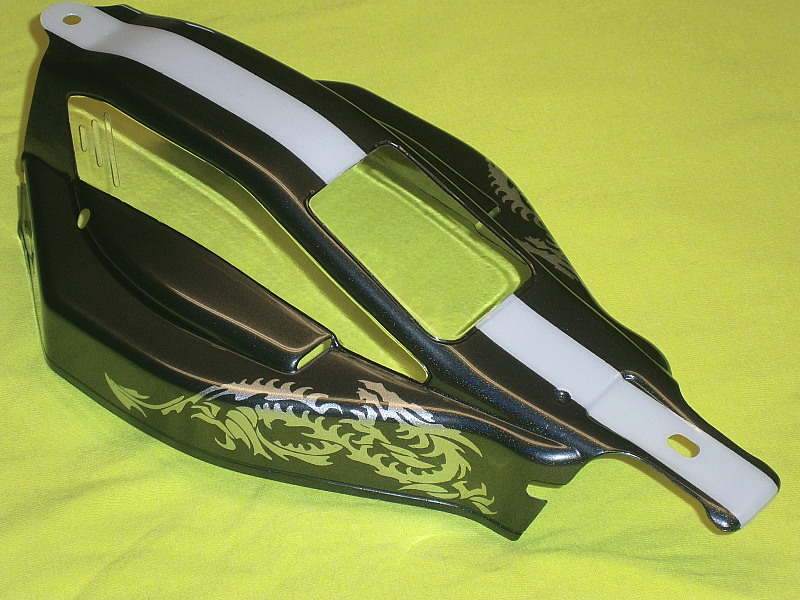

Re: Painting My Way
This is my first time using Spaz Stix brand paint for lexan. It's their "Holographic", backed with Tamiya PS-23 Gun Metal. There were no strange interactions using the two different brands of paint. You might get a different look if you backed with the recommended black as a backer. I like it and will use it again on the B4 body.

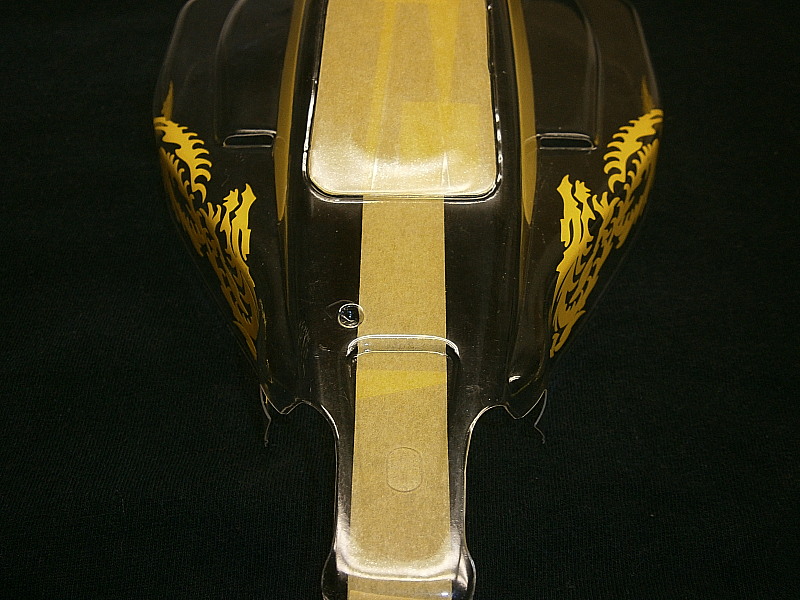

I went and trimmed another body for this thread. It was sitting a little bit crooked. Sometimes, cutting on a mold line does not yield a straight body.
I'm seeing a small window of opportunity to, maybe, get some paint squirted this week. I got into those reverse, mirror image dragon masks at sunrise this morning. Man, those were tricky as heck to do! If they had been on a flat surface, no problem. I'm getting set to burnish all the edges down tight and go for it tomorrow.
