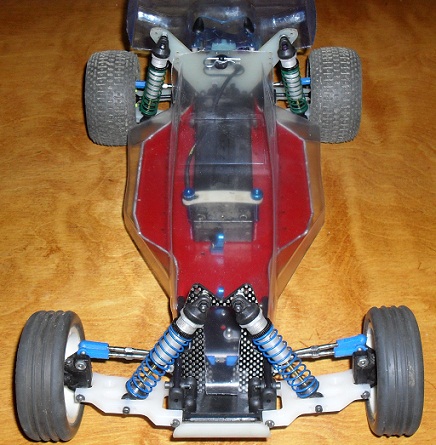

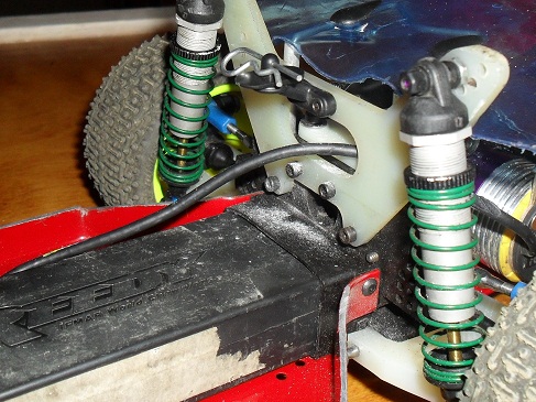

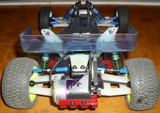

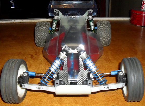

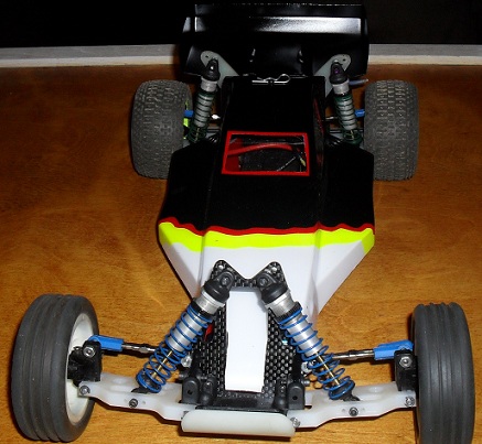

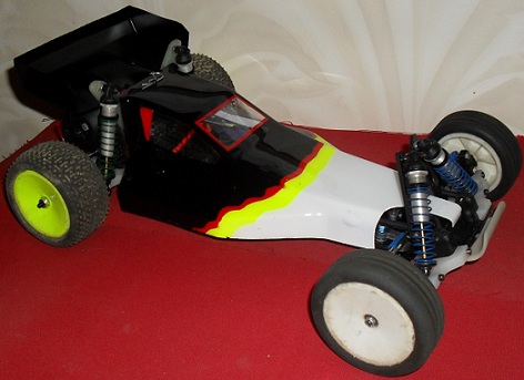

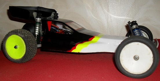

Ok, so I ordered the GT hubs on Monday and got them today, don't you hate when that happens??
1. In order to keep some of the cost down on this build, I decided to use as many of the parts that I had as possible. With that being said, I used a set of B3 CVDs, and they matched up perfectly, I had to mod the arms a bit to prevent the CVDs from hitting them, but they worked out good.
2. I used a set of B44 offset spring retainers to get the shocks away from the rear wheels, I don't know where I went wrong, but I wont be able to use the outside holes on the Klein arms.
3. I put together a set of Lunsford Tie Rods with RPM ball cups(blue).
4. Used a body mount from a B44 to make a rear body mount, the front part of the body will be attached with velcro.
I still have to mount the electronics and paint up the body....COMING SOON!!!!!!!!!!!!!

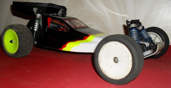

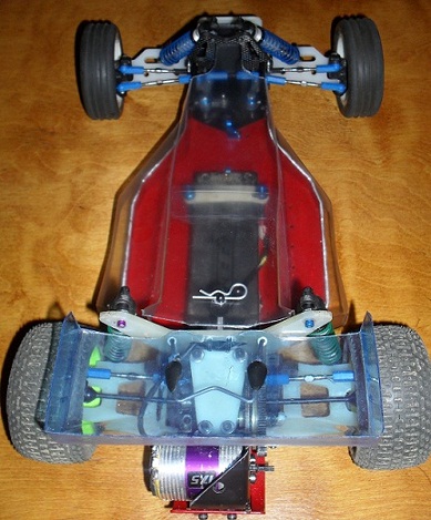

So I decided to do a quicky paint job on this body with my race scheme. Still working on mounting the electronics, and off to the track for some test and tune....
