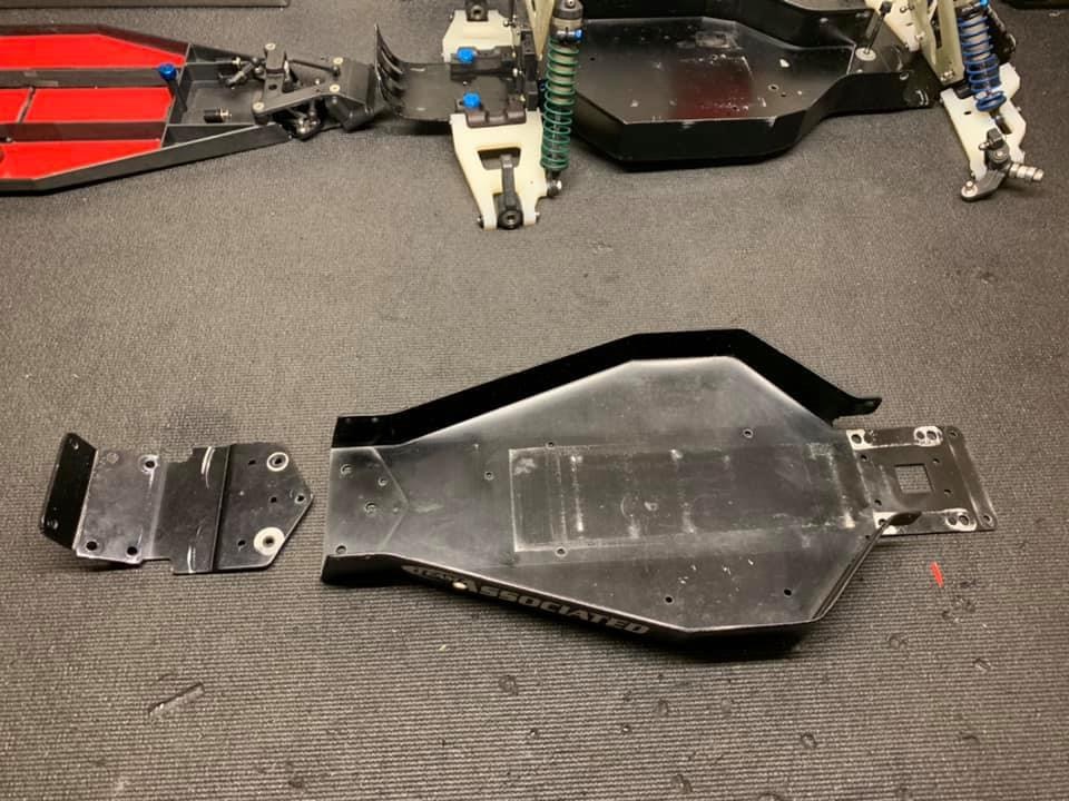

Nothing too exciting, just started to throw stuff at the Chassis, modified the battery strap and shock tower, so I can mount the tower in front of the bulkhead...🤷🏻😁

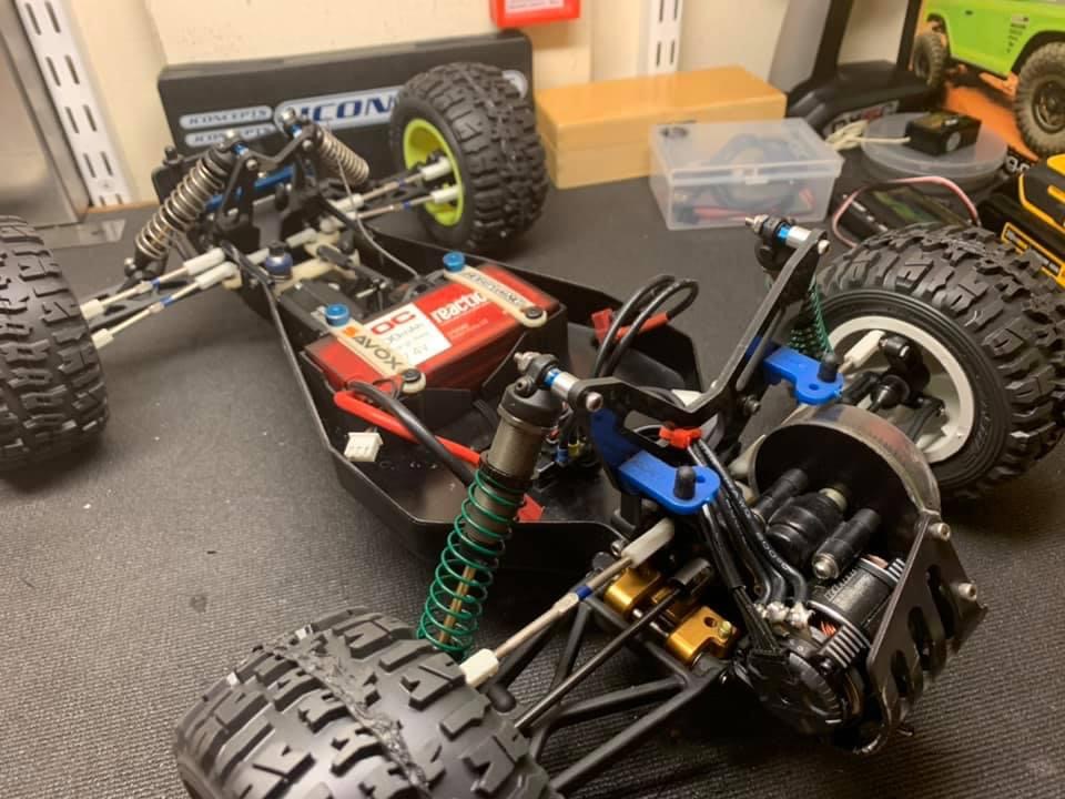

So finally got my carbon shock towers and some other bits, so instead of waiting until everything comes in, I’ll piece in whatever part I get as I get it....keeps me sane🤪
Aluminum turnbuckles and rpm ball cups, while I wait for the Lunsford kit to come in😁

So.......
Decided to mount the tower on it’s normal location, and added spacers on top to make the shocks sit nice and straight up and down.
Fitted the shocks, 1.32 rears and 1.18 fronts (since couldn’t find V2 shocks in 1.02 length.

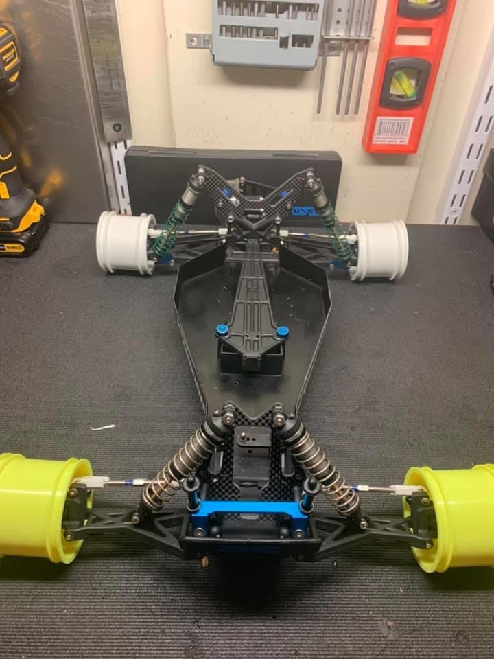

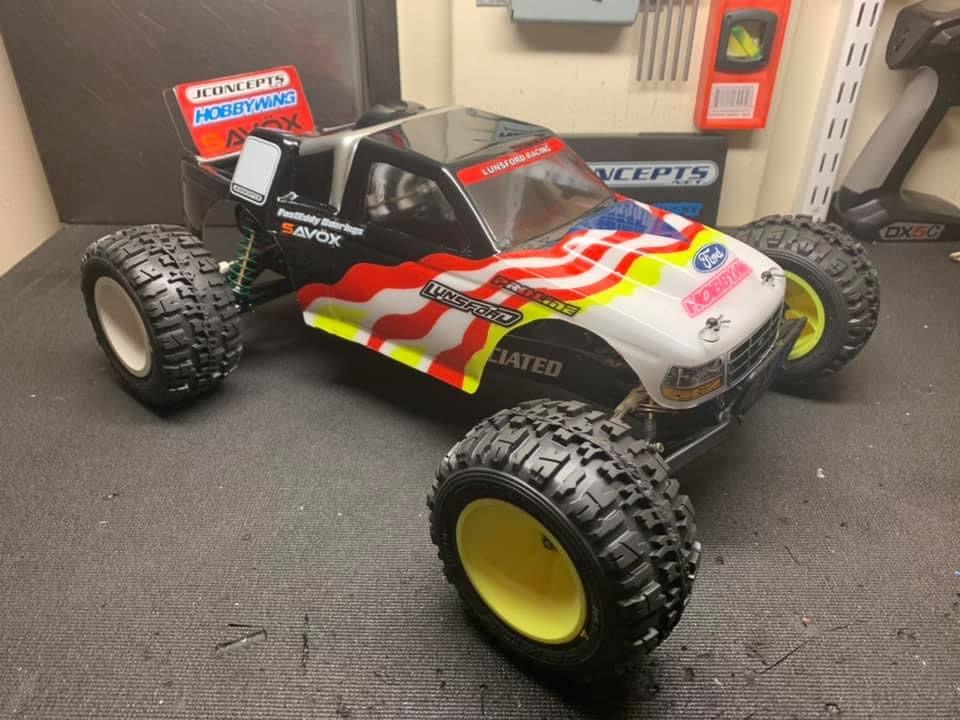

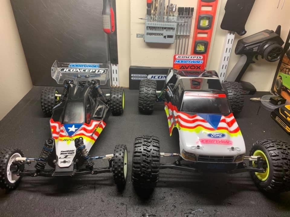

Here it is, painted and awaiting electronics

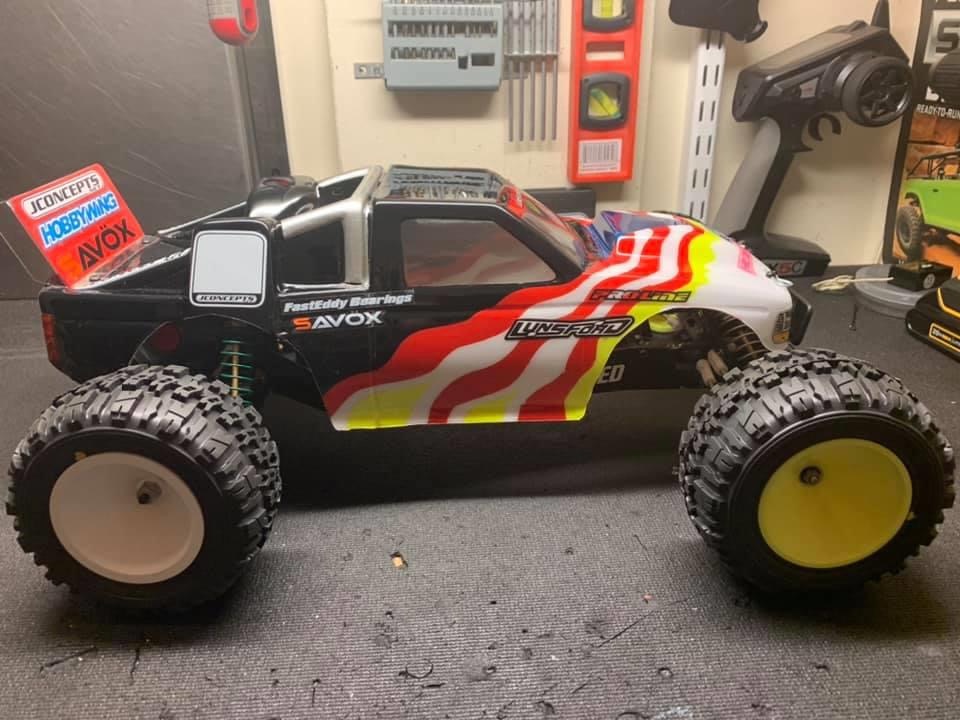

Thank you,
I’ve always had a soft spot for this truck, it’s my second favorite RC10 truck :D
Electronics Complete :D
Hobbywing Xerun XR10 Pro Stock ESC
Hobbywing 17.5 VR10 G3R BL Motor
Savox SC1251 MG Servo
Spektrum Receiver
78/26 gearing
