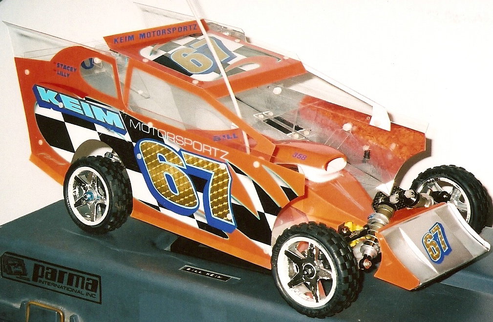

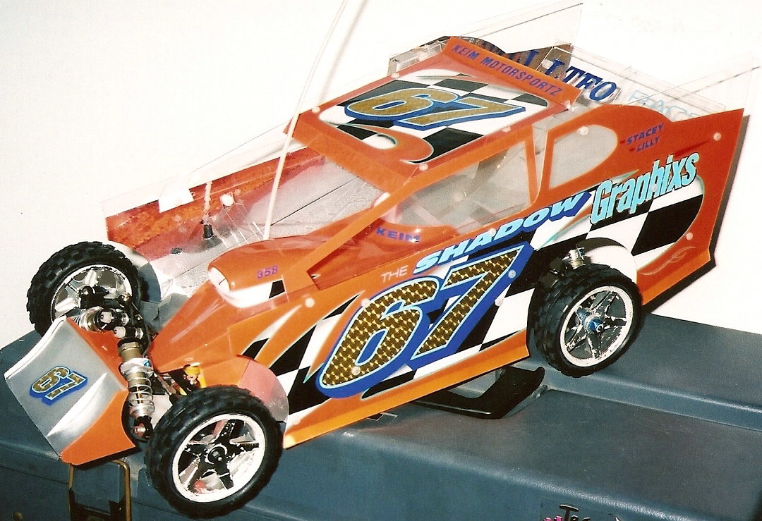

i like that nose wing mount, here's mine it's also orange but it's a terminator.
