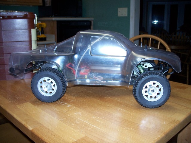

If you have a T3 laying around and want a cool project try this. I saw a few people talking about it on another forum and jumped in on it and this is what we came up with.

The wheelbase is still a bit short in your body on shot. Instead on messing with the front suspension geometry, why not just find a second chassis and splice them together to get the extra 1.5 inches you need? it's not that hard, you just need to measure twice (or 5 or 6 times lol) and cut once. Get some thin carbon fiber and epoxy and make a longer chassis. I really think screwing with the suspension is just going to bog down the actual testing and setup work.

I remember around the time of the first thunderdomes people narrowed their saloon bodies by removing a strip along the center.
Maybe a good idea for this body: split and overlap behind theside window.

I agree with markt311, the wheelbase does look short. Don't forget that the wheelbase gets shorter as the suspension compresses. I found that stretching the stock RC10T wheelbase by 2.5" makes the wheels line up perfectly when the chassis is bottomed out. I haven't run it yet, screwed up drilling the new chassis plate, but there appears to be enough clearance for the wheels when the front suspension is fully extended.
Re: SC-T3
I agree that making the chassis longer is the best way if you have a metal chassis .Cutting and then try to epoxy a splice im not sure of. If you have done this post some pics please. On the T3 the front clip is a metal section that bolts on so that might be the answer to the chassis mod. Make a longer sub section that is a direct fit. I have a SC10 and this T3 I raced alot over the years and was just sitting there collecting dust. So I thought I would try this. The wheel base is a tad shorter @ 12.5 " Vs 12.9. When the suspension is compressed the wheels move back but also move inward tucking in behind the fenders. Ill let you know how it runs. I have a 10GT Factoy Team that I want to make a 2wd SCGT. I might make a new chassis for this or cut and splice.

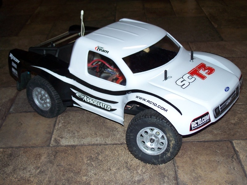

Re: SC-T3
Here is a picture that I found on the web of a real SC10 (bottom)and a new picture of my SCT3 (top) at the same angle to compare. I think they are very close. Thanks for all the feed back and good luck with your conversions!
- slotcarrod
- Posts: 4415
- Been thanked: 45 times
Re: SC-T3
Very nice truck and body. Love the custom SCT3 decal. Let us know how it compares to the SC10.
