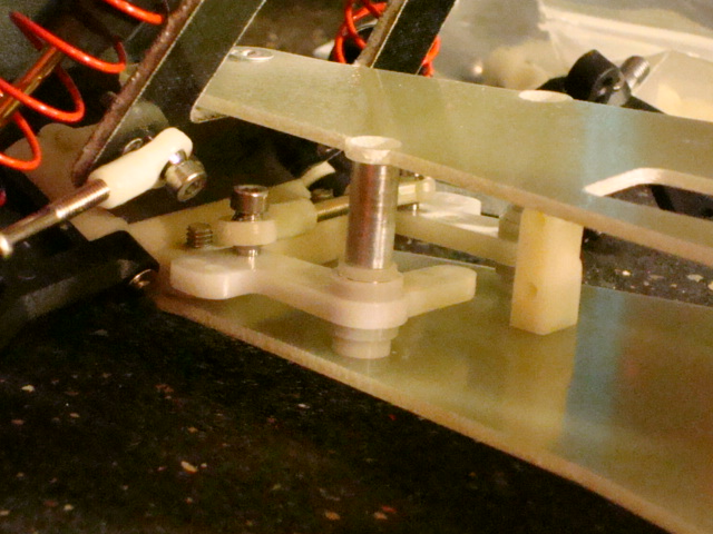

Notes: The steering bellcrank comes with plastic bushings but I opted for some Avid bearings instead. The shocks went on without any problem, and are nice and smooth. I will have to replace the "Slash" oil with some lighter weight oil eventually.
I had reservations about the strength of the fiberglass chassis. It became kinda floppy after I started to bolt the pieces on it, so I mocked up the front stiffener. It does a very good job of tying everything together and makes the whole assembly ultra rigid. Hopefully you will never have to replace the steering link from the servo as you would need to remove this brace to get to it.
Bellcrank installed

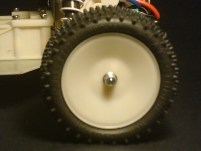

2.2" wheels with Proline rubber
I swapped out the Diamond Power motor with this Peak Performance modified. Thought it fit the car better since it is more in the same era and Traxxas' affiliation with Peak...
