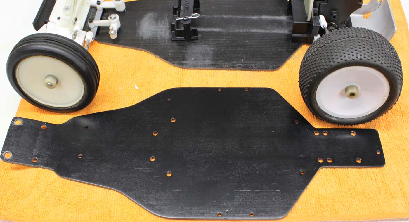

For those of us who are airbrush challenged, What spray paint is advised for refinishing a losi chassis plate?I'm looking to spray just plain black onto the black chassis.
Satin, or flat? brand? do I need a primer first?
I have a jrx-2 chassis that I've sanded and filled in the excess holes with jbweld, just need to sand one more time and paint.
Thanks
Thanks

Are you trying to make it look as close to original as possible or do you want a nice clean black plate? Runner or shelfer?
I have done some wet sanding on an AE plate and then sprayed clear with mixed results. I have better results with hobby grade model paint, seems to have a much finer spray.

I'm looking to restore it for a shelfer, If it was a runner I would just run it as is.
I'd like to get a stock look. sanding and clear won't do as I have numerous holes filled with grey material. I'll give the satin black a try, see what I can find locally.
Thanks for the info guys.

thanks for all the info guys. I wound up going with dupli-color flat black. I picked this because they had a matching sandable fast dry primer, that filled in a lot of the imperfections well.
Here are a couple shots of the chassis. The one I painted had about 5 extra holes drilled which I filled with JB weld. I applied 3 coats of primer to the bottom, sanding most of it off between coats. This filled in all but the deepest grooves. Then I sprayed a few coats of the flat black, sanding before the final coat. I then used a countersink to clean out and slightly deepen the holes on the bottom. I think it looks pretty good, satin/semigloss would have been too shiny.
This plate started out looking like the used one pictured.
