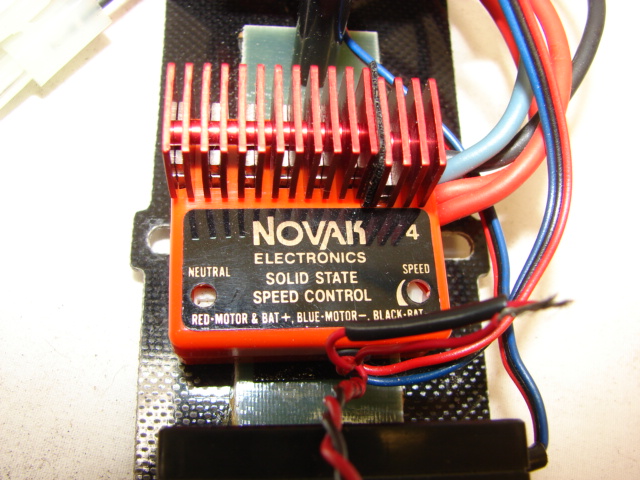

I just received my new Novak 4 and receiver. In looking at the esc I noticed 2 wires red in color that come from the same place as the switch. They are bare on the ends and they is a small piece of shrink tubing on one of them. Looks factory to me. I took a pic. no solder marks or anything.
Is this right and what are they for??

The two red wires are only supposed to be making contact with eachother when running 4 cells from what I remember. For 6 & 7 cells, they should be separated.

I went over to Novak and found what they were for! Leave them alone for 4-6 cells and solder them together for 7+
Glad to see that is still unused and not messed with.

Are you sure that's right? I'm pretty sure thats backwards and that connecting the red wires bypasses the BEC for 4 cell use.

davidka wrote: Are you sure that's right? I'm pretty sure thats backwards and that connecting the red wires bypasses the BEC for 4 cell use.
+1 on what davidka said.

according to my novak booklet, leave apart until 7-10cells is used. :)
