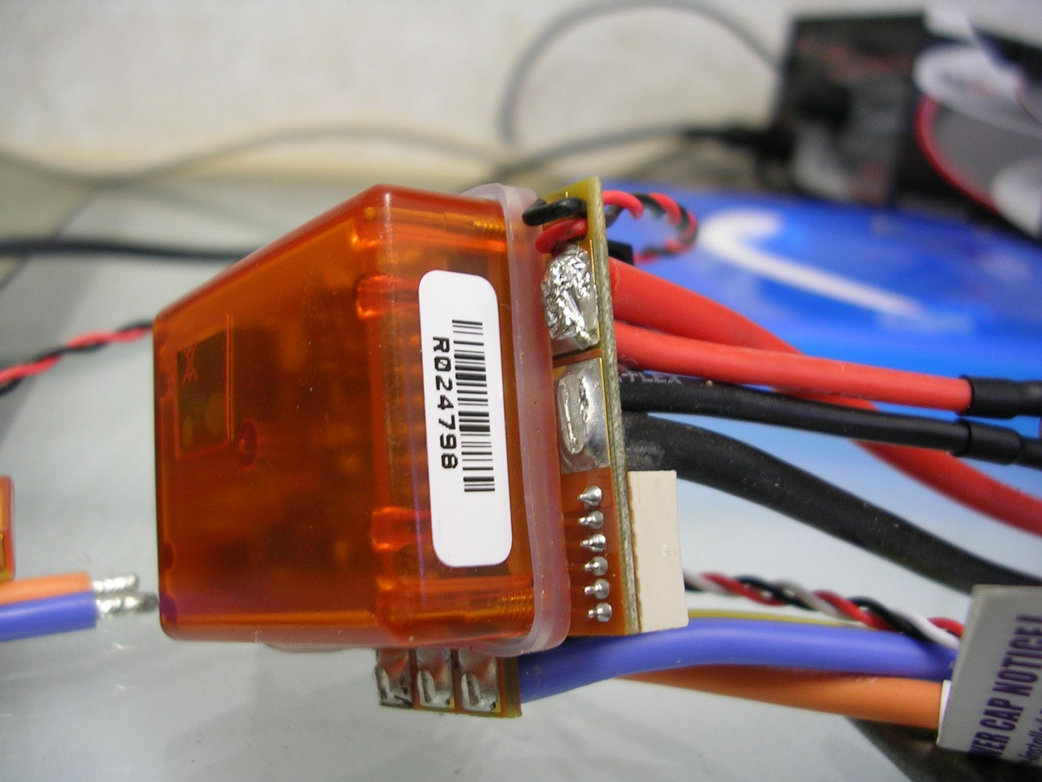

I'm having problems getting the factory wires off of my Novak Havoc. I want to use specific coloured wires to customize it. I have a Team Checkpoint soldering iron, so my iron is not the issue. I can't seem to get the flippin wires unsoldered. It appears as if the wire goes through a hole and soldered on the bottom and then snipped.
The only thing I can think of is to snip the wire off just above the top of the panel and solder the new wire as close to the surface as possible.
Anyone have any suggestions

the wires do go through a via (plated hole) and are very efficient at carrying current(and because they are closely related, heat as well).
if you don't care about the wires, clip them off and use something like a dental pick or similar to 'flick' the wire stubs out of the hole as you heat with an iron. it helps to have a clamp or something with a third hand vise to hold the pcb while doing the work. use a lot of fresh solder as you apply heat, the flux will get things moving, the dripping solder will help pull the strands away. too many times i see people try and work solder joints without using more solder or if you have it, flux. it makes the solder less like oatmeal and more fluid.

Just use a little pull while holding the iron under there and you should be good to go, looks like you are hitting it in the right spot

I've been pulling on itCharlie don't surf wrote:Just use a little pull while holding the iron under there and you should be good to go, looks like you are hitting it in the right spot
I'm good to go, but my wires are no different

heat rises so heat from underneath and make sure the solder liquefies on the top plated hole also, are you sure your iron is hot enough? add some more solder while desoldering too that always helps me with stubborn joints

Good point about looking at the top. It's always been facing down and me pulling down as the solder melts.
And the solder on the iron is usually the way I go when soldering or unsoldering.

I'm still tugging on the wires, but not getting anywhere with it.
I feel as though I'm going to apply too much heat and damage the esc somehow, is that possible?

If your iron is above 900f then you can, but if your iron is tinned correctly then it should take no more than 5-8 seconds to loosen the solder enough

I always tin it and the dial on it only goes to 896, but I guess that's close enough.

I have not worked on my Havoc speed controller yet, but I did remove the wires from the motor(factory installed 10.5 kit). It was very difficult.
I would use new solder as mentioned earlier. Once you see it starting to loosen up use a solder sucker to remove the liquefied solder. Eventually there will not be any solder left in the hole.
Good luck.
ED
