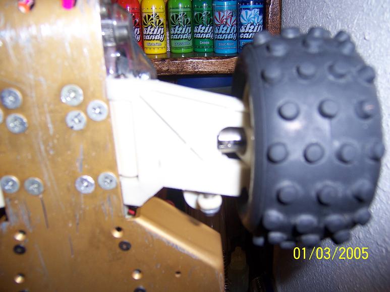

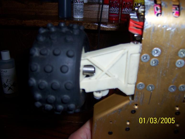

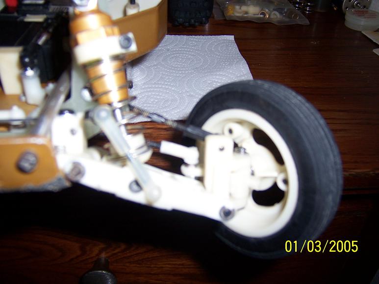

Looks good with some nice patina! Only thing I see incorrect is it has the wrong turnbuckles on it. It would of had just straight 4-40 threaded rod for the tierods. Something you might want to change if you want it period correct. You can usually find it in any hobby shop. If you do change them out be sure not to damage the ball cups, READ(no plier marks!). Those little suckers are worth a mint when you can find them.
I take that back! it has the wrong front arms on it too! Should have the short arms. Did you ever look if there is a stamp under where the tranny goes?

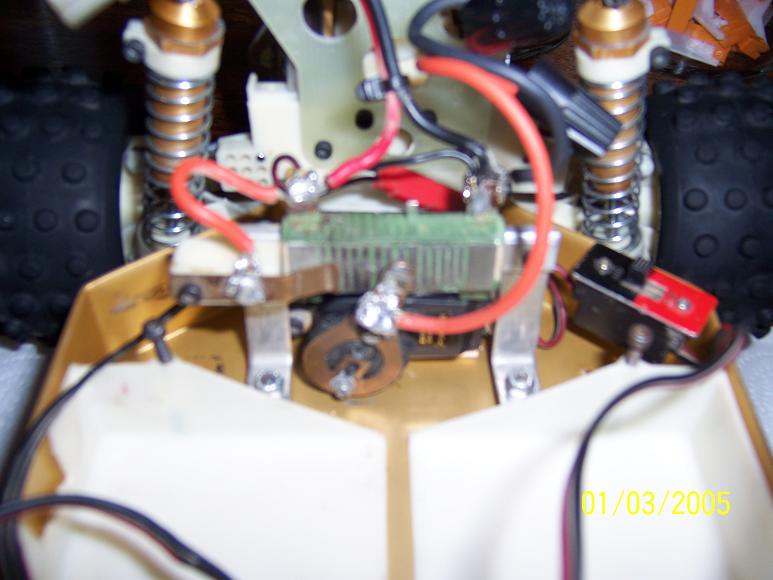

speed control advice please...it only goes when i pull reverse

Upon further review its got some wrong steering gear too. Its almost like it had a complete later model front end bolted to the older chassis. Except it has the correct shock tower :? Weird!

Flip the "servo reverse" switch on your radio for the throttle servo. See if that helps.

Make sure you push the switch all the way over. If it is somewhere in between, sometimes they just don't work.
What radio are you using?
You know that speed controller is the Cadillac version one as well.
