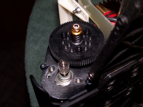

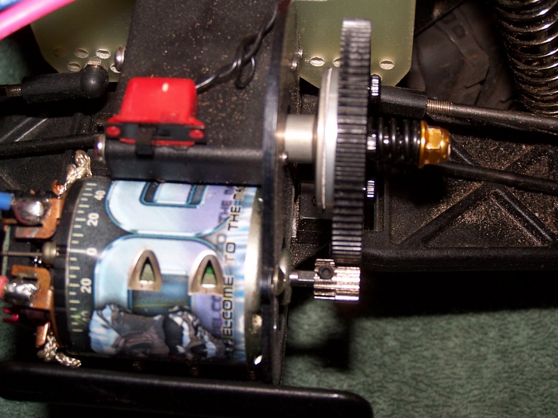

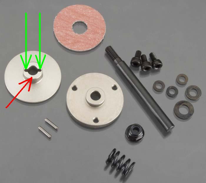

I have had no luck finding a replacement Rulon disc for the MT-10M, so I picked up a slipper clutch kit for an Axial AX10, (since it appeared to be a good possible solution). 90% of the kit fits the MT-10, with just a little modification, it fits 99%. I first removed the outer roll pin from the transmission input shaft (because it won't fit into the Axial inner clutch hub, so I used the small pin provided with the Axial kit. It fits loose, but when everything is together, it won't go anywhere). The biggest problem is when I put the inner slipper hub on the input shaft, the hub would drop all the way down to the motor plate and the inner face of the inner hub (red arrow) would ride against the motor plate, creating friction when the outer hub was tightened in place. To stand the inner hub away from the motor plate, I cut 1mm x 1mm x 5mm strips of rubber (2 pcs.) and set them in the channels of the inner hub (green arrows). So far it works very well, I did a few practice laps on the driveway and with some adjustment's, it should be a viable solution.
