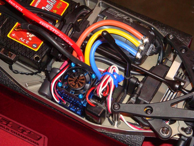

Pretty tight getting electronics in this thing. I had to switch to a spectrum mini reciever to get a little more room. I would like to hooked up the telemetry using the 300ST reciever to monitor motor temp, etc. but just not enough space.

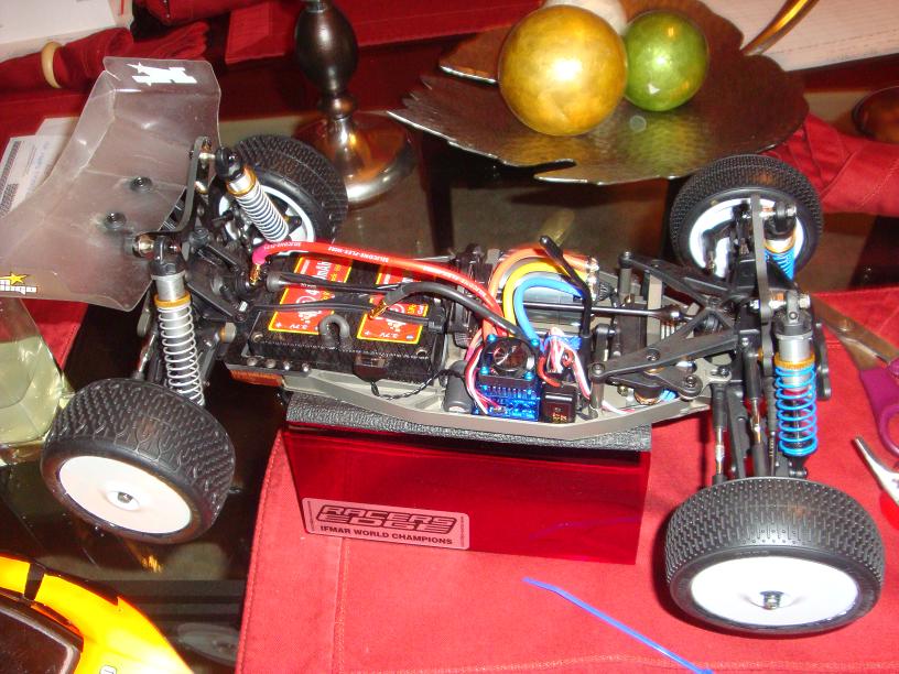

Heres a pick of my team car - with one of the new Tresrey "Gainbull"bodies from Japan on it.
Myself and another team member are trying a new set up this weekend (weather permitting) - will let you know how it goes - it is a combination of Hupo's set up from the Cactus Classic and some of our own. I am running stock and my team mate is running mod (not that there is a massive difference in top speed these days!).
The paint is still not fully dry - still a bit of finishing work to do.
Cheers
Darryn
