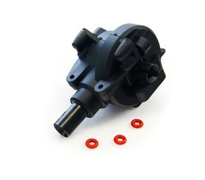

The older style:
Just tossing this out there but why not TC3 diffs to keep it all Associated?
More difficult mounting, smaller, plastic gears. The RS4 diffs will be stronger internally, and mounted more easily without tying into chassis braces. I considered using Prolite diffs, but they're larger both dimensionally and in terms of outdrive sockets, so that creates some challenges. The RS4 outdrives are very close to AE, just need to be opened up slightly.
