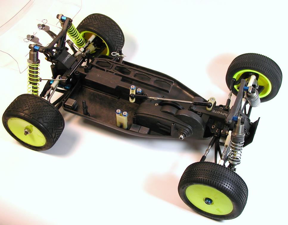

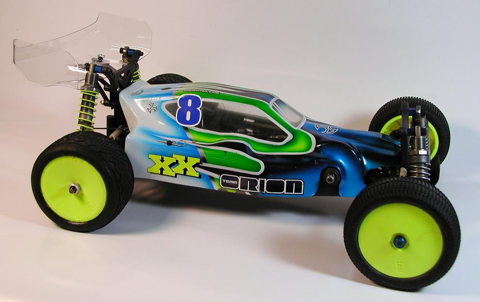

I recently sold mine. It was my primary race car for the last two years (before that i ran a XXX4). I would have to say that it is a great car, and absolutelly competative. In stock form the car needs allot of work. The worlds addition is a step up, but to be competative at a national level here in the states, there are allot of tweaks that are necessary. If you do end up getting one, I can give you a list of the things I did, as well as the setups I ran. I do also produce a few hop up parts for the cars, mostly to address some of the weak points. If you do end up getting one, LMK, as I have a few spares left, as well as some NIP hopups you should get. Here are some pics, minus some of the hop ups that I ran. -Jeff

Jay-
Does that 2nd pic show your xx4 with xxx4 front arms? I got a set off the ebay, and it looks like they'll maount right up. It will sacrifice a little wheelbase, but I'm lookng into making that up by spacing the rear hubs back, and maybe even modifying the rear suspension mounts.. What are those rear arms??? I've seen XXXcr or XXXBK VLA arms, but not with that many variable options...
Would love to know all your "tricks" on making the XX4 as robust as possible!

No, those are the std XX4 front arms. I looked at puting the XXX4 arms on the XX4, but they are shorter, and it would narrow the track width in the front. I thought about doing it, finding/making some shorter CVD bones, and running wide front rims and tires. I just never got around to it
I believe they are XXXcr rear arms, but I drilled another set of inner holes for the outer hinge pin. This allows the car to run flatter, and smoother on a rutted track. That mod in particular really made the car much better. As for the belts, I never had a problem. I ran a 5.5 for a long time, then went to a 6.5 because the 5.5 was just too much motor at my local track. I ran the car for over a year, and never replaced one. I was in good shape however, because the belts I have were relatively new (fresh) whaen I built the car. Older urethane belts can degrade in the package, and strip quickly -BTW.
As far as making the car "robust", There are a few recommendations:
Front hinge pin brace is a must.
White front bulkhead is a good thing.
One piece rear aluminum suspension mount is also very nice. I used the XX rear mount, but I believe the XXX rear mount will also fit, but would require different rear arms and settings.
Shock tower braces, and or the rear tower I designed.
I would also run a solid chassis if you can find one, as they keep the car cleaner, and won't crack like the light weight version.
Aluminum spindles are also good to have. XXX4 front CVD bones instead of the XX4 bones. They are the same length, just beefier.
And make sure you have the proper belts. -Jeff
