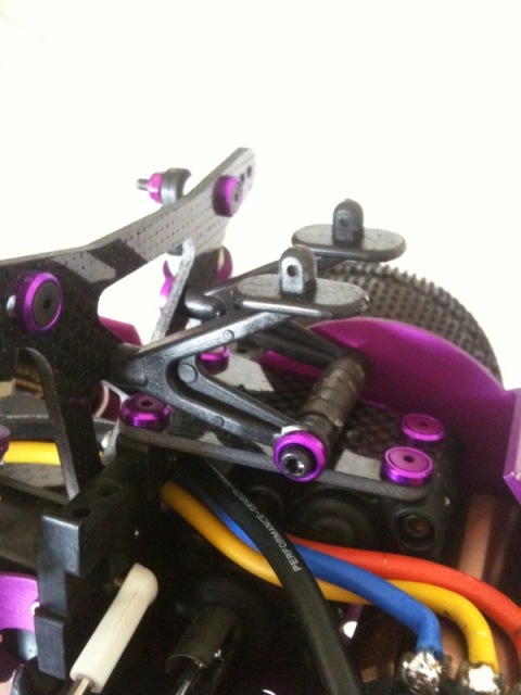

Jeff, one quick question. How are you adapting the B4 wing mounts? I see they are on all of your cars.
Mark

I drill 2 holes in the shock tower to attach the front of the mounts. Then I drill and tap the motor plate for a 4/40 screw. I then use plastic washers between the mounts so that I can tighten the 4/40 screw enough to hold the bottom of the mounts snug against the motor plate.

I use the shock towers made by Atlas. As those of you who use them know, they are perfect in every way. Although I am putting 2 holes in them, they have never cracked or broken as a result. With all the racing we do with our cars, we have had some pretty awesome crashes too. (we all saw the car killer jump) Even with the stress of the crashes, no problems.
My point is not to fear a reduction in structural integrity by drilling the shock tower.

On you B4 Wingmounts, I don't see any washer/spacers between the tower and the posts. I've got a B4 mount on my original 94CE tower and I'm either going to have to trim the wing down, drill different holes, or add spacers to the tower-mounting side. (luckily I haven't tapped the plate side yet!)
Also, I get (17yrs worth, they're all original) a lot of binding on the front suspension. Balls/cups are definitely the culprit. I've cleaned out the cups, even did some light grinding to the insides but they are still binding pretty bad. I've heard polishing with toothpaste as a recommendation for the balls, but any other suggestions short of buying new ball cups?

Quick tip on the ball cups. If your ball cups are definatelly the culprit this is what to do. With them mounted on the car and balls inside, give them (the plastic portion of the cup) a little squeeze with a pair of pliers. This will stretch the plastic slightly. this should free them up. No grinding, polishing, or even removing them. Fast and easy. Sometimes it takes more than one squeeze, but you should quickly get the hang of it. Be careful, and don't squeeze too hard as this will stretch them too much. -Jeff
