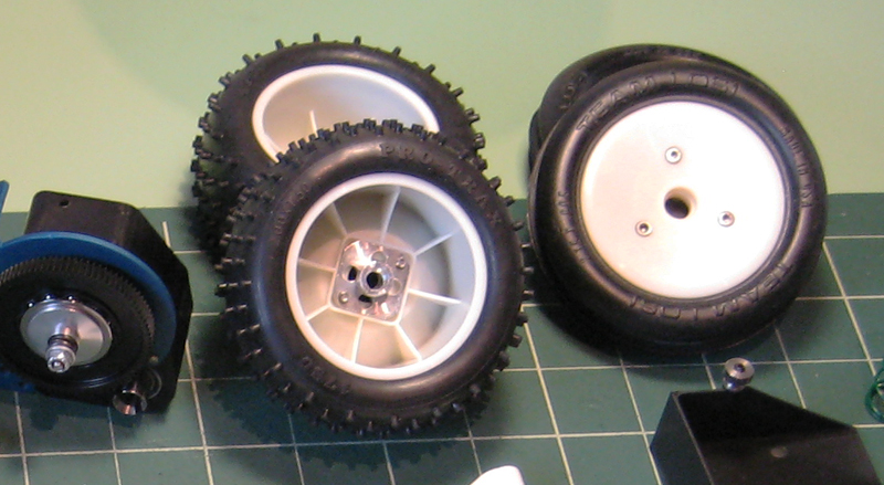

Got it build this morning, working on adjustments. The idea for the short rear shocks is actually awesome. I get full travel but with a shorted lower tower. I am working on version 2 of the towers so I can eliminate the spacer in the shaft and use a small limiter inside. The setup works great using the middle hole on the arms, it is very cool IMO.
The wheels are taking a peroxide dip this weekend and if sunny I will mount them up on Sunday.
I am waiting for some material to cut a rear motor plate and a battery brace. I am looking for a matching material to the chassis, taking suggestions if anyone knows where to get the material.
Tires:
I am going for some aggressive stuff up front (Losi center rib) and crazy traction in the rear.
When the Traxxas (Pro-Traxx 4750, buggy) Blue Eagle came out it came with these rubber and back in my home town the tires had tone of traction on the loos sandy tracks we had. On one of my searches on old Shops I found a 2.0 set for the buggy.
