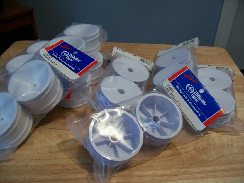

Well the duratrax rims look good but they break apart easily. So I ordered some rims from thundertiger4u.com. Was also told via e-mail from thunder tiger that they are nylon and dyable.

Re: B3 rims from thunder tiger
Those fronts look like B4. The white looks like the Chinese AE wheels, too. Not sure if they are really Nylon. If the rears don't fall apart like the Duratrax wheels, that's an improvement.
I have some. They seem a little more brittle than the standard AE or JC wheels. They are however, dyeable. I posted pics somewhere back some time ago of a set I dyed Yokomo pink. They are not tapered for the early axles. That can be accomplished with a body reamer though.
The original B3 rims are hard to find. The duratrash rims break. Did I waist my money on these ? Read that the Thunder Tiger Phoenix BX were a good replacement rim.
If you are using them for racing you did not waste your money, unless the Duratrash wheels were significantly cheaper. In the racing world wheels are pretty much a throwaway anyhow. Only us restoration geeks try to save old wheels, and that's only for shelf duty... My real concern was the front wheels offset, they look like B4 wheels. Perhaps the TT buggy uses the longer GT wide axles?rctenracer wrote: Did I waist my money on these ?
No, you did not waste your money. They are not on par with the current B4 wheels in construction material, in my opinion, but they are the only option. They aren't going to fall apart, but for heavy bashing I wouldn't be surprised to see cracking.
I picked up a set at my LHS on wednesday and noticed the same thing. A quick mock up on my graphite RC10 with 3/8 x 3/16 bearings, shows everything clears okay. They definitely have less of a dish than B3 fronts, and they're wider aswell. Similar width to the pro-line wide B3 fronts...templeofspeed wrote:My real concern was the front wheels offset, they look like B4 wheels. Perhaps the TT buggy uses the longer GT wide axles?rctenracer wrote: Did I waist my money on these ?

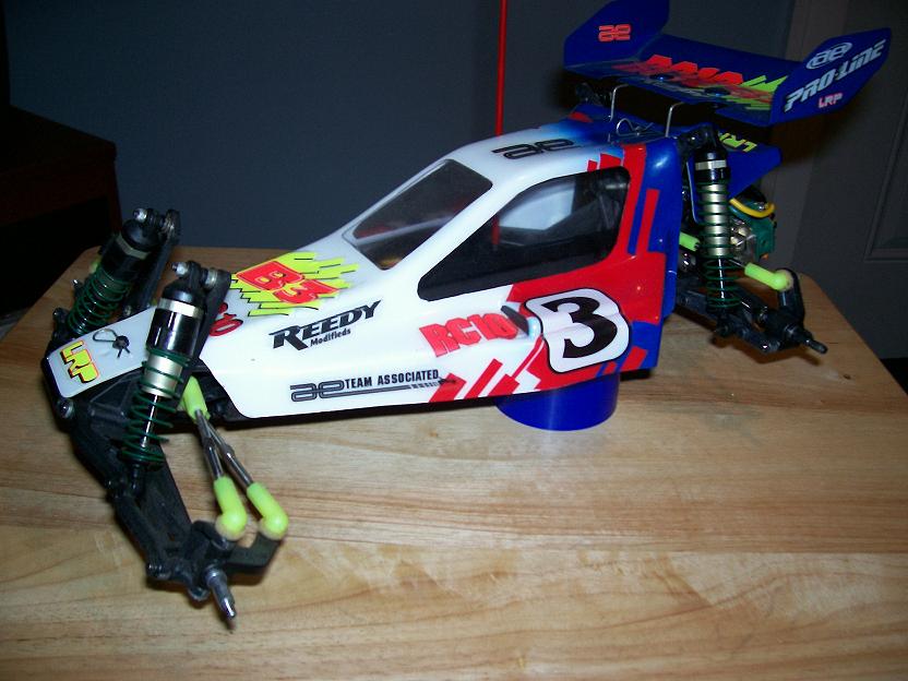

Well this is the car there going on. I have a set of new wide GT axles. I 'll just use the wide axles for the front rims .
Oh! I love the retro B3 paint job on that, nice job!rctenracer wrote:Well this is the car there going on. I have a set of new wide GT axles. I 'll just use the wide axles for the front rims .
