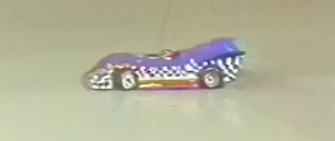

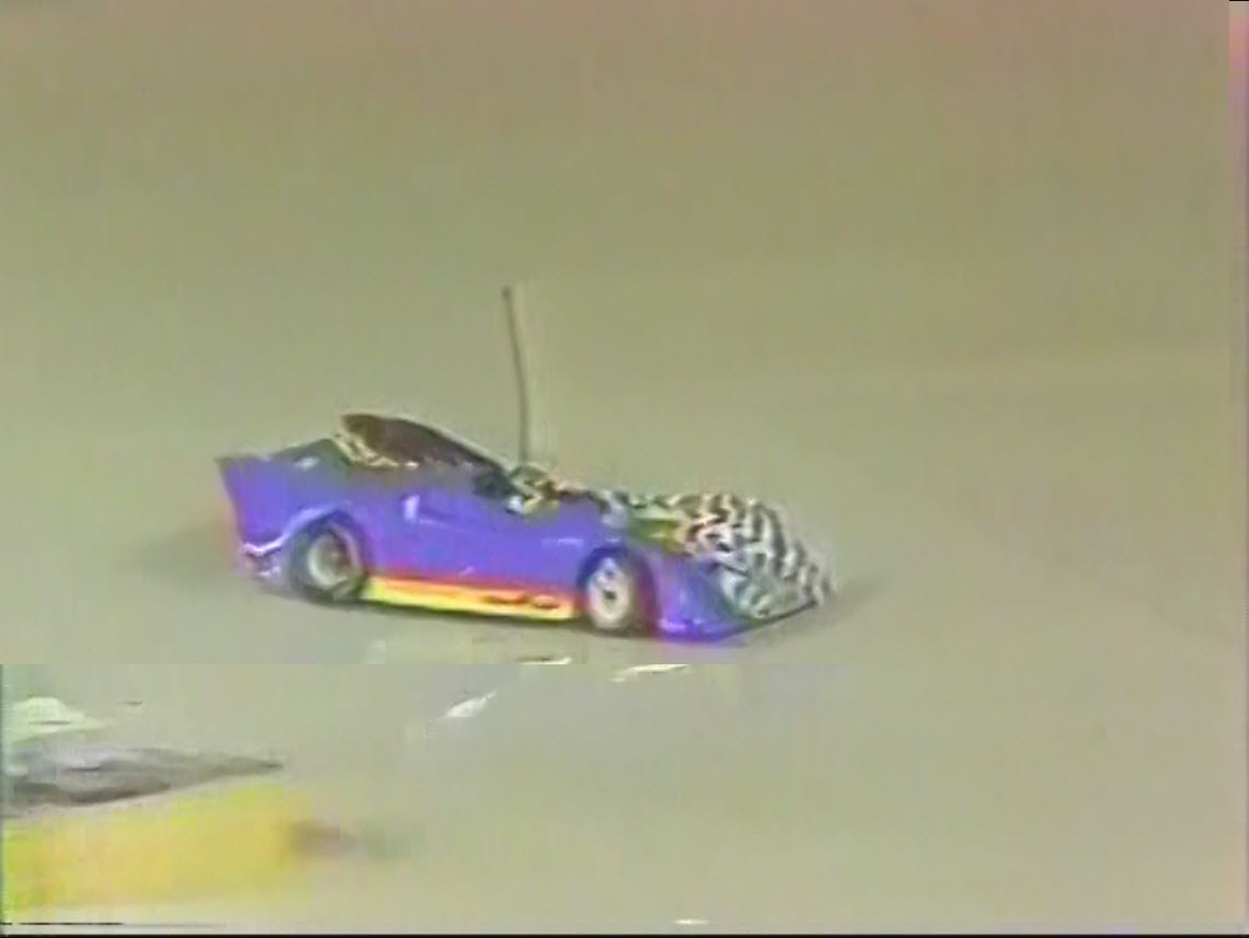

al is working on getting a shot of it.scr8p wrote:no different car. i don't have that snagit thing anymore to pull a screen shot of the 12th scale from the video.

Sorry, not the best shot but it does show the colors.

they're quite easy to do. just lay out strips of tape, let's say 1/4", in one direction, side by side. then take a piece of tape the same size, lay it down in the opposite direction. take a razor blade/xacto and cut down both sides. then lift that piece of tape up, and move it over so that the edge of the tape is along side of the cut you just made, and cut along the other side. keep doing that until the entire area is cut into squares. pull out every other piece to create the checkerboard pattern. spray your first color. pull off the rest of the tape, and spray the other. all done.bearrickster wrote:the checkerboard is going to be a nightmare to paint good luck guys I am not that ambitious
what curtis did was lay out the tape front to back straight, then cut curvy lines left to right. but it's still the same process.

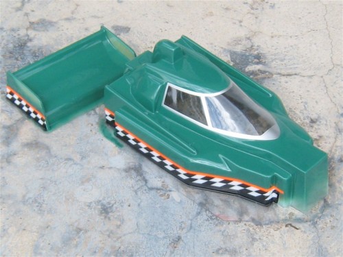

Damn it gentlmen.
Thanks to Ruffy and the honorable Husting clan, I have no choice but to dive into the deep end on this one. No turning back now...
Let's go SCR8P, time to step it up. Not gonna let you off this one. These are for you so you know what it should look like from other angles.
Just don't do like me and forget to back the blue with white before going onto the other colors
I just looked up your Cutlass SCR8P. That looks fun..but probably 100 times more time consuming these little 1/10 buggies. I'm impressed with guys that can do 1:1 projects (my dad is retired and is in the home stretch on a frame up resto of a 55 Pontiac). Especially when you see those tv shows with crews of guys and money and cash and even more guys behind the scenes. Whew!

The paint is amazing. I don't think I have the patients to mask that much.
- Y'ernat Al
- Posts: 920
- Location: Spokane WA
- Has thanked: 7 times
- Been thanked: 17 times
Re: "Edge" Saved and Headed for the Back Page
A little bleed in a couple places, and I had to do some damage control at a couple points in the process, but I'm fine with it. I didn't keep track of the total time invested, but let's just say I lost count of the Sportcenter episodes, considering how they run them back to back

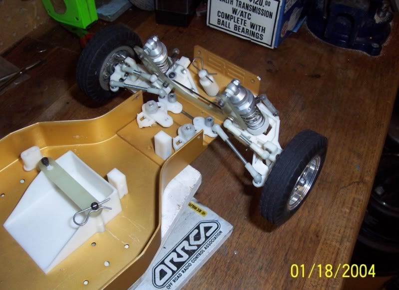

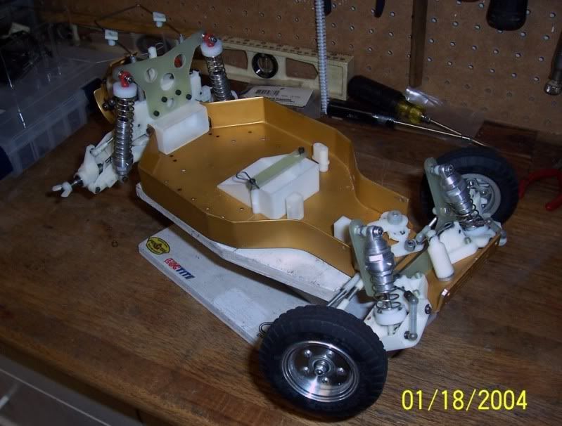

Jake hooked me up with the proper shock hardware so it's coming back together now. I can't bring myself to dye anything black, but I think a few details based on the box art and other first cars are appropriate, notice the shorter-than-usual sway bar connection, etc...
The steering setup with the wing-wire and collars between the two servo savers is actually a decent idea for these old servo savers that don't have that little lump of extra support for a ball stud like the later ones did. It operates really smooth and doesn't scratch into the nose piece like the (slightly too long) ball studs always do...
(The hunt is on for rear wheels and more decals. And I've got a growing list of parts that could use a gold anno dip.
