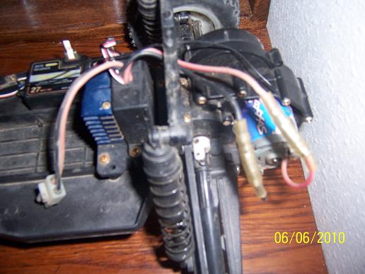

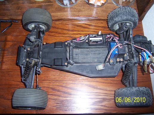

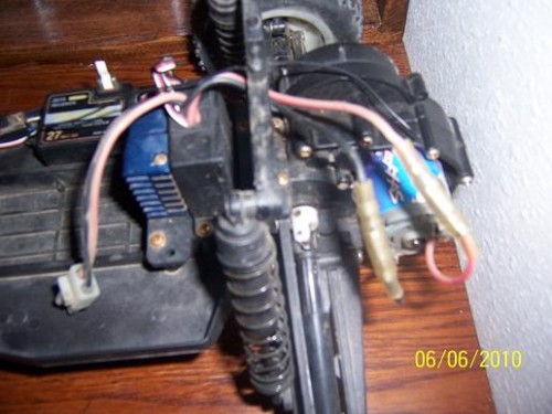

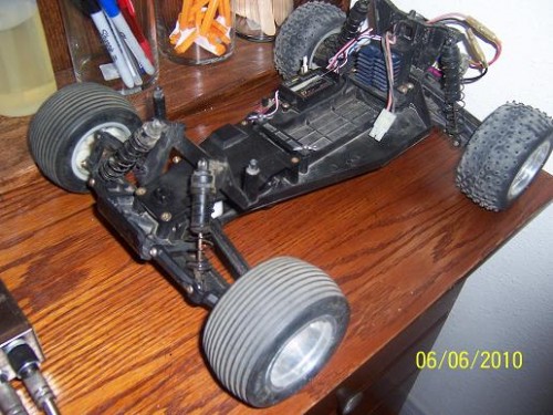

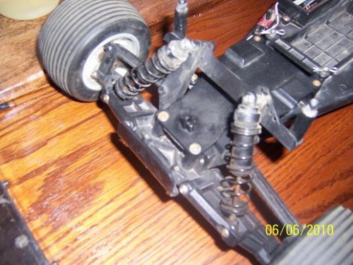

jus picked this up at a yardsale for ten bucks i hooked up a battery and put in a reciever and it ran like new well almost the steering servo was a lil dry so i tore it apart and re lubed it...im jus curious if anyone can tell me the year and model...or about...thanks for your help

that is a rustler, I agree with the late 90's as the likely timeframe based on the electronics.

I'm gonna say mid 90's,possibly late 90's.Your truck has the xl-1 speedo,so it is one of the earlier releases.They initially had an msc,then the xl-1,xl-5,and the newest vxl brushless version.Fortunately all the parts are still interchangable between all the Rustler models.Most of the newer trucks use gray plastics for the chassis,trans cases,bulkhead,etc.Aside from that,the only thing that has really changed is the electronics and the newest xl-5 and vxl models use all steel internal trans gears and the Revo-style slipper clutch.
