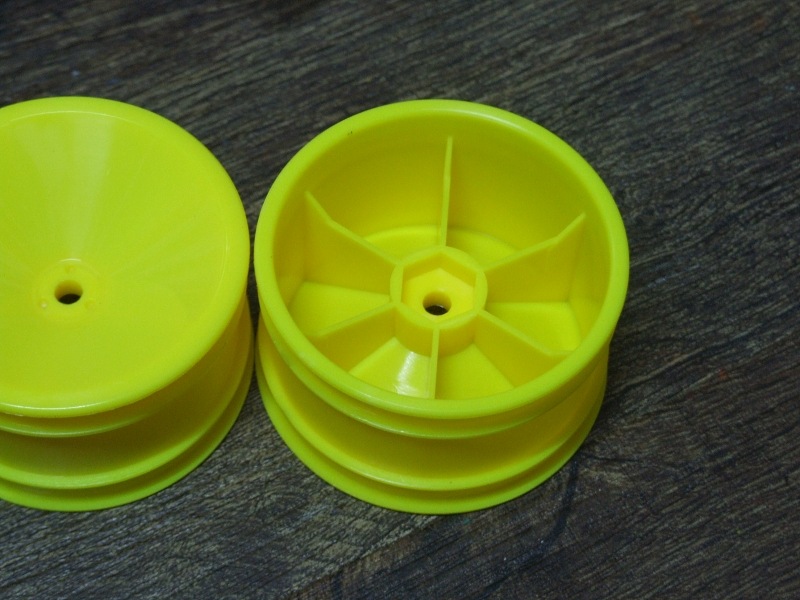

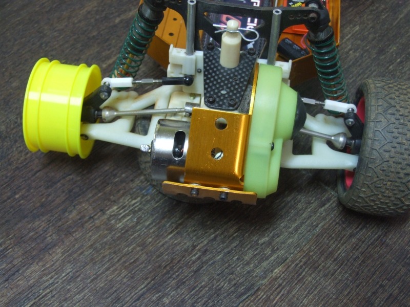

I found the wheels at my LHS and they seemed to have right offset for RC10 and later B2/B3.
parts # is Hongnor TM-49Y or Ofna #40849 wheels for CRT.5. and just checked they are listed on ebay also

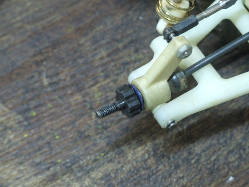

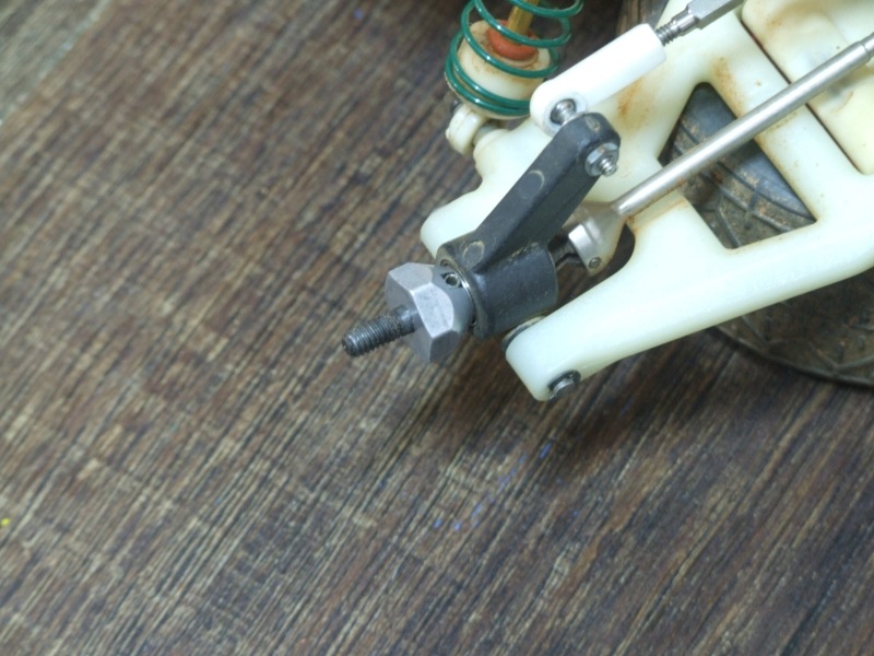

offset is perfect with HPI hex adaptor. and TC3/TC4 wheel hubs worked for 3/16" alxes

the offset, width, and diameter are indentical to B2/B3 wheelsJay Dub wrote:How wide is the rim? Thanks -Jeff
my calipers are saying the width is 35.5mm (1.4")

The problem I had with them was the yellow doesnt quite match AE yellow, and the axle hole is quite a bit larger than the axle, and if you arent careful putting them on, the wheel wobbles.
Maybe it was the cheap hex adaptors I used, those alloy ones you posted look really cool.
