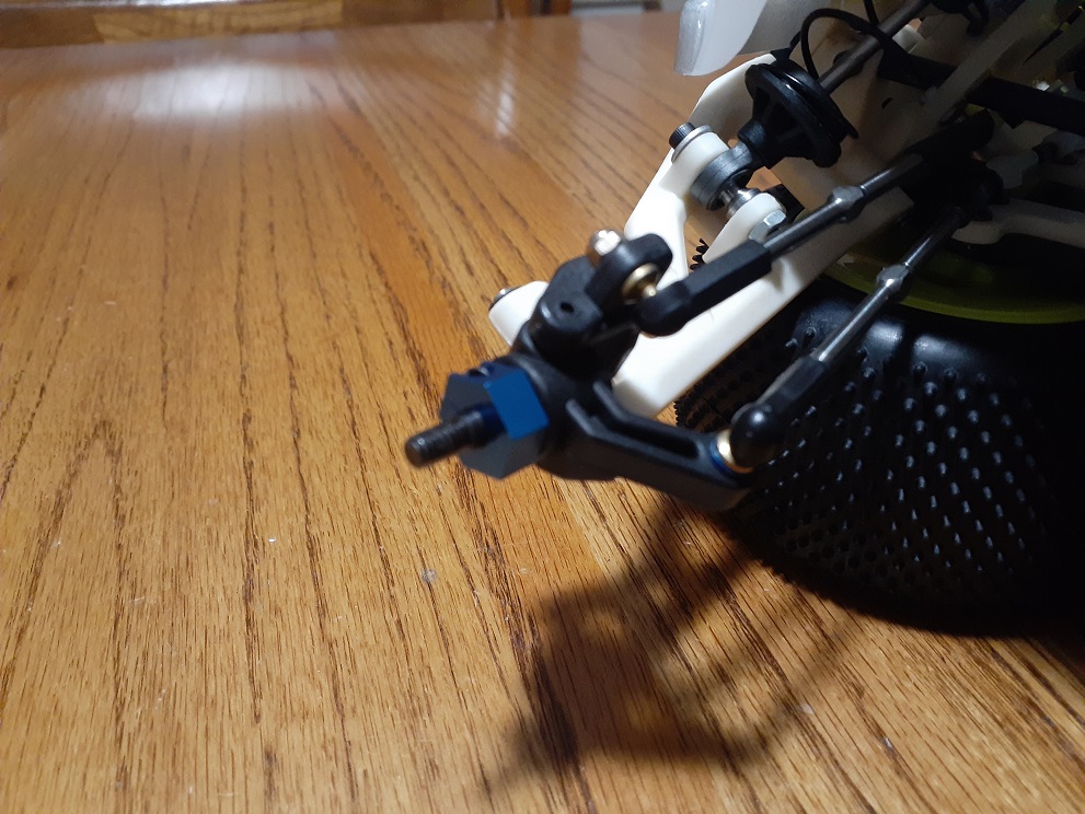

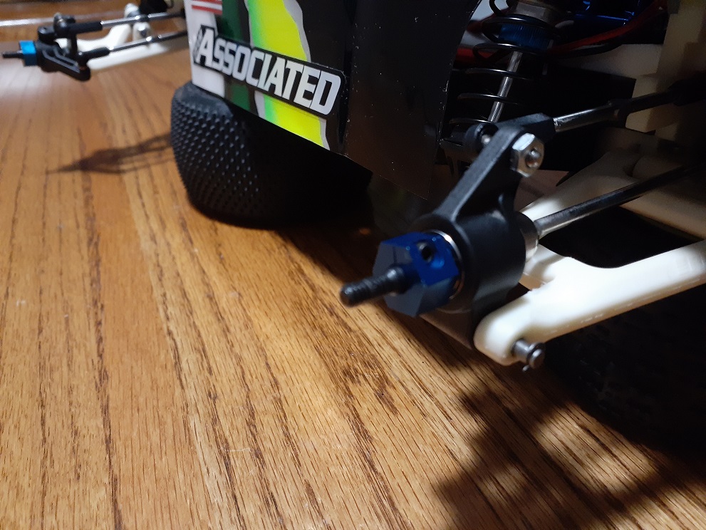

Here is a pic of my RC10T using the B4.2/SC10 front setup and Associated rear hexs #9892. If you have 1/4 axles with dog bones you can get #9670 axle stubs from amain along with bearings, shims CSW7048, pins CSW7204, red orings 5407. I used JConcepts Mono wheels .
