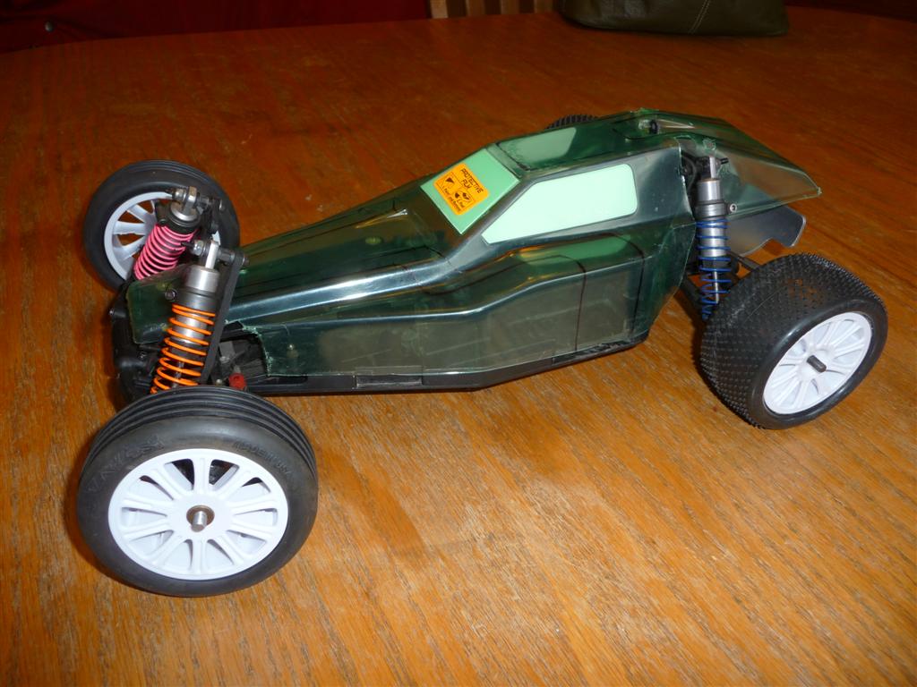

Mike, here's something I was playing with a while ago - It's an XX body and Rulux rims on a Junior 2 chassis. This body wasn't cut for this chassis but you can see that it should fit. I "think" the Rulux wheels fit but I'll have to dig them out again to see for sure.

That looks sweet Gary. I have a new composite craft front SE tower so i will need a stock SE rear tower if someone has one. Thanks for all the quick replys.

I'm digging those Rulux wheels, might have to set up an ebay search lol.

paNX2K&SE-R wrote:I'm digging those Rulux wheels, might have to set up an ebay search lol.
???? Those are still available brand new from J-Concepts
yup, usually sold in packs of 4, a bag of 4 fronts and a bag og 4 rears. ebay's a great place to buy them though. cheap w/free ship.

I like those! Are they Rulux B4 or B44? I see both on Ebay. I am in the process of building a racer Jrx2 and was planning on B4 wheels but these look great.
