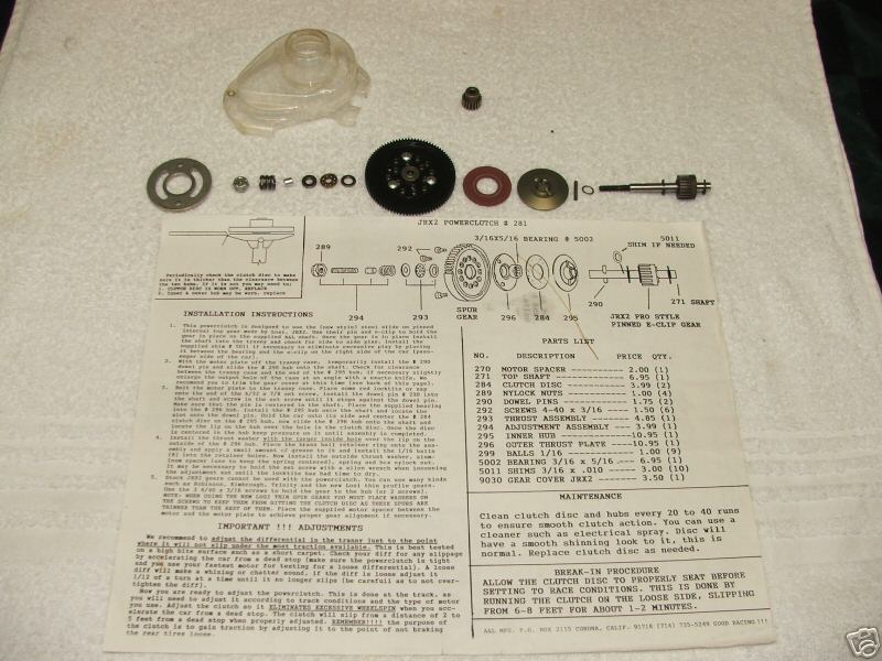

Anyone know the size of the nylock nut (A&L No. 289) that fits this slipper? I need some new ones...
Thanks :)

The Fuhrer wrote:I'm under the impression LOSI A-6302 5-40 nuts will fit.
Nope. Have a new package of em and tried one, no go. I thought that too and ordered some, but no go. HELP! :o
Seems like the long set screw on the A&L is a different diameter or thread pitch than the Losi long set screw included with the A3120 shaft.

They are 6-32, 1st line in instructions say to put the 6/23 set screw into the top shaft of the tranny. Our Power Clutch for the losi Tranny comes with a new top shaft drilled and tapped for the 6/32 set screw.
Sorry I did not answer sooner have not been here in a while. You guys are more then welcome to e-mail me your tech questions.

Daryl Lane wrote:They are 6-32, 1st line in instructions say to put the 6/23 set screw into the top shaft of the tranny. Our Power Clutch for the losi Tranny comes with a new top shaft drilled and tapped for the 6/32 set screw.
Thanks so much Daryl, I think its great that u are a contributor to this site......I couldn't read the instruction sheet cause it was too small a pic on here, but I could make out the parts list. So they are just plain 6-32 steel nylon locknuts? Sweet.
