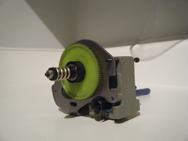

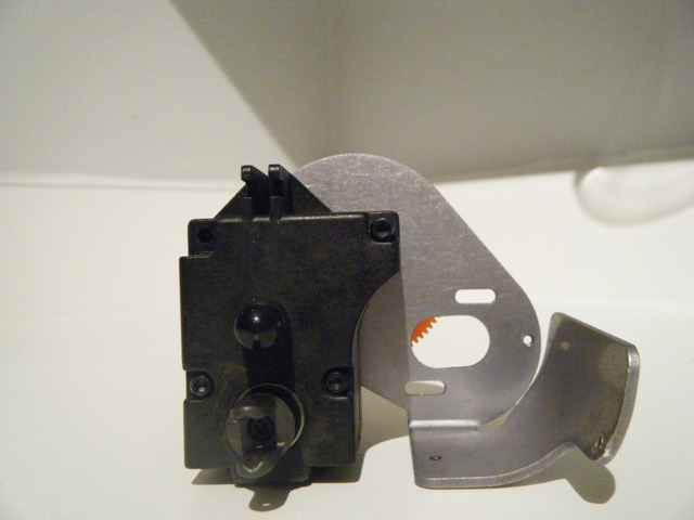

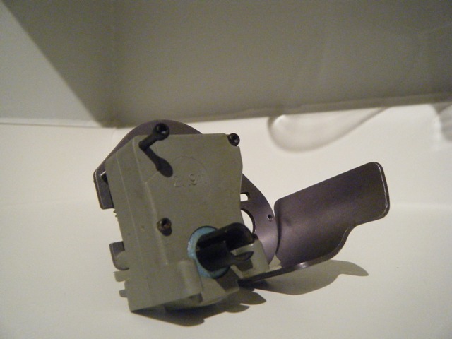

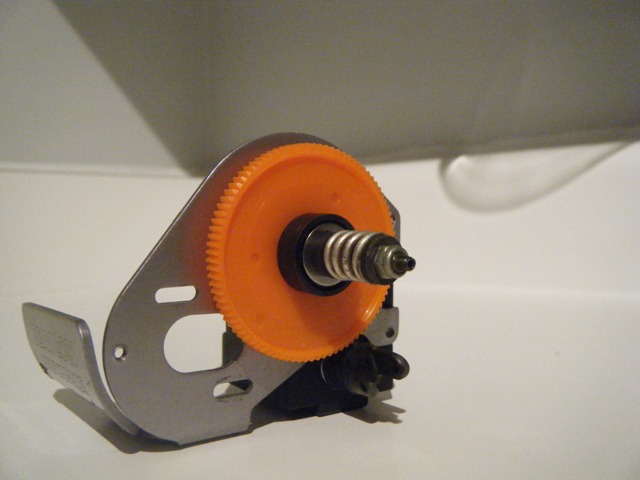

This is the LRM, low rotating mass transmission. The slipper clutch is an upgrade and would not have come with an X2 originally.
The next two are the retrofit transmission.
I like the LRM, I like the diff in the middle with the access hole for easy adjustment, I think it was pretty innovative.-
