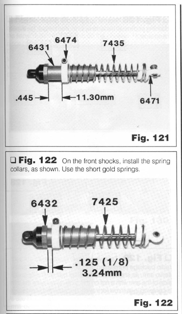

Separate question -- I'm trying to get the ride height in the front dialed in, but I think the springs are too short for the shocks. Does anyone the correct length of the springs on the front the truck?

Are you sure about that? The manual has different part numbers and refers the front springs as short.

nope not sure. I guess they make shorter front springs for truck. So that means you could have three different spring lengths to figure out. My bet is you have buggy springs up front then.

Here's a thread with the Associated spring chart (thanks again Jeff!).
https://www.rc10talk.com/viewtopic.php?f=29&t=38431&p=431514&hilit=spring#p431514
