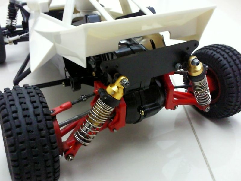

Regarding upgrades, I would suggest upgrading the motor to a 540 can motor with a Hornet motor mount setup, and replacing the rear pogo stick shocks with the Hornet oil shock setup. You'll have to get the re-re Hornet oil-filled shocks from the Hornet kit off ebay, shock mount brackets, and one of the Hornet parts trees (sorry, can't remember which one; I'll look for it and edit my post).
If you're going to run it on any other off-road surface besides sand, I suggest adding some small weights to a spare Hornet/Grasshopper front tire and wheel combo and attaching it to the rear Grasshopper body cage. This does two things, first it adds to the scale looks (if done right) and second, it adds some weight over the rear suspension so that it actually works a bit.
Finally, if you really want to go all-out, you can add a CRP FX-10 front suspension kit (on ebay). This gives you a double wishbone suspension and the ability to add oil shocks. It does make a big difference on the front.

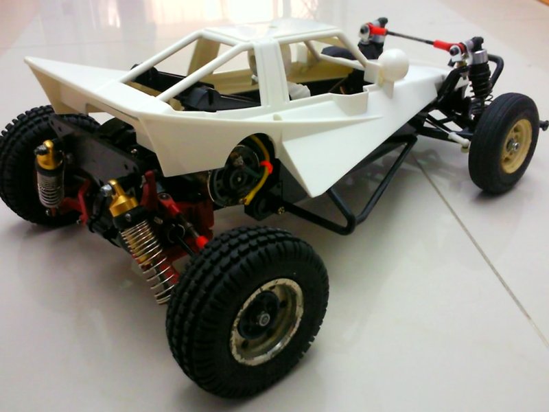

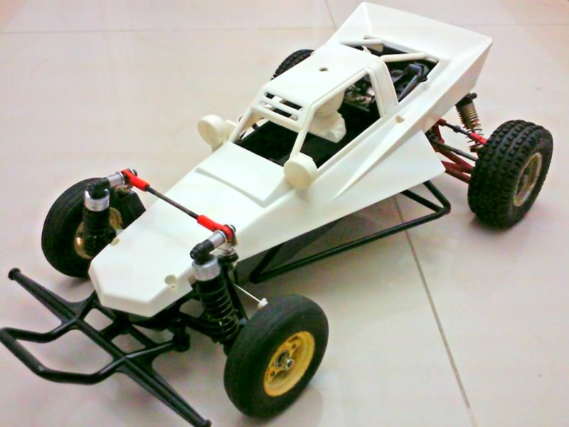

Not that this is a great deal of help in terms of telling you where to get the mods. However, it is the best example I know of a hopped-up Grasshopper - this guy makes some incredible cars: http://www.tamiyaclub.com/showroom_model.asp?cid=60259&id=418

I wish that dude would either make me one or sell me his. My favorite RC car, ever. Anyways, pastimesteve has hit the nail.CNA75 wrote:Not that this is a great deal of help in terms of telling you where to get the mods. However, it is the best example I know of a hopped-up Grasshopper - this guy makes some incredible cars: http://www.tamiyaclub.com/showroom_model.asp?cid=60259&id=418
