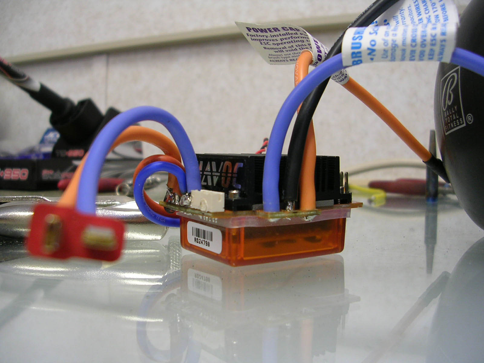

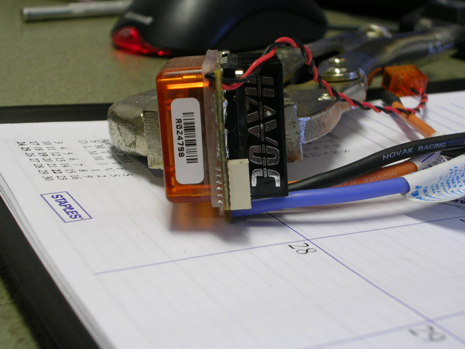

I don't have a drill with me, so that's out of the question anyway.
I managed to use the Dremel and reduce the solder on the bottom side. The solder on the top side is mine, so the will be easy to clean up.

Re: Getting the factory wires off your ESC
Well...I still couldn't unsolder off the bottom
I just cleaned it up a bit and changed how I soldered them on the top. Only a couple of unwanted melted spots, lol
I let the iron heat up properly, even used a new tip. Tinned it every time and still couldn't melt the type of solder Novak used. My soldering iron is a Team Checkpoint 950 and is quite new.uzzi wrote:Let your solderig iron heat up adequately then apply some solder on to the tip to tin it. Only then do you apply the tip to the joint...this will enable the heat to transfer better. As someone mentioned earlier ensure your soldering iron tip is clean prior to using as well.
It was a learning process, because I will likely not change out the wires again on another Novak esc. I did this on a Tekin esc and it was as easy as an old man at the bunny ranch. And the Novak was hard, like that same old man at the bunny ranch.
