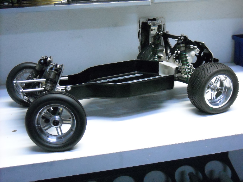

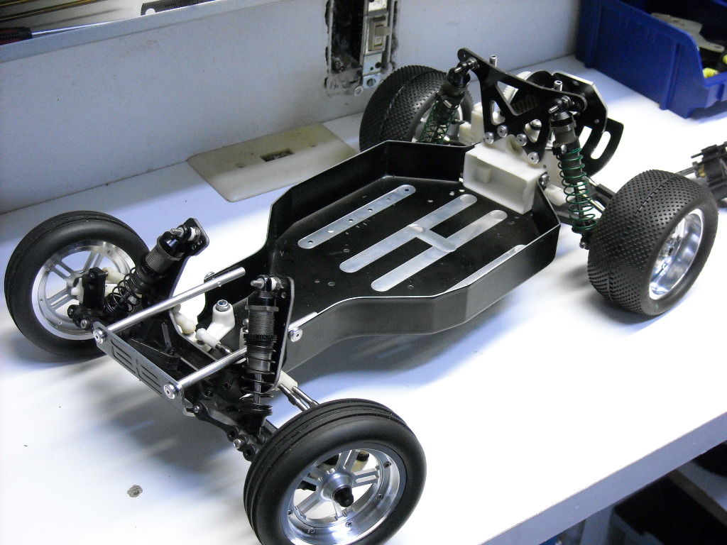

greene-r74 wrote:
greene-r74 wrote: What are you guys spacing your front wheels with? Also are any of you using the rings to make the wheels wider?
I'm quoting myself cause I still want to know. :) The front wheels need some sort of spacer on the back, are you guys stacking up washers? or putting an extra bearing back there.
Quote of a quote of a quote. This time with a picture. :) I really want to know what everyone is spacing the front wheels with, are you putting an extra bearing behind the wheel??? washers???, Bushings???? something else???? Are my wheels the only ones like this? Also what about the spacers to make the wheels wider. Anybody using them? Using them on the front? Using them on the rear? I didn't use any and can only get these 2 row spikes to look good on them.

:lol: :lol: :lol: :lol: a picture is worth a thousand words or in this case, a few quotes.
that should do it.

greene-r74 wrote:
I use one additional bearing to fill the spacing for my rc10 front wheel. :oops:
