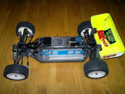

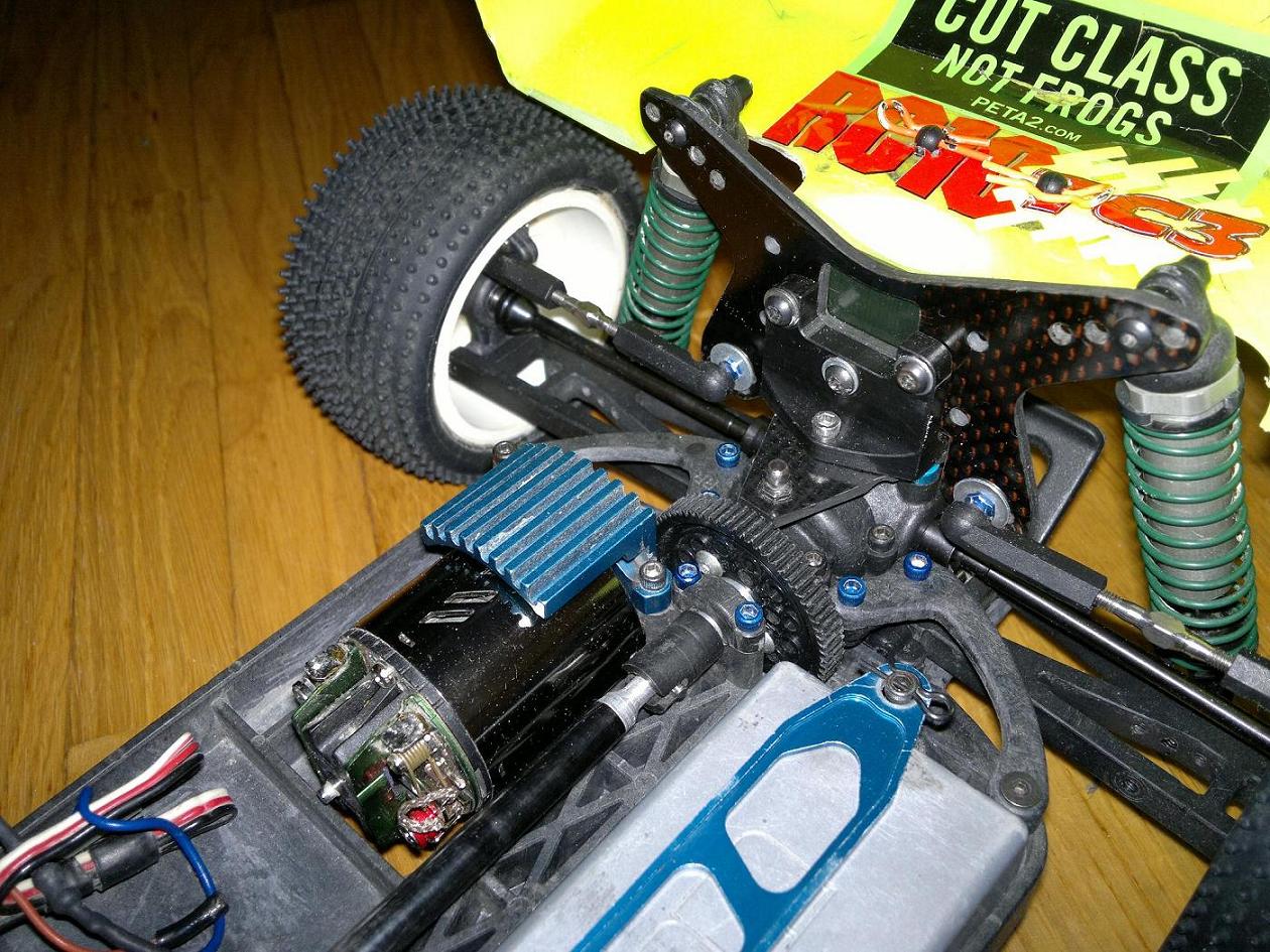

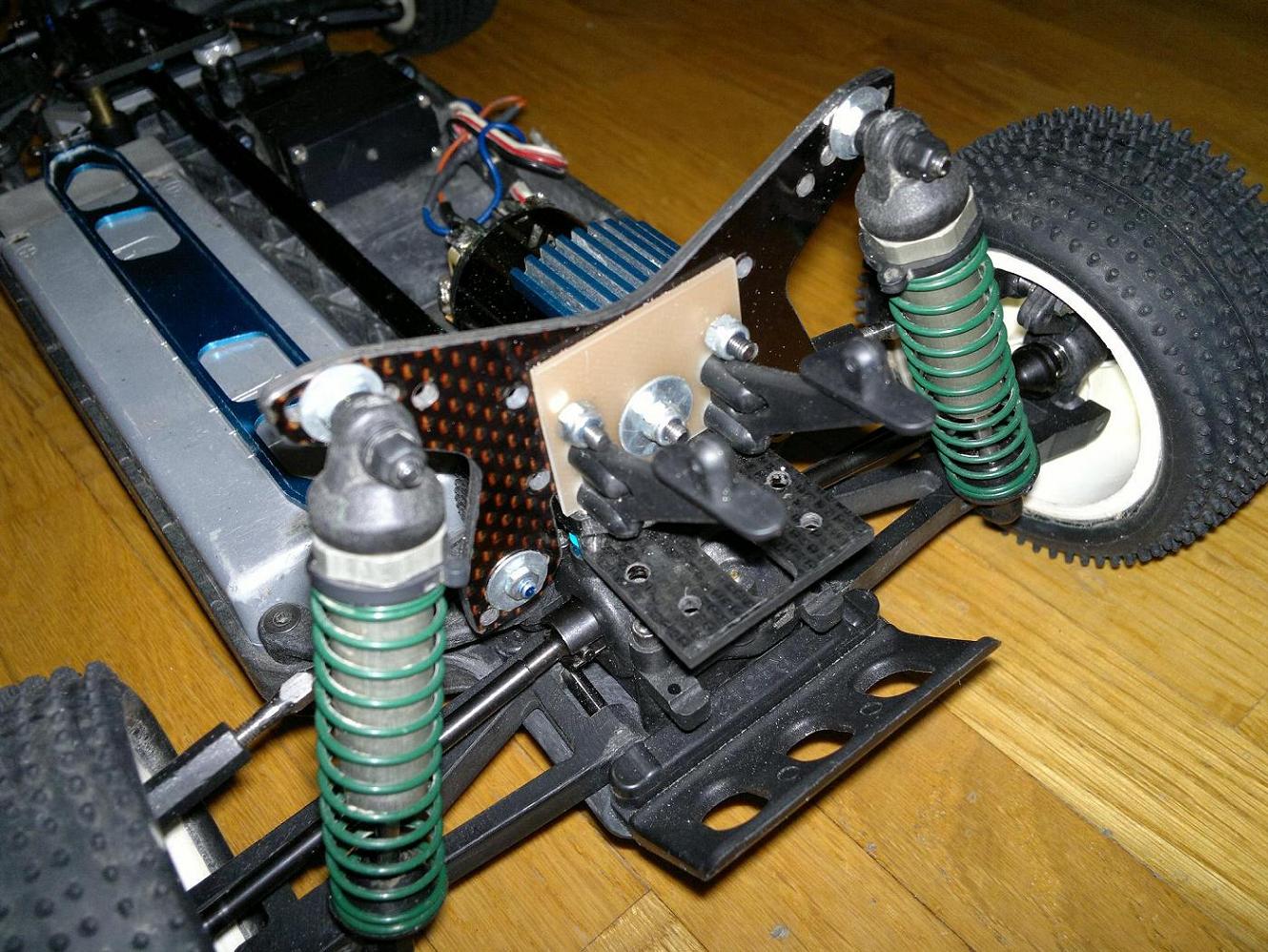

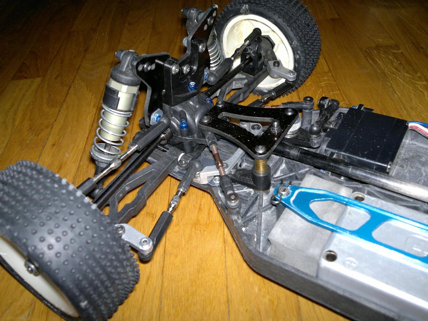

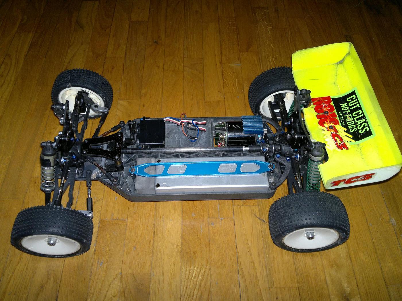

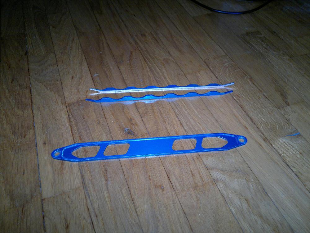

At last some updates !
The car is still not quite finished but I'm confident I'll get there eventually. I have this tendency to try and improve the areas where I feel it's needed, although it will take hours, not necessarily be pretty, and I may use the car for like 5 battery packs in the next 15 years. But hey, I can't help myself, and it's also one of the reasons why I seem to take enjoyement in this hobby. On this particular car, a lot of things needed to be adressed and even when they are the car won't be great. But as a TC3 owner, well, I kind of had to have one...
So here's a list of what I have done so far :
- Massively lowered wing mounts with Kyosho #LA213 items - thanks for the tip M-vice ! ( the stock setup uses Losi ones and make the wing sit ridiculously high, forcing you to use RCPD's own lowered and ugly wing) I will eventually make CF part but for now it works perfect.
- Lowered front transmission case allowing the center shaft to work flat
- Lowered hinge pin mounts to lower the front roll center (stock setup is just absurd)
- Optimized front shock travel ( up and down) and spring preload ( long rod ends and HPI spring retainer)
- Much improved rigidity at the front of the car by adding 2 side rods
- improved flex at the rear (stock version is stiff as a brick, a problem well known by TC3 users)
- slightly improved steering geometry-though there is still work to do (I.e. bumpsteer management + overall steering throw still insufficient)
- Lowered front CF plate ( gets rid of unnecessary spacers and looks better, also allows the body to sit lower)
- Ground down battery bar ( to lower the body)
- Aftermarket ( unknown brand) lowered motor heatsink ( guess why)
- Lowered body ( by almost 10mm ! I still need to cut the excess on the body)
To-do:
Install a CF nerf bar between the front CF plate and the rear CF plate that I added ( it's a piece of a broken B44 upper plate that I found in the trash bin at my track ) because the longitudinal flex is still way too high and there's a risk of bending the center shaft in that case. The previous owner has already bent it a little (GRR) and though it is still usable, eventually I'll make a new one.
-Improve the steering for good.
Any comment welcome !
