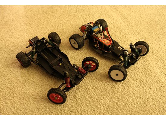

Here's a picture of my 2 JRX's without the bodies on. The one on the left is the evolution from my original 1988 car. The one on the right is the new Pro I just built from parts. New bodies are next. I'm running a hacked up RC10 body on the Pro right now.

The white wheels on my Pro are B4 wheels. The rears are just bolted right on. I have RC10GT wide front axles to give me the front offset. That's all I've done. Track width is just barely under the ROAR maximum front and rear so it's perfect. I had a set of the Duratrax wheels but they were narrow and too fragile. I gave them away to a friend.
All of my slipper clutch parts came in today. I am using the Losi hydradrive top shaft with all B4 slipper parts and spur gear.
My shocks use the XXX shock seals but with a twist. I threw out their o-rings and am using x-rings instead plus very liberal amounts of AE green slime. No problems at all. The springs are also the current springs (non big bore of course) and the shock collars are as well. They are very smooth.
The JRX on the left in the picture uses a Pro-SE front end, Junior 2 chassis, and JRX2 rear end and 5 link suspension. The gearbox is the original one with an early Losi friction slipper but will soon go to the Double X retrofit with a more modern slipper. The shocks are the threaded body type and the seals were built the same was as those in the Pro. It's the only way I'll build a shock anymore, regardless of whose shock it is.

I got the slipper installed last night. Hopefully no more stripped diff gears. I used the hydra top shaft with the B4 plates, pads, and gear with the Losi spring assembly. It looks just like that picture. I did have some issues until I saw an old manual that stated the gearbox and backplate had to be drilled out to clear the rear slipper plate. All I need to complete the Pro is a new body and gear cover.
