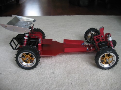

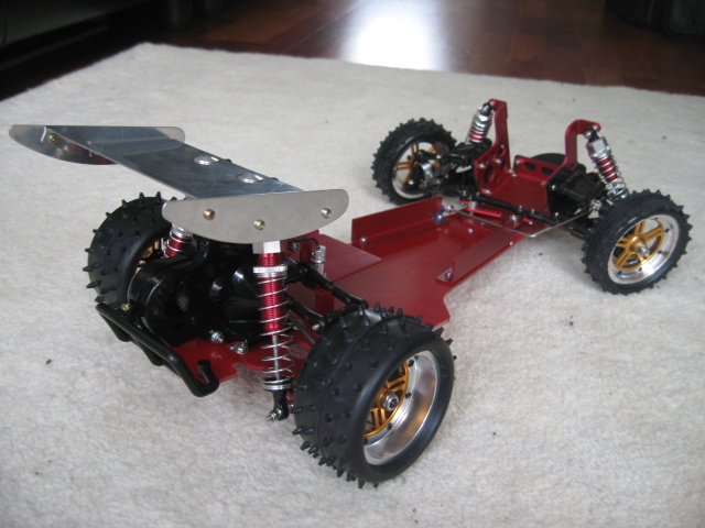

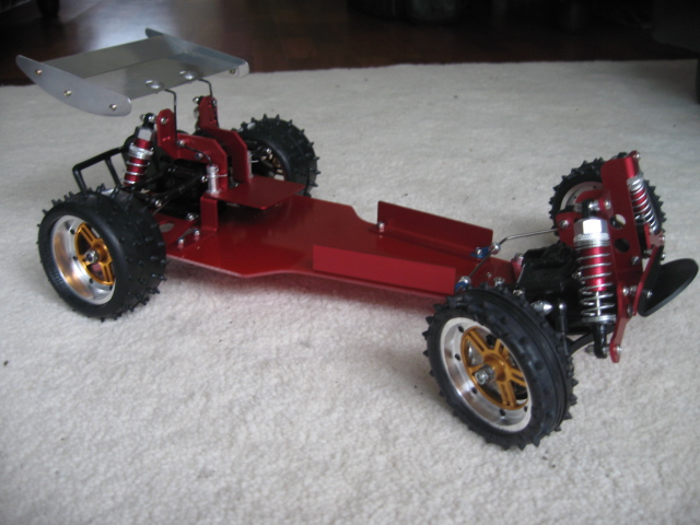

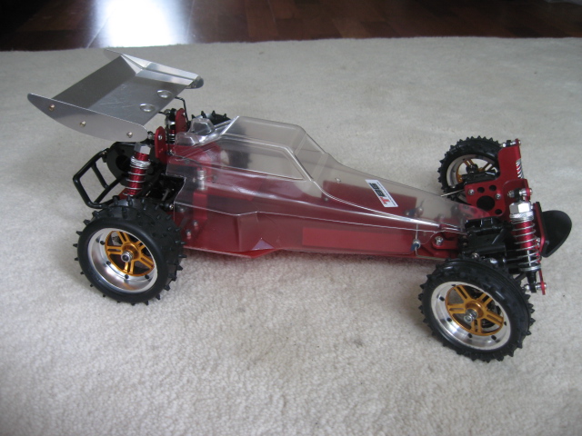

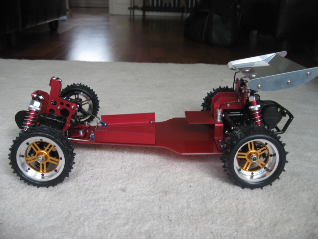

A further update on this build. I've managed to dig out and fit my original NIP RC10 dog bones to the drive train. I've also sourced the correct size of bearings to fit a set of gold five spoke Lohas (bearing size is (flanged) 5mm x 8mm x 2mm, if anyone is interested). The rear tyres fitted are new Schumachers which were available at the time the fox was released (Schumacher still make them, thankfully). The front tyres are new and made by a company called "Dynamite" - these are also original fox tyres. And to top it all off, I've used my NIP Tecnacraft quick release wing mounts for the purposes of fitting the new Dirt Burners Fox aluminium wing. I have an original new Fox shell to fit but want to do a dummy run with a TBG version first. The TBG shell is currently in the post so fitting will have to wait until it arrives.
To those that are interested, I hope you agree that the buggy is really starting to take shape now. I'm really rather pleased about how it is starting to look. Worthy of a "modern classic"?

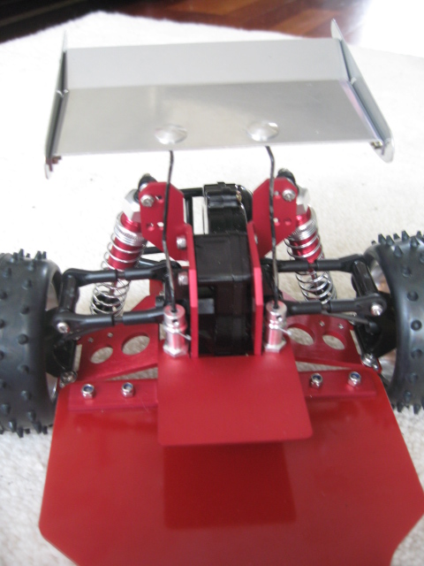

A close up of the Tecnacraft Wing mounts....:

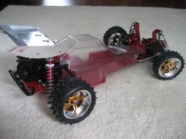

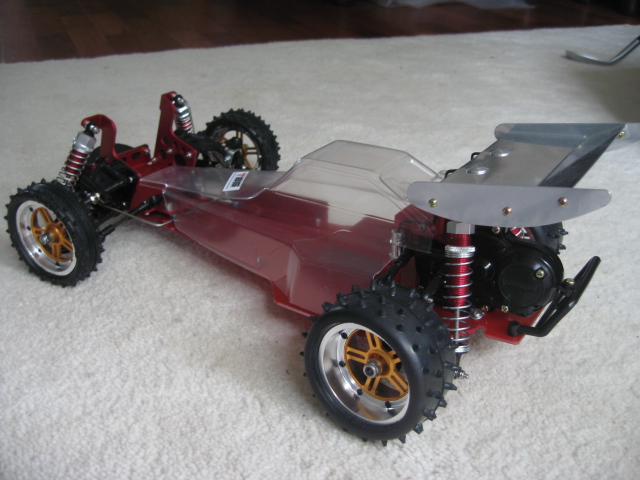

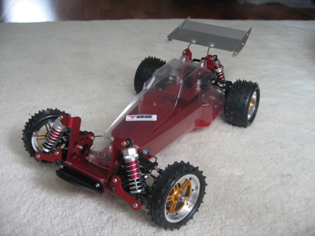

So I received my TBG Fox repro shell this week. The quality isn't bad - it's not as good as Mr Lexan's but it will certainly do. I spent this morning cutting it down to fit the chassis (it still has the outer paint protection film on for now). I'm not a fan of the Red Fox shell and I reckon the original looks a lot better on the chassis. It maintains the sleekness of the Fox, which is so characteristic of the car. There are some pictures below with the shell fitted. If I were to run the car, I'd use velcro strips along the chassis side brackets to fix the shell too. Additionally, it would be necessary to drill an extra hole into the centre of the chassis in order to fit a body mount. Quite an easy job and I have a new set of the Parma Fox adjustable body mounts which I could use. However, I'm still debating whether this car will ever make it to the road.
When photographing the car, I was struck by just how competitive and race-worthy it looks. I appreciate that I have various hop-ups on the car, however, they are all period Fox hop-ups so are totally in keeping with the times. The Fox was released in October '85, I believe, and when compared to its peers in that year I really think the Hot Trick Fox chassis design was very innovative and forward-looking. To me the design looks like it is at least 2-3 years ahead of its time - it would fit right in with cars which were released in the late 80s. Perhaps it is arguable that it looks more advanced than the RC10 gold pan in that respect. Certainly, it is a credit to Hot Trick even though some of their designs were very questionable. I would certainly be interested to hear others' views about other cars that were released in '85 (or earlier) which resemble such a race-worthy forward-looking design (RC10 gold pan aside). Personally, none spring to mind.....

Thanks for the comments, Emerson. The standard Fox shell fits fine over the chassis and due to the pre-cut mould having the expanded sides (which you don't cut for the Red Fox) there should be no problem with fitting a battery width-ways either. The only creative part is securing the shell to the chassis. Velcro strips on each side should help considerably but it will be necessary to add custom mounts via additionally (drilled) holes in the chassis. They won't be noticeable though from the outside so should not impact on the great looks!

Small note: Your rear lower shock mounts are supposed to be on top of the arm and not hanging below the arm.
