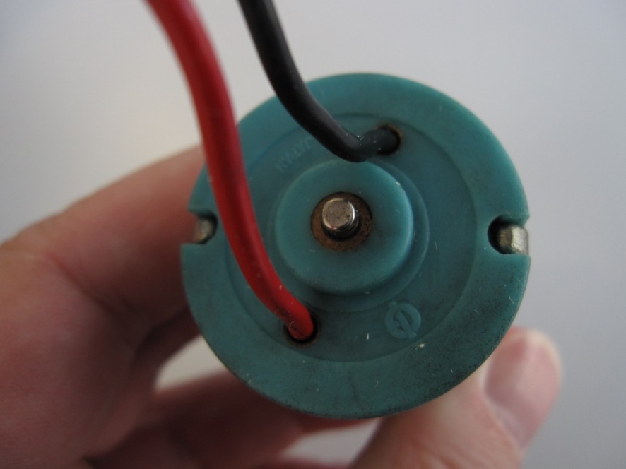

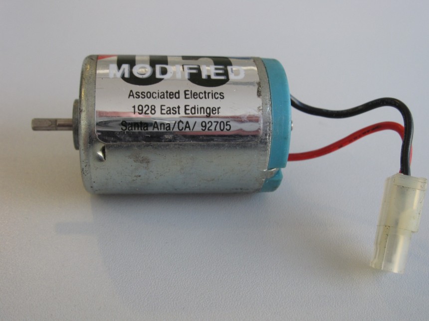

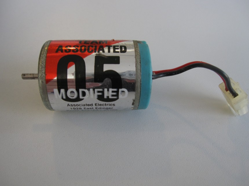

These are pictures from my Reedy 05 Modifid motor. As you can see there are bushings and the endbell is clamped.
One thing I didn´t notice before there is a flat spot at the motoraxle.
