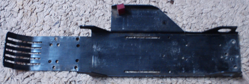

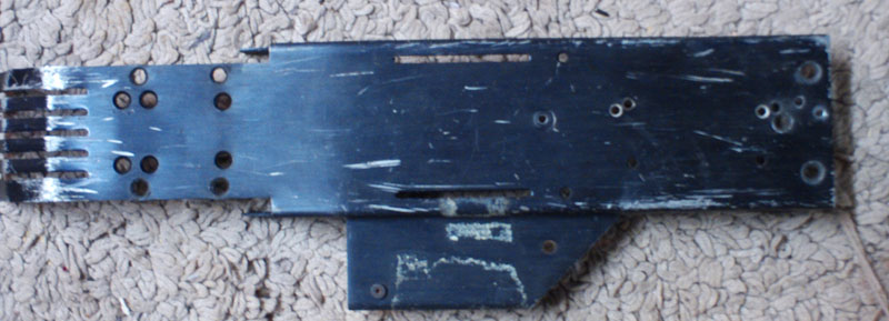

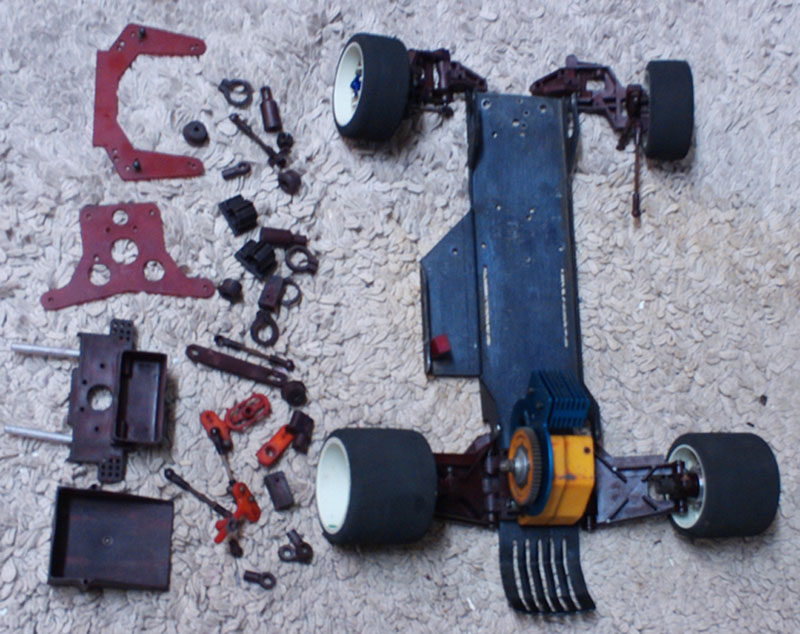

I recently purchased a rc10 that was built as a sprint car. The nose plate is off center (not in pics), and the aluminum chassis is an aftermarket brand that I am not familiar with. My plan is to rebuild the car like a DS with a home made carbon fiber chassis, custom front and rear suspension mounts, and a mid motor mount. Here are my questions...please help.
Does anyone know who made the chassis in the pics?
Any good tips for mounting the motor as a mid mount?
Thanks for any help...
Posts: 16816
Re: rc10 oval / sprint car questions?
BME made it.
mid motor...... not "nicely" on that chassis.

With creative battery mounting and bracing, you can run a mid-motor setup on the BME. I was experimenting with some loose cells on mine, and you could run a 5-cell with the sixth on top. Or offset saddle packs. You could also fit stacked saddle LiPos or stand them vertically. :wink:

Thanks for the heads up on the chassis name, now I know what it should look like assembled, I am missing the support rods.
As far as the mid motor mount, I completely overlooked battery placement. I am going to have to rethink things, thanks.

necka wrote:Thanks for the heads up on the chassis name, now I know what it should look like assembled, I am missing the support rods.
Depending on how small your servo is and how you mount it, you probably won't be able to fit a 6-cell pack with the mid-motor setup. If you eliminate the steering bellcranks and run the tie-rods directly to the servo like a pan car, you might be able to squeeze one in there.
And for the chassis braces, just buy some K&S 3/16" .049-wall tappable aluminum tubing and 4-40 tap and make your own. I've made three sets so far for my BME chassis using originals as a pattern.
http://www.hobbylinc.com/htm/k+s/k+s3060.htm
Once you have the nose screwed to the chassis, just make a mark at the front side mounting hole where the tube needs bent. Then use a vise and bend it slightly, and check the fitment. Once it's bent correctly, mark the two side holes and drill and tap them along with the hole on the end of the tube. Make sure to bend then drill because the front hole is right at the bend and will break...ask me how I know. :mrgreen:
Hope this info helps. I love the BME chassis and currently have four of them. :mrgreen:
