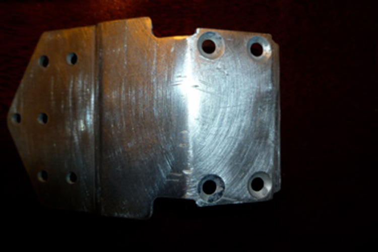

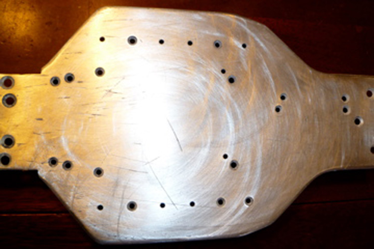

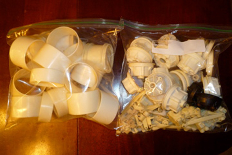

Re: RC10T box art restoration

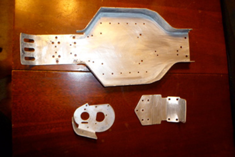

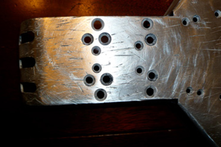

So I've been stripping and sanding the chassis parts the last few days and I have to admit, I'm not too happy with my progress. I first used oven cleaner to strip the anodizing, which worked pretty well, before sanding down the parts, which didn't work very well. The chassis has deeper scratches in it than I thought, and most of them are under the transmission. If I continue to sand until they're smooth, the rear of the chassis will be extremely thin. This chassis is for a shelf queen so it will not be run, but my plan was to re-anodize it, but with these scratches being so deep, I think powder coating is going to be the way to go. Plus, the few companies locally that I've contacted about anodizing are very expensive. One quote was $115. The lowest powder coating quote has been $35. My question is what, if anything, can I do to fill these scratches? Will it hold up to being baked at 400 degrees?

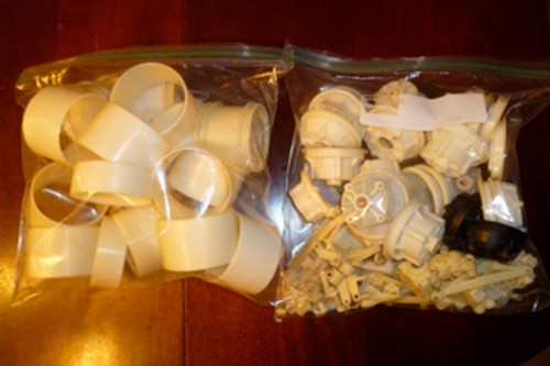

I've also gotten all of the white parts separated into two freezer bags ready for their peroxide bath and all of the tires cleaned up. Can someone post a picture of the box tire that came on the team truck? I understand that there may have been a few different tires provided. Also, what is the part # for the one piece wheels that were used? Thanks to everyone for their help with this project.
Wait till a new one pops up on Ebay. I bought a NIP chassis a couple years ago for what it would cost for you to powdercoat yours. If you want it done right just wait till the right stuff is available.
You can use JB weld as filler, Just don't use the 5 min stuff, It's useless for anything. Just make sure the podercoater doesn't blast the prepped area. It will take it right out.

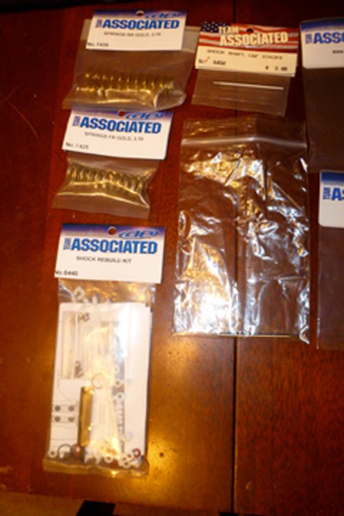

Update:

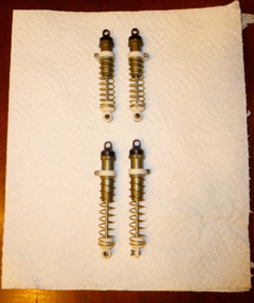

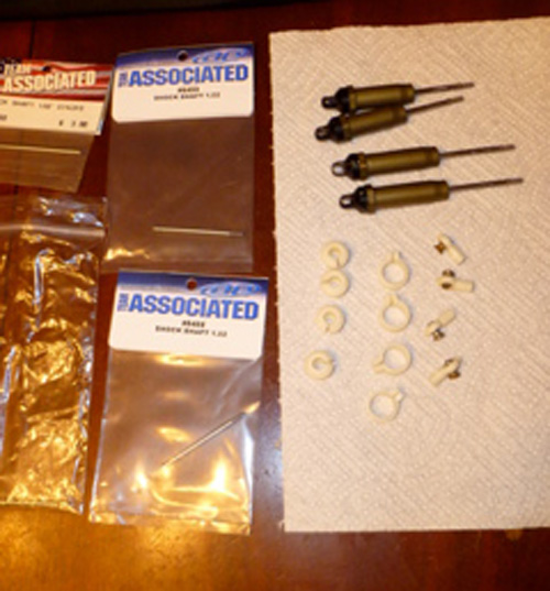

I finished up rebuilding the shocks today as well as getting most of the rear end mocked up. Here's a few pics of the shock rebuild.
I don't know if you guys have ever heard of Speedy its kinda like an aluminum brightner but will strip anodizing qiuicker than anything.

3) I found a few places locally that will powedercoat my chassis parts for cheap, but I'd really like to get it re-anodized. I've gotten some high quotes locally though. Can one of you guys lead me to a cheaper anodizer?
Best bet is try to get the local anodizer to throw yours in with another black batch. But IMO unless the chassis is like new, it's not worth reanodizing, at least powder coat or a paint on finish, the chassis can be filled and repairs before applying it.
